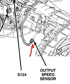

The output shaft speed sensor not the input
2001 DODGE RAM
233,471 MILES • 5.9L • V8 • 4WD • AUTOMATIC
DODGE BOY
Already swapped it but I don’t know if I swapped the right one because I still get the same code I really just need to know if the 01 dodge rams had just 1 or 2 trans vss

Output speed sensor location (automatic): driver’s side of the trans case. What is the code number you are getting? There is another VSS sensor on the rear of the transferase on the tail housing so when the truck is in 4wd. Here is the main VSS location. Check out the images (below). Please let us know what happens.
