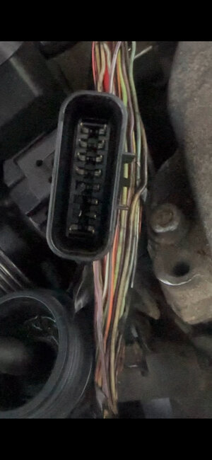

MERE
  • 17 POSTS
Would you happen to know what this plug is called? It’s a 16-pin right near the power steering pump.
Dec 8, 2024 at 8:09 PM
  • 54,520 POSTS
It must be a main engine wiring harness connector; can you tell me the colors of the wires so I can look them up? Thanks for the video, it helped.

Dec 9, 2024 at 8:57 AM
MERE
  • 17 POSTS
Here’s the back of the connector if this helps.
Dec 9, 2024 at 2:25 PM
  • 54,520 POSTS
Can you take a picture of the wires in the connector?

  • 54,520 POSTS
The connector does not matter just the wiring colors which I can see, please take still shots that don't move around.
Dec 11, 2024 at 9:54 AM
MERE
  • 17 POSTS
Yes, that’s what I was talking about what wire goes where.
