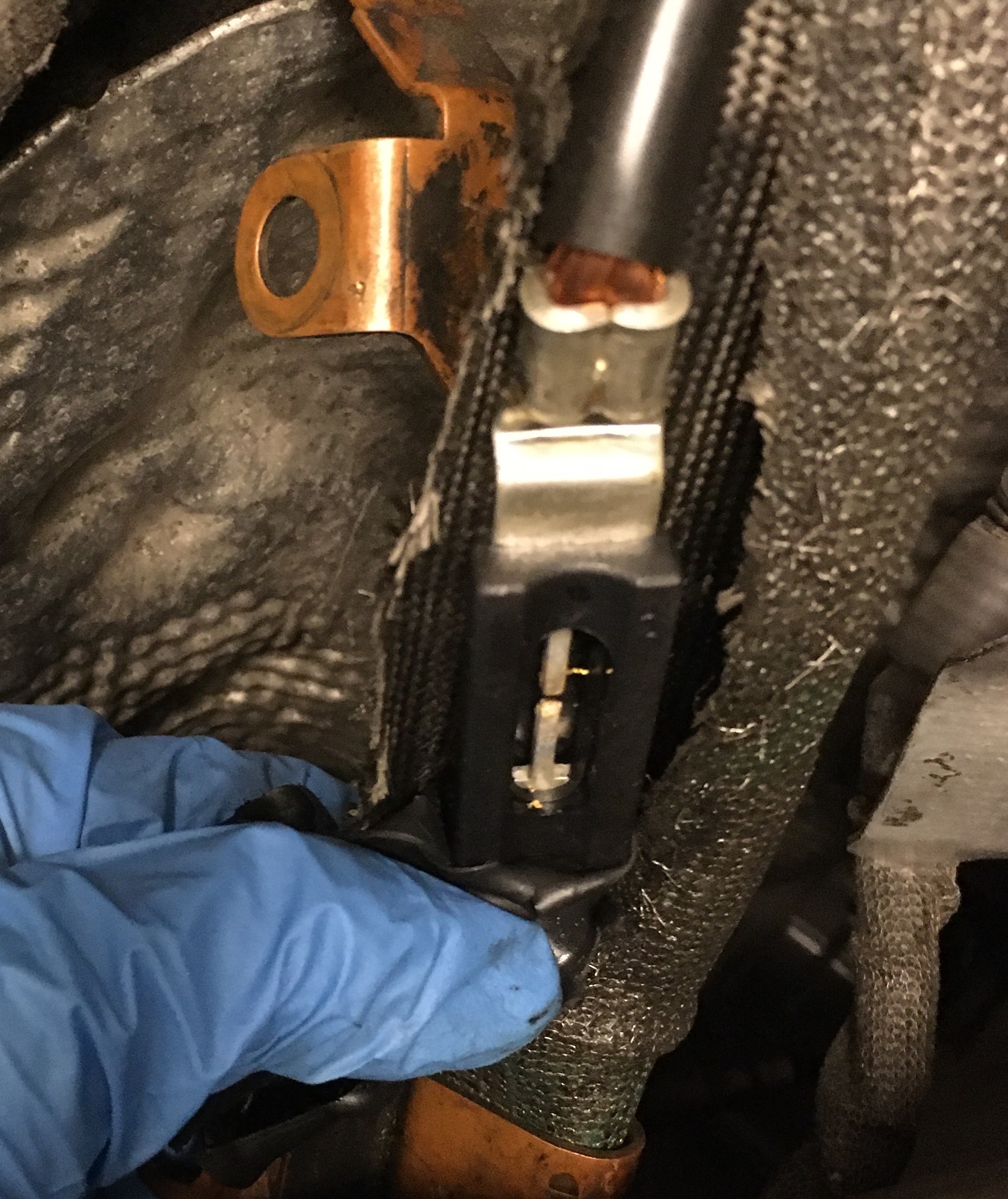

I received a tip on one of the Mercedes forums. There is a fusible link in the starter-alternator wiring loom. I used my test light to check the alternator terminal with the alternator disconnected. There was no power.
I am going to have the alternator tested again tomorrow. If the test shows it is good, I will be turning my focus to the fusible link. Unfortunately it is not in a readily accessible location. I will be studying starter removal procedures on the M271 engine for clues on removing the starter cable.

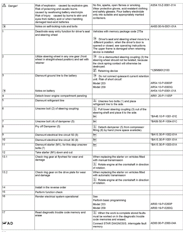

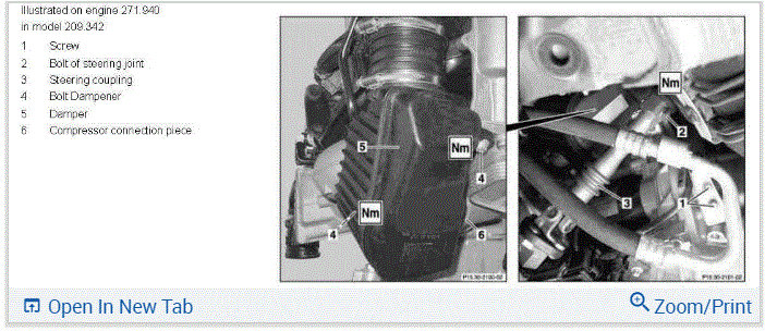

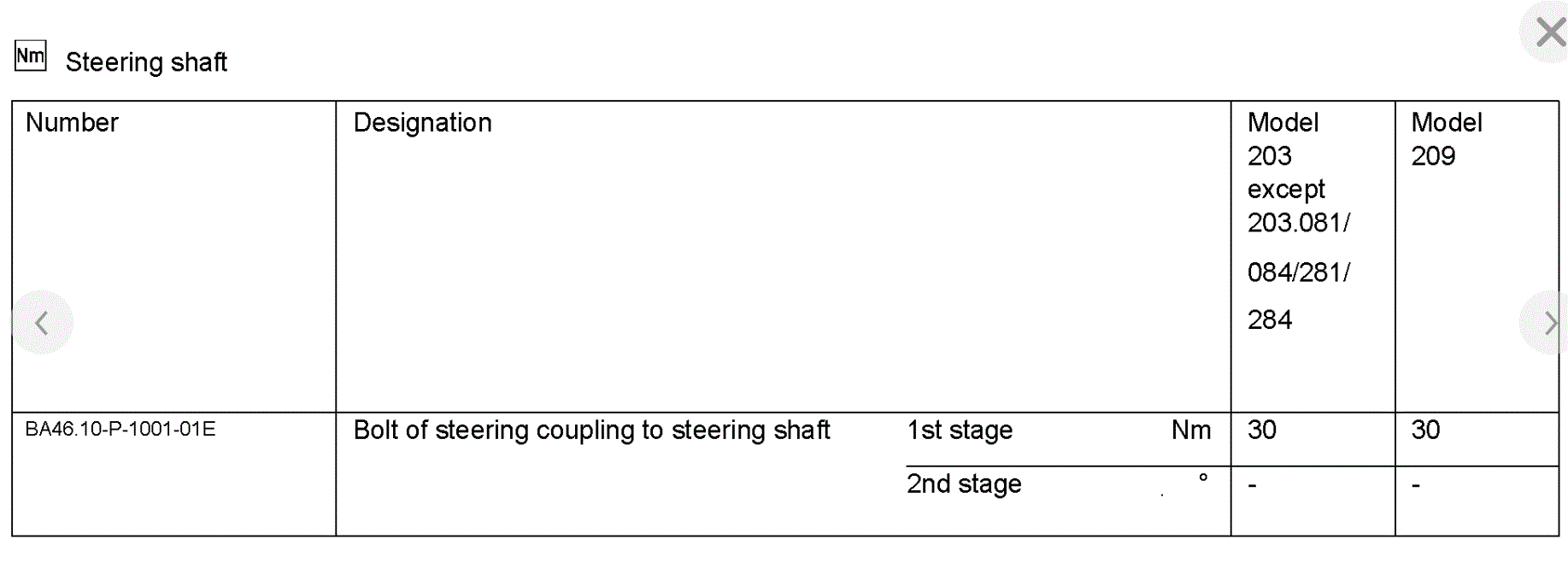

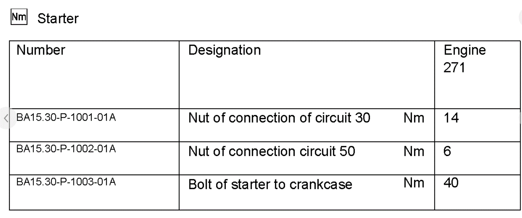

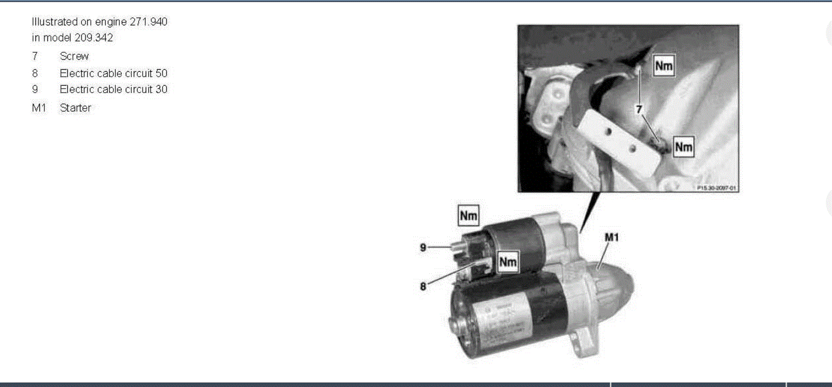

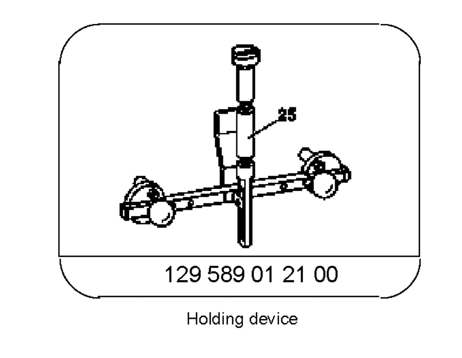

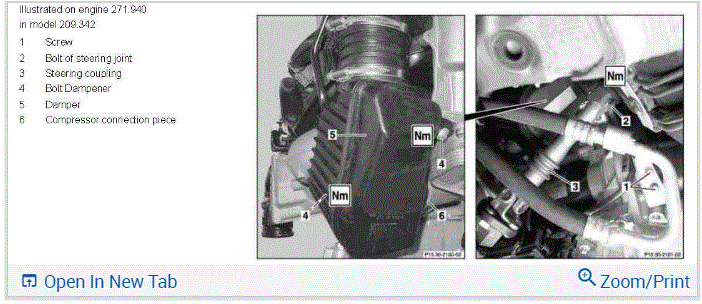

Here are the directions for starter removal and install. Actually, the attached pics include the directions.
___________________
2005 Mercedes Benz C 230 (203.040) L4-1.8L SC (271.948)
AR15.30-P-7100Q Remove Starter, Install
Vehicle Starting and Charging Starting System Starter Motor Service and Repair Removal and Replacement AR15.30-P-7100Q Remove Starter, Install
AR15.30-P-7100Q REMOVE STARTER, INSTALL
Remove starter, install
See attached pics

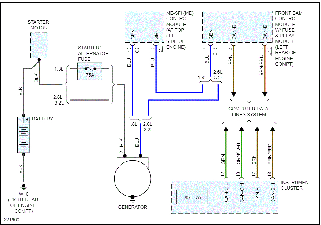

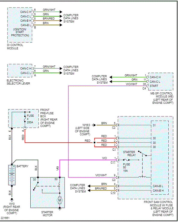

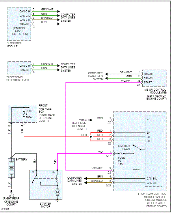

pic 10 is the charging system schematic. Pic 11 is the starting system schematic.

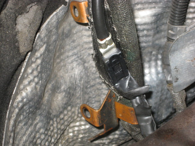

Thanks for the instructions. I would not have been able to remove the battery/starter/alternator cable without them.
Once I had the bolt off, I was able to pull it over the bell housing.� I had to open up the protective casing to access the 175-amp fusible link.� Then, I verified that the link had blown with my test light.� The battery side of the link had power. The other side did not.
Unfortunately, it does not appear that a replacement link can be swapped in.� I searched on the term "175-amp fusible link" and couldn't find anything that looked like the one in the car.� The fusible links that my search identified had different configurations.� It looks like the one Mercedes used was crimped on using a machine that could generate a significant amount of force.
I want the repair I make to be reliable. Although I can find 175 amp fusible links, they look different than the one in the car. (See photos.)
� If I use a fusible link like the one I can buy in an auto parts store, I need to find a way to install that won't allow it to come loose over time.� A better option may be to replace the entire cable with one from a recycling yard.� I have access to a C230 that I used to harvest replacement parts.� Unfortunately, it is sitting on flat tires in the owner's back yard.� To remove the bolt on the starter, I must get under the car and I cannot think of a safe way to do that.�
I found one on an auction site for a coupe, but the listing doesn't confirm that the cable will fit a sedan.� I may take a chance and buy it anyway.
I will appreciate any suggestions.

I looked more closely at the fusible link assembly.� There was a small cover that I could remove.� I have attached a photo of the fusible link. The photo verifies that the link is blown
Does anyone have any ideas about (1) how to replace the link and (2) where can I find the replacement 175-amp link?

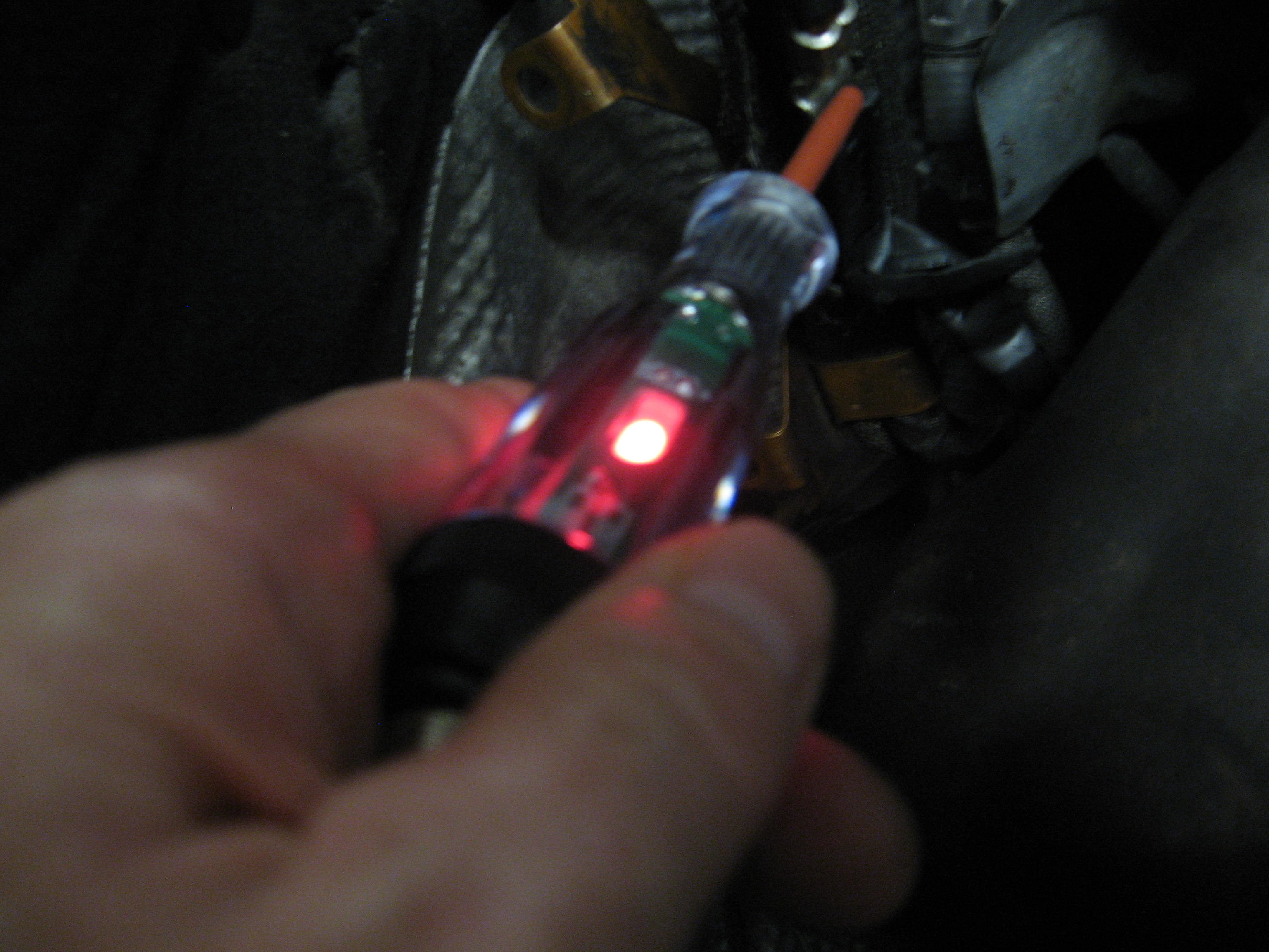

I may have had two problems and only solved one.
I installed the new battery/starter/alternator cable. (If anyone else ever needs to do this, the instructions Jacob and Nickolas posted are great.) There are also videos on YouTube. The cable has to fit between the starter and the engine block or the cable end will block the re-installation of the supercharger dampener. Look at the routing of the cable as you remove it, and you will see how to do it. It may be easier to route the cable if you remove the starter. I did not remove the starter because I couldn't remove one of the bolts holding it in place due to the size of the head of my ratchet. If I have to replace the starter, I will need to buy a ratchet with a more compact head or use a combination of a swivel and extensions to access it. I saw some people claim that they did not need to remove the supercharger dampener to access the bolt holding the cable on the end of the starter. I don't see how they did that. In addition to the dampener, I had to disconnect the steering linkage and move a refrigerant line.
To make a long story short, I now have power to the alternator. Unfortunately, I still have the alternator-battery warning light. When I display the voltage on the center information screen with the car running it shows 12.1 volts instead of the 14-14.2 volts it would display before I damaged the system.
When I connect the STAR tool, it displays the same fault code as it did before I replaced the cable - 2062-02-Alternator Serial Interface - No connection to the control module. As noted in previous posts, the data line to the ECU has continuity. However, I have not used an oscilloscope (as someone on another forum suggested) to read the data.
I had previously had the alternator tested at a rebuild shop on a somewhat primitive looking machine. The technician gave it a passing grade. I replaced the voltage regulator on it because the brushes were worn. I had it retested at an Advance Auto and they said it failed. The Advance Auto test machine is capable of printing out data, but the technician didn't know how to do it. He did tell me the voltage regulator was okay.
It looks like my next step may be to replace the alternator with a rebuilt unit. Before I spend $200.00 throwing another part at the car, does anyone have other suggestions? I think my second option would be to follow the advice I received on another forum and either obtain an oscilloscope to read the data or find someone who has the equipment and can do it for me.

The only thing I have is what is related to the code that you found originally. Here is what is listed:
__________________________________
Test 1: Alternator Output Too Low Fault Code 2062 [2]
Vehicle ALL Diagnostic Trouble Codes ( DTC ) Testing and Inspection Manufacturer Code Charts Powertrain Management Code Tests 2062 [2] Alternator Serial Interface: No Connection to Control Module N3/10 (ME-SFI Control Module) Test 1: Alternator Output Too Low Fault Code 2062 [2]
TEST 1: ALTERNATOR OUTPUT TOO LOW FAULT CODE 2062 [2]
Alternator output too low Fault code 2062 [2]
Possible cause and remedy
- Check electrical line between component N3/10 (ME-SFI control module) and component Generator for contact and routing and (or) line breaks.
- Check alternator regulator with oscilloscope.

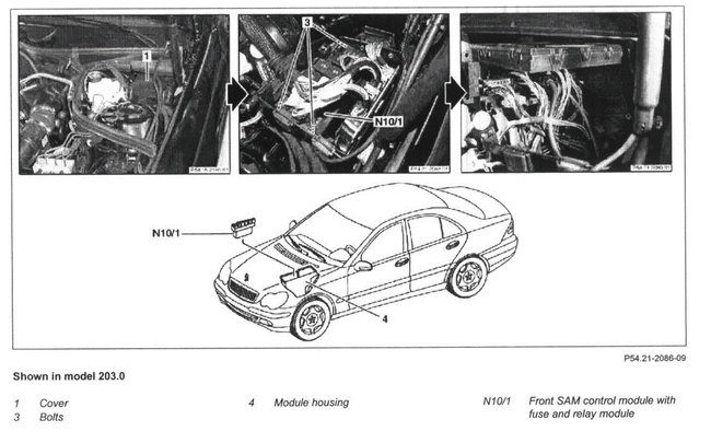

Switch the two sam modules and let me know what happens.

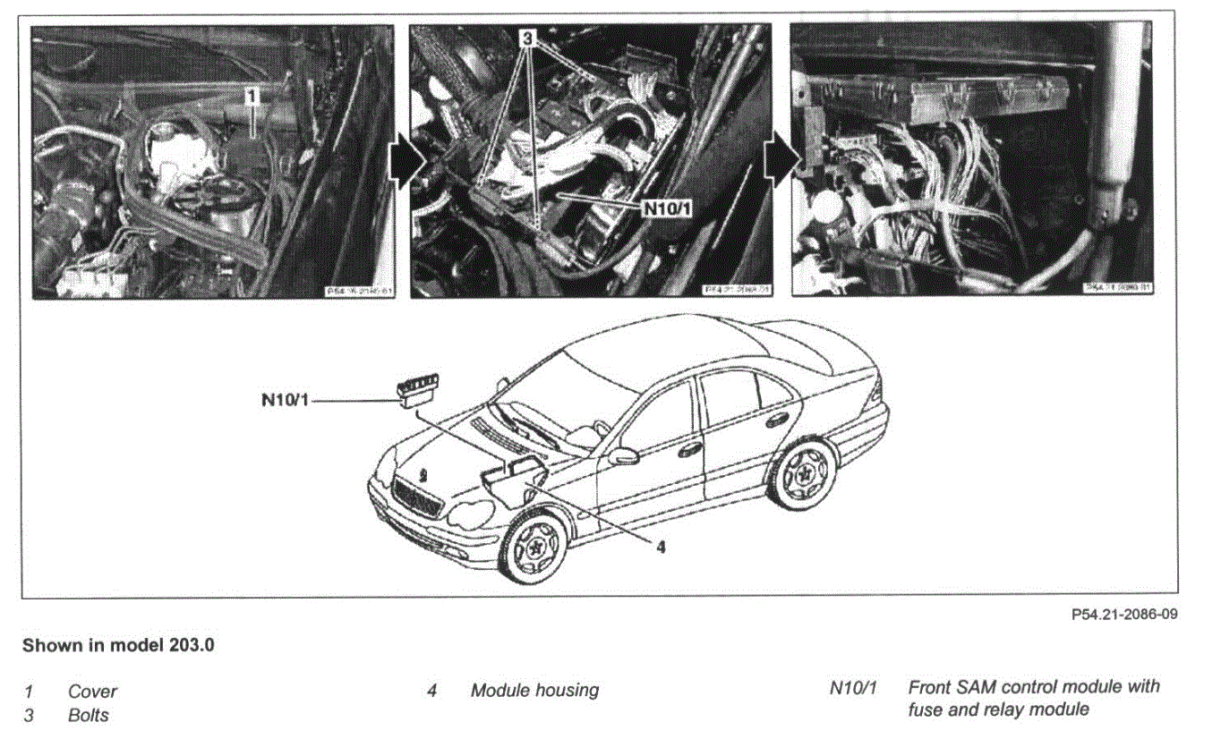

I don't know if you need it, but here are the directions for removal and replacement of the front SAM module.
____________________________________
AR54.21-P-1260P Remove/Install SAM With Fuse and Relay Box, Left Front
Vehicle Powertrain Management Relays and Modules - Powertrain Management Relays and Modules - Computers and Control Systems Body Control Module Service and Repair Removal and Replacement AR54.21-P-1260P Remove/Install SAM With Fuse and Relay Box, Left Front
AR54.21-P-1260P REMOVE/INSTALL SAM WITH FUSE AND RELAY BOX, LEFT FRONT
Shown In Model 203.0
Pic 1
DANGER:
- Risk of injury in the form of trapping or crushing, or even severing of limbs, if caught in windshield wiper mechanism
- Always remove ignition key when working on windshield wiper mechanism.
1 Set wiper arms to vertical position
DANGER:
- Risk of explosion from explosive gas. Risk of poisoning and caustic burns from swallowing battery electrolyte. Risk of injury through burns to skin and eyes from battery acid or when handling damaged lead-acid batteries
- No fire, sparks, naked flames or smoking.
- Wear protective gloves, acid-resistant clothing and safety glasses. Pour battery electrolyte only into suitable and appropriately marked containers
2 Disconnect ground cable of battery
CAUTION: Do not connect quiescent current retention unit due to risk of short-circuit.
3 Unlock and remove cover (1) on module housing (4)
NOTE: Installation: Check gasket for damage
4.1Remove injection system control module
4.2Remove front SAM control module with fuse and relay module (N10/1) from guide.
5 Unscrew bolts (3)
6 Release and remove connectors
NOTE:
- At top on front SAM control module with fuse and relay module (N10/1)
- Removal: Disconnect cables from control module and fuse and relay box
- Installation: Connect cables on control module and fuse and relay box
7 Expose wiring harness.
8 Remove front SAM control module with fuse and relay module (N10/1) upwards.
NOTE: Pull out only until connectors are accessible from below.
9 Release and remove connectors
NOTE:
10 Remove front SAM control module with fuse and relay module (N10/1).
NOTE: When replacing, the fuse and relay assignment must be inspected.
11 Install in the reverse order
12 Perform basic programming
13 Read diagnostic trouble code memory and erase
14 Check for proper function
_______________________________________
