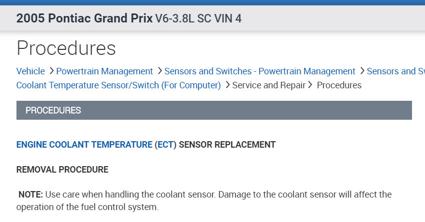

My car will shut off immediately after you start it, but starts right up on the second try. It doesn't do this every time but does it often. It started about a month ago and did it occasionally, now more frequent. It also heats up halfway at idle, not sure if that has anything to do with it. When I had the check engine light scanned it said ect sensor.
Tuesday, May 21st, 2019 AT 11:33 AM
SCGRANTURISMO
  • 4,897 POSTS

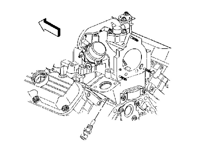

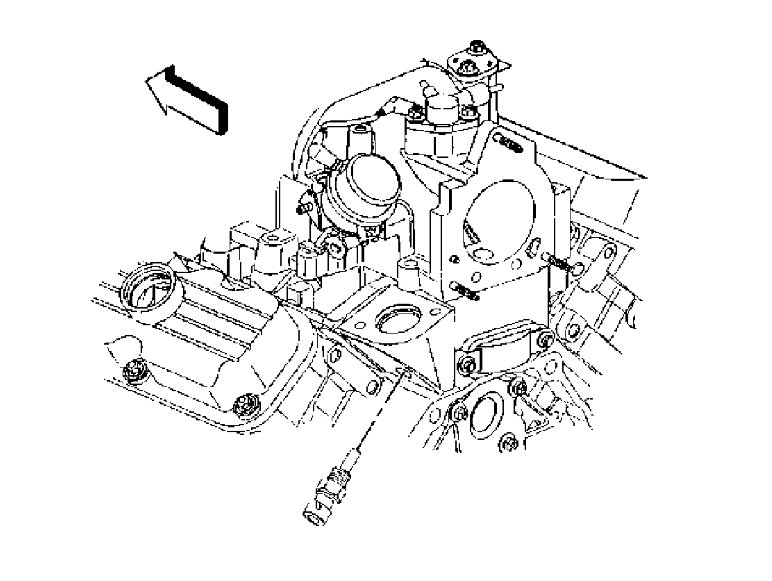

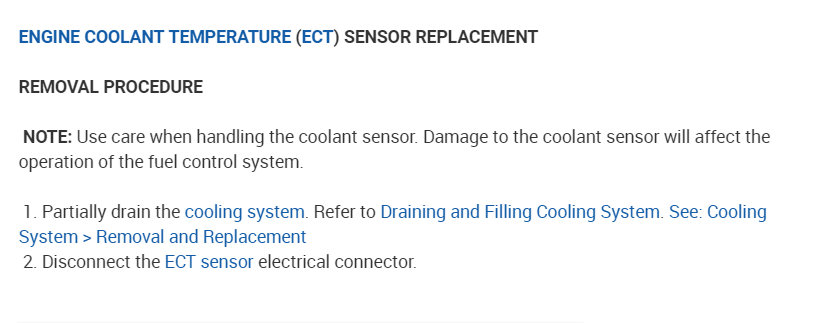

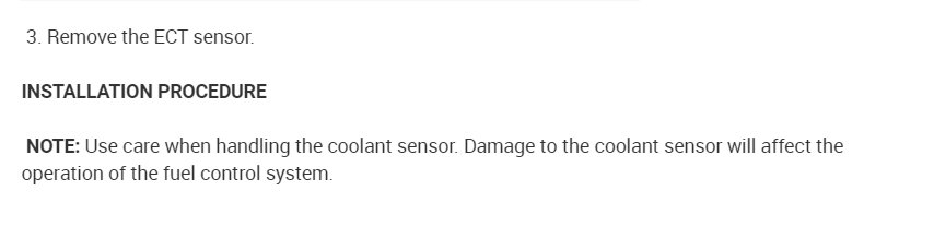

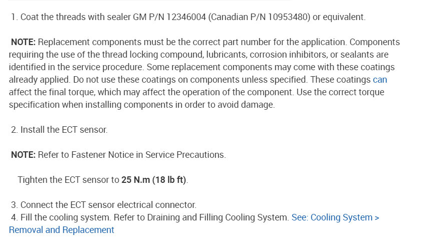

Okay, I have included the information on how to remove and replace your vehicle's Engine Coolant Temperature Sensor (ECT) in the diagrams down below. Please go through the guide and get back to us with what you are able to find out.
