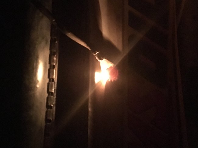

I fixed it. Sorry for the very late response. It ended up being a ground wire. The bolt that holds it down was broken in half and was arcing cause (causing high resistance) the guage to be irratic. Replaced the bolt and the problem went away.
