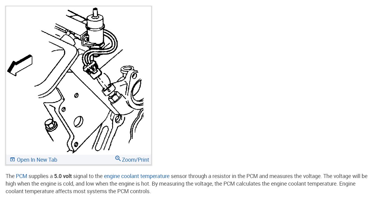

My temperature gauge quit working is this a blown fuse or a sensor? Low coolant light stays on even though it is not low on coolant. The one time it got hot the red light came on even though gauge was just just jumping around jumping bean at the time before it just stopped completely.

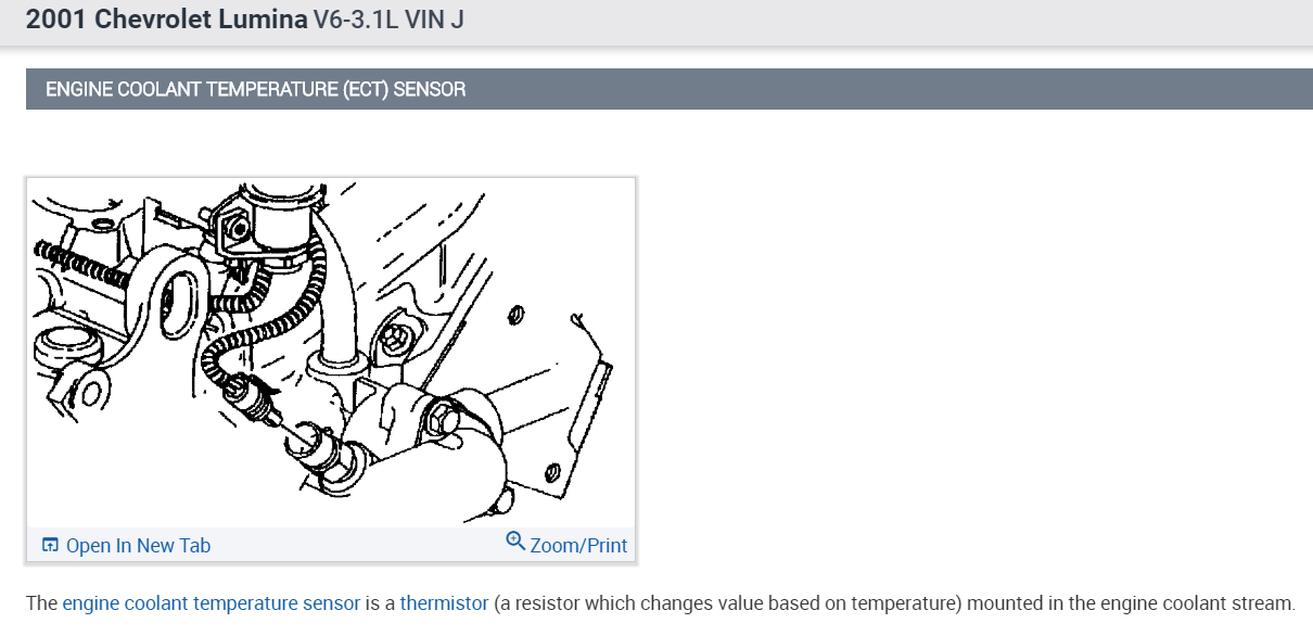

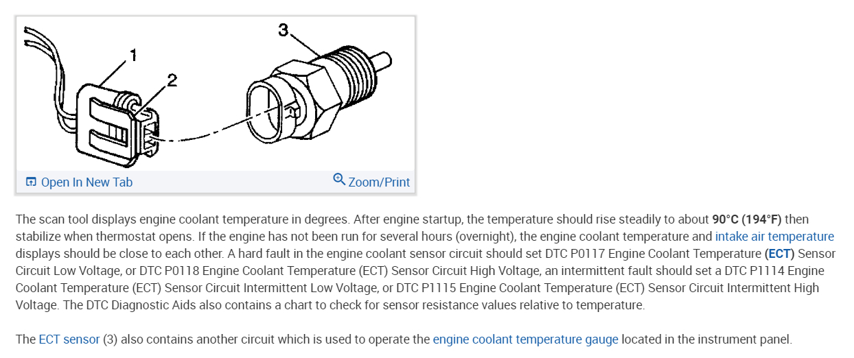

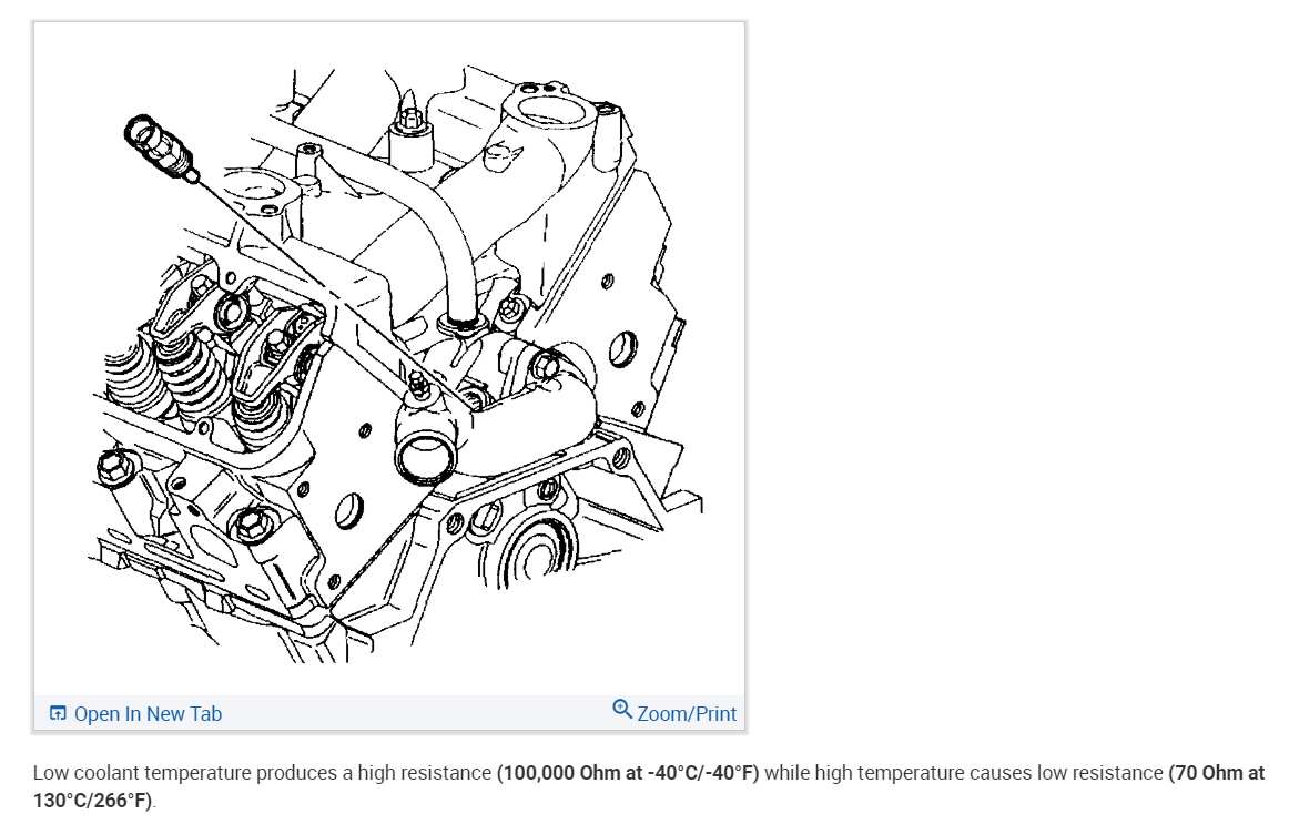

The coolant level sensor is bad located in the coolant reservoir here is a guide to help you replace it.
https://www.2carpros.com/articles/coolant-reservoir-replacement
It also sound like the engine coolant temperature sensor has gone bad which this guide will walk you through with diagrams below to show you on your car.
https://www.2carpros.com/articles/coolant-temperature-sensor-cts-replacement
Check out the diagrams (Below). Please let us know what happens. If this doesn't fix it I would replace the dash cluster

First make sure there isn't a lot of corrosion around the sensor where it threads into the block. I've seen times where this will prevent a good ground. Also double check the wires. Because if they burned in one spot, they could've burned in a spot you didn't see. Also, the fan won't come on because the temp switch isn't keeping the computer informed.

Hello, the sensor should be, driverside, high-up on the backside of block. Look for a green wire, it should go to the connector. The sensor is a ground for the gage, you can take the connector loose, use a jumper ground, turn the key on. I don't like to peg an analog gage, have a helper watch the needle. If it doesn't move, there may be something wrong with the gage on the dash.
