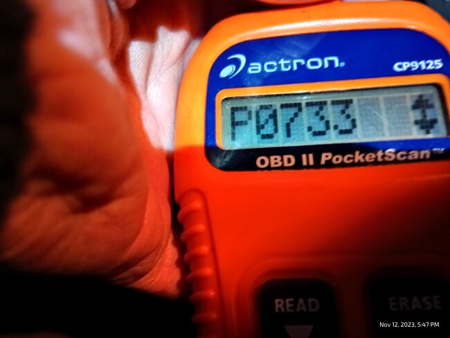

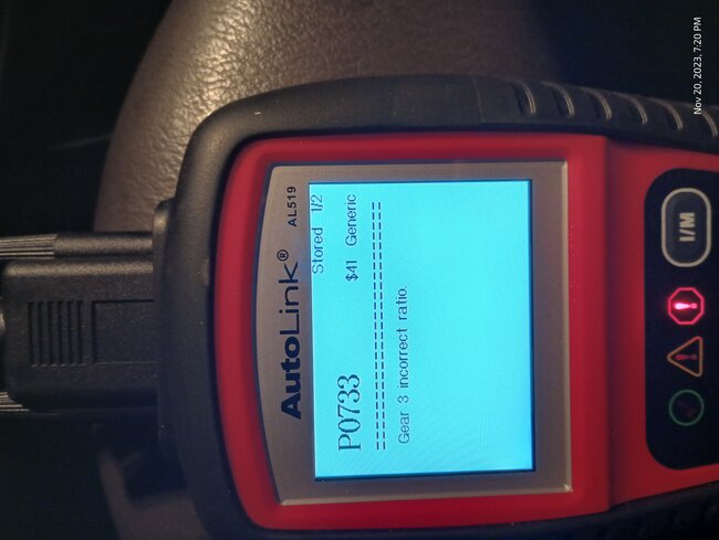

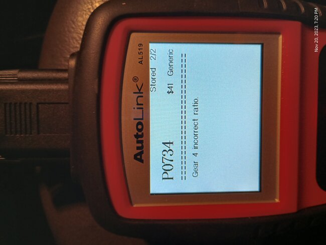

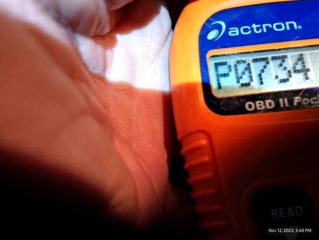

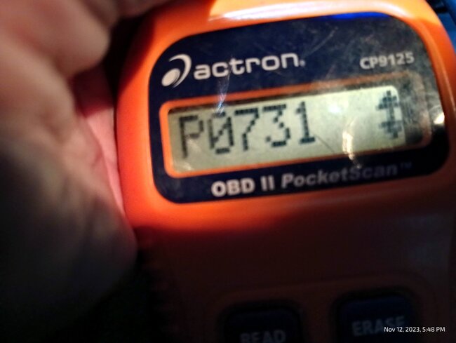

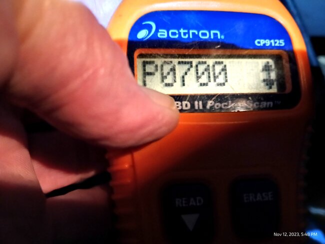

Just had a used transmission installed because of a blow out of one of the cooler lines losing nearly half the ATF +4. The shift solenoid pack is brand new direct from BorgWarner as are the Speed Sensors (from AutoZone). This transmission only has 90,000 miles on it.
Symptoms-
Showing signs of slipping, hard shifts, erratic behavior that prior to the blow out of fluids never had happened before. Keep getting P0733 and P0734 DTC codes telling me that the errors in shifting in gears 3 and 4. Funny thing is it was getting those same codes with the original shift solenoid on the transmission when it arrived at the shop. I had to drive it home with that shift solenoid pack because the new one had not arrived yet.
