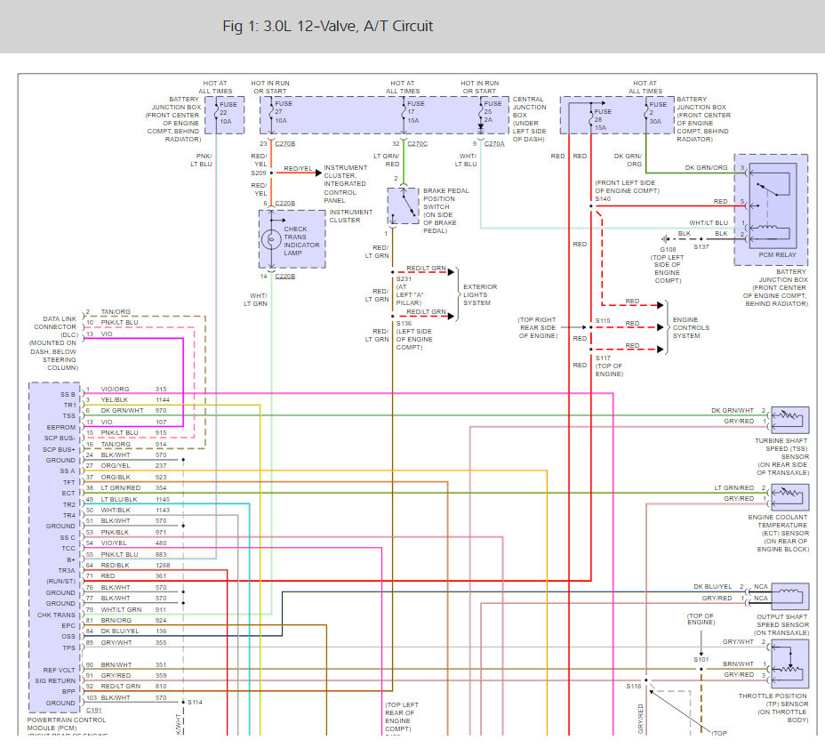

How do I locate and change the TCC solenoid on the Mercury Sable?

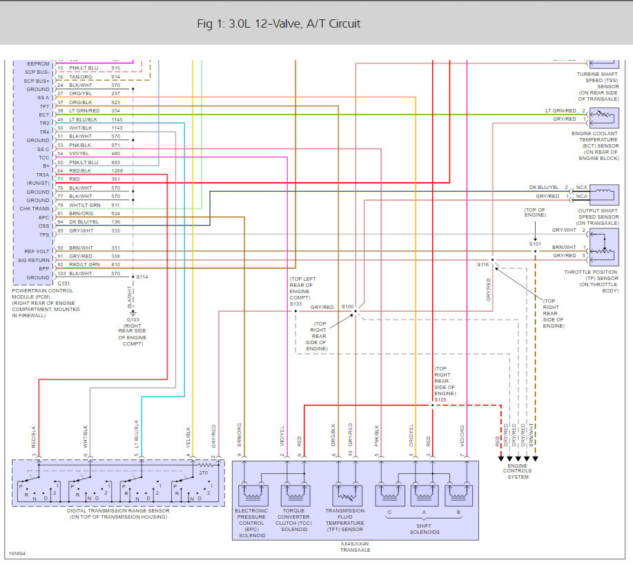

The TCC solenoid is located in the pan and it will have a vio/yellow and a red wire going to it.
Double check from the wiring diagram (below)
Here is a guide that will show you how to drop the pan.

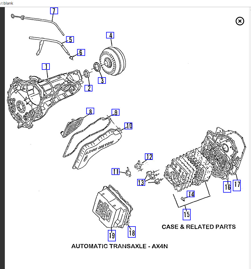

I already drop the pan and there is no wires or solenoid

Sorry, its under the side case. Here is a diagram (below)

Do I have to have a jack under the transmission in order to remove to mount bracket to get to the side panel.

Yes a jack is needs to support the transmission, can you take some pics of the job being done and post them?
