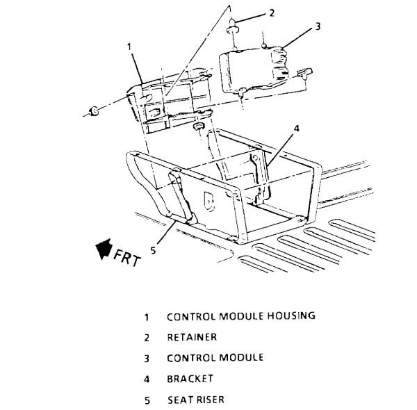

Wednesday, May 22nd, 2019 AT 12:59 AM
The ECM needs to be replaced. It is the whole unit.
Wednesday, May 22nd, 2019 AT 2:59 AM

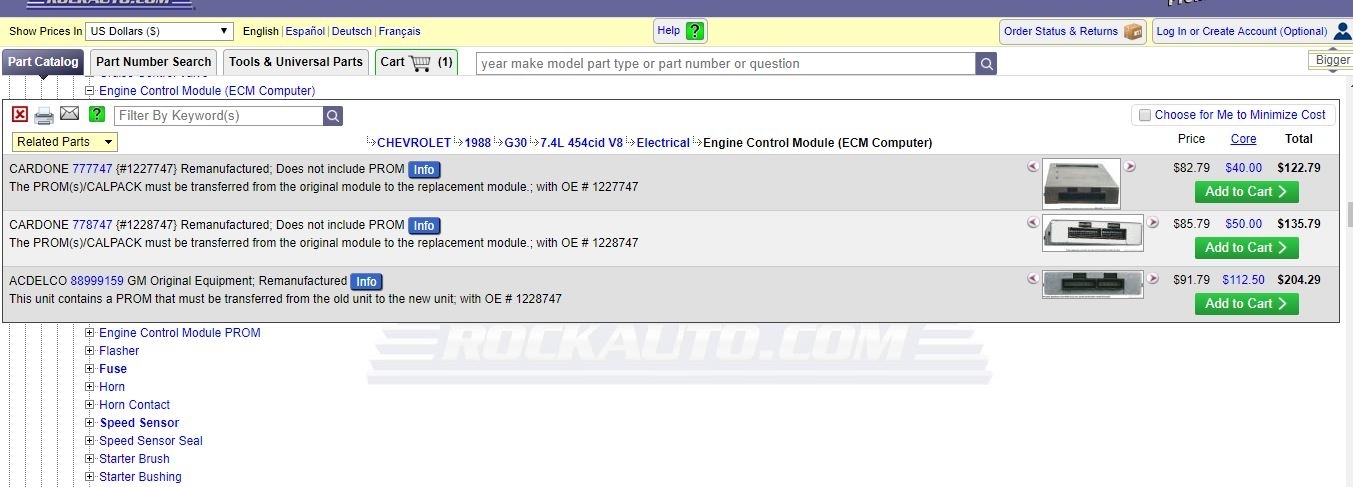

PHILL WATERS
  • 7 POSTS
Okay, have ordered new ECM, but it will take about 10 to 15 days to reach me. Will let you know how it goes, thanks for all your help.
