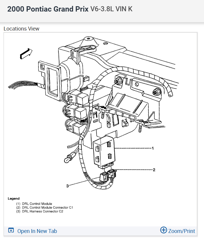

Taillights won't cut off.
Tuesday, April 1st, 2025 AT 5:54 PM
KEN L
MASTER CERTIFIED MECHANIC
55,440 POSTS
Hi Kathy,
This happens when the DRL control module sticks on, here is the location so you can swap it out it help fix the problem. Check out the images (below). Let us know if you need anything else.
