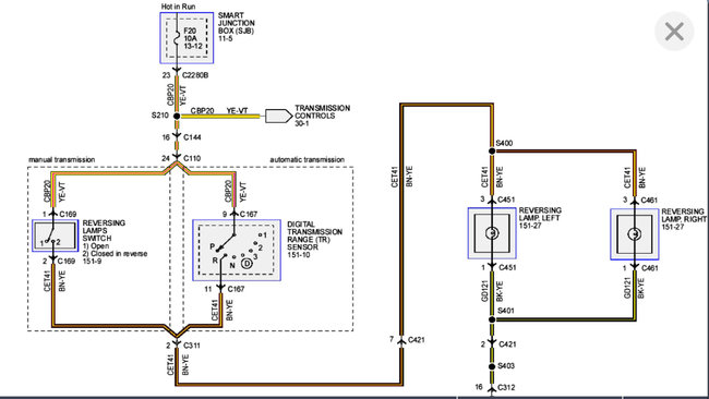

What should I check, fuse, sensor? Where are these located?
Monday, September 3rd, 2018 AT 5:25 AM
20 Replies
Good morning.
I attached a wire diagram for you to view.
There is a fuse in the smart junction block. Fuse number 20, a 10 amp fuse, should feed the circuit. It is hot with the key on. Use a test light to verify power on both sides of the fuse.

Reverse lights do not work. Checked fuse and bulbs both okay. I have checked voltage at the bulbs connectors and have get twelve volts when reverse is selected but the bulbs still do not work. I am baffled, can anyone help?

Leave the bulbs in their sockets, then check for voltage on both terminals. If the twelve volts is gone, I will explain why a test light would be more accurate than a voltmeter. If you find twelve volts on both terminals, the ground circuit is open. Look for a cut wire, rusted ground connection on the body, or the ground wire is corroded off the socket.

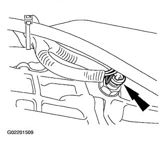

Where is the backup light switch located in my 2001 Ranger. My backup lights work intermittently I want to change it but I need to find it.
Wednesday, June 2nd, 2021 AT 1:26 PM (Merged)
MHPAUTOS
  • 31,937 POSTS
Hi there,
It is on the top left side of the transmission.

I have checked the bulbs and the fuse but the backup lights just dont work.
FLEXY5
  • 512 POSTS
Check the reverse position switch on the side of the trans. It's on the driver side to the rear. It should be the smaller of the two sensors. The other is the Neutral safety switch.
