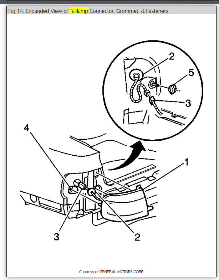

I cannot get the panel off to change the bulb on the tail lights.

You must access the bolts from inside the trunk. Here is a guide and a diagram (below) so you can get the job done:
https://www.2carpros.com/articles/no-tail-lights-exterior-running-lights-tail-lights-out
and
https://www.2carpros.com/articles/brake-lights-not-working
