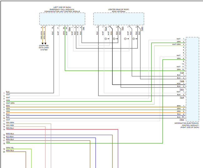

Hi, I'm currently searching for a wiring diagram for a 2023 VW T Cross. I came across the Jetta Beats wiring diagram, but not all the colors match. Any help is appreciated.
Cheers From Australia
Nov 20, 2024 at 12:35 AM
  • 54,520 POSTS

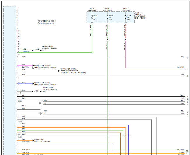

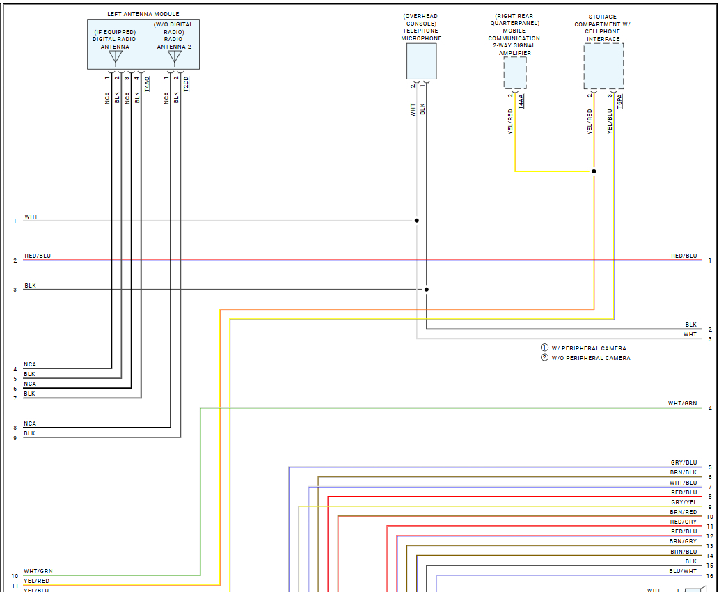

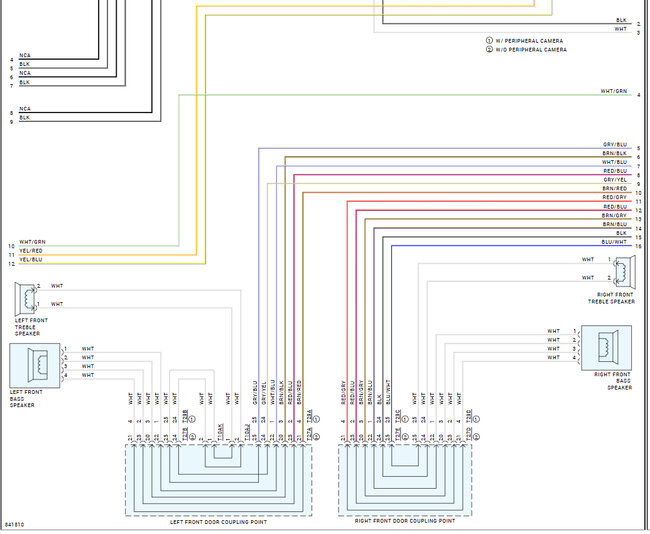

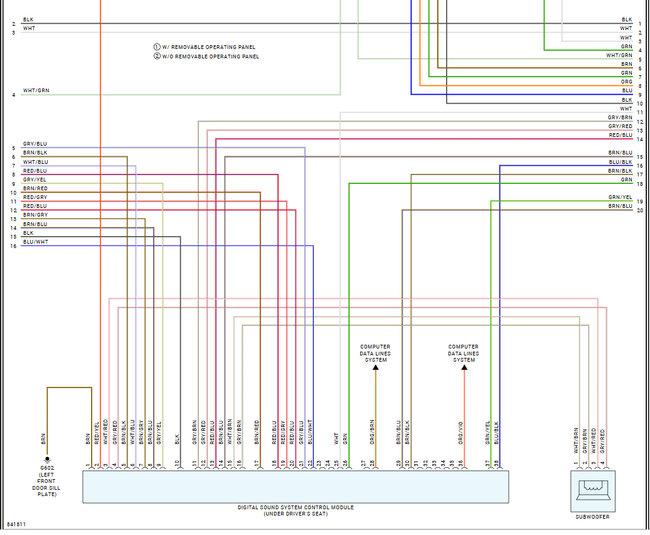

Cheers from the US! Here are the wiring diagrams for the sounds system with the amplifier for your car. Check out the images (below). Let us know if you need anything else.
