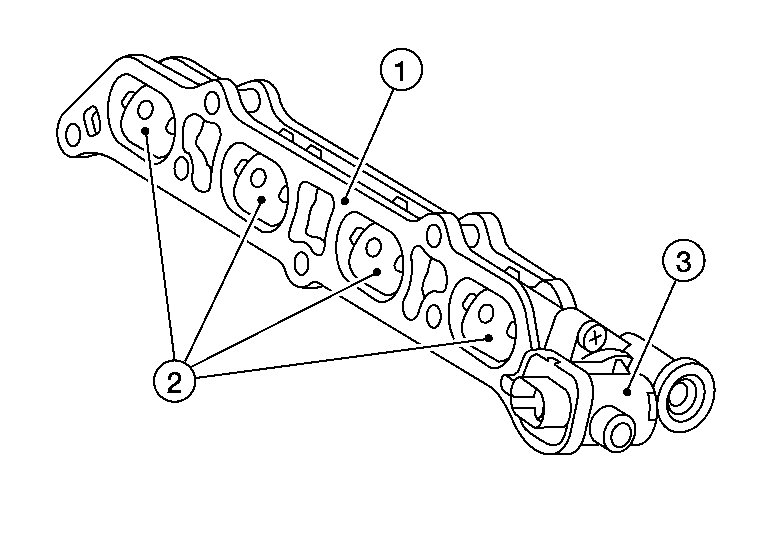

Where can I find the swirl control valve and tumble control valve on the car listed above? Getting code p2004 and p20014. Looked but do not know were they are located.

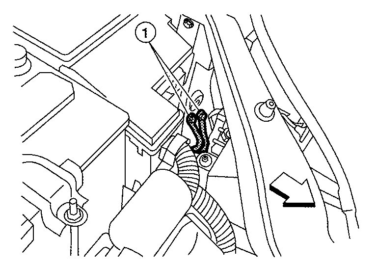

The swirl valve is mounted in the intake manifold adapter. The actuator is at the end of the adapter. See picture 1. Number 3 is the actuator, number 2 is the is the control valve, and three is the adapter. Often times, the ground fails, so check that first. Picture 2 shows the ground location.
I attached a picture to help you locate it. Loosen it, clean, and re-tighten it.
Let me know if this helps.
