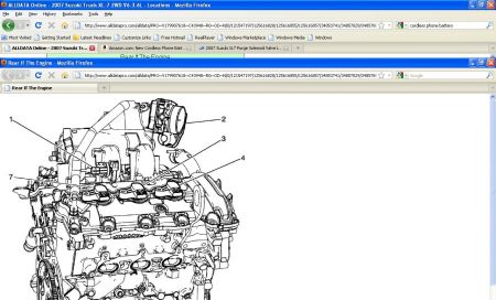

Where is the purge solenoid valve located?

First of all thank you so much for your donation. If your talking about the canister purge solenoid it is located on the back side of the engine call out number 1 in the diagram i posted.

Thanks for your reply saturntech9. Yes, I am referring to the canister purge vale. We are talking about the 3.6L, right? And by rear of the engine you mean the transmission side? Well, I do not see it where indicated in the diagram. It would have to be under the intake manifold if it is there.
Should it be easily accessible? The diagram actually looks somewhat different than what I see on my vehicle. Is the diagram specific to my vehicle? I understand my vehicle is the same as a Chevrolet Equinox if that helps narrow it down any.
Any further help is appreciated.
Thanks.

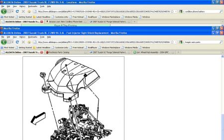

https://www.2carpros.com/forum/automotive_pictures/416332_2007_suzuki_fuel_injector_sight_shield_1.jpg

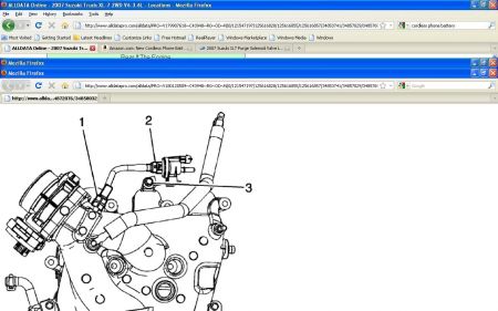

https://www.2carpros.com/forum/automotive_pictures/416332_2007_suzuki_canister_purge_diagram_1.jpg
Yes i have the correct information and it goes to your car. Remove the engine cover i posted a diagram for look at the posted diagram you will see your throttle body and a hose by it that hose lead's to your canister purge solenoid as you can see in the diagram. It is on the opposite side of where you fill your oil.

After my first reply, I finally got oriented and found it. Not the setup up or look I expected. I had what I thought was the replacement GM part which looked totally different. Any ideas on a replacement cheaper than the $150.00 the dealer wants?
