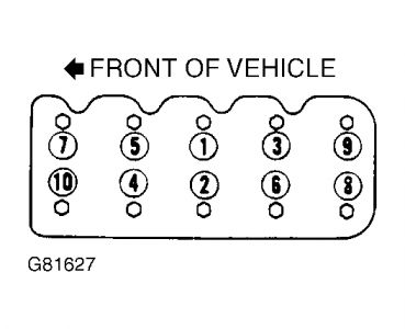

1989 1.6 engine head bolt tightening sequence and tourque spec's
Thursday, August 26th, 2010 AT 11:12 AM
BLUELIGHTNIN6
MECHANIC
16,542 POSTS
Use sequence below.. tighten to 48 - 51 Ft. Lbs. if DOHC or 51 - 54 Ft. Lbs. for SOHC
