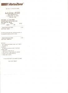

I have a 2000 Suzuki Esteem that has a check engine light that stays on. Is it possible to replace only one of the O2 sensors and eliminate the check engine light or would it be more effective to replace both at the same time ? It gets horrible gas mileage and runs rough.

depends what code is showing up, the first one is only used for engine performance, the second one is catalytic converter efficiency.
what code is the check engine light storing?

GATEKEEPER37
the code is P0440
https://images.2carpros.com/forum/automotive_pictures/177730_New_Image_4.jpg

P0440 is evaporative Emission Control System Malfunction
nothing to do with o2 sensors.
causes include
The gas cap is bad or not tightened properly
The purge solenoid is faulty
The canister is plugged or not working properly
