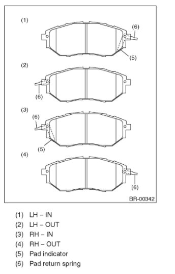

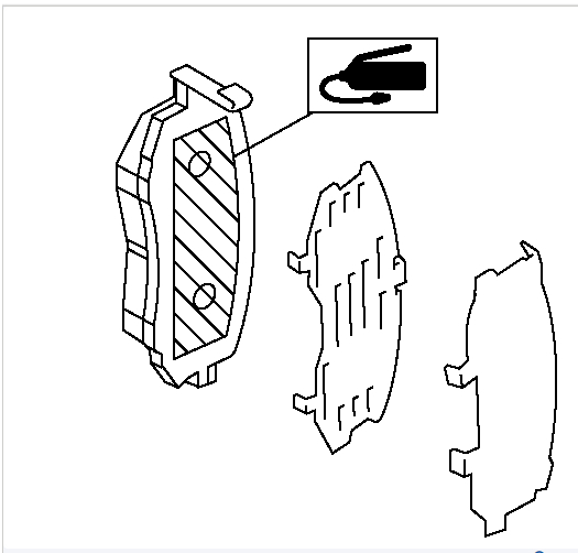

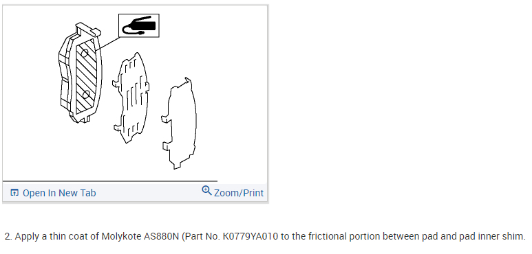

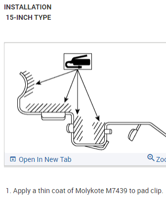

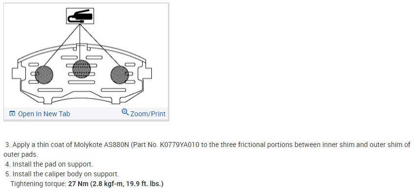

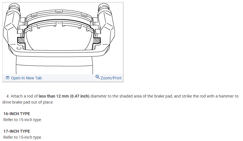

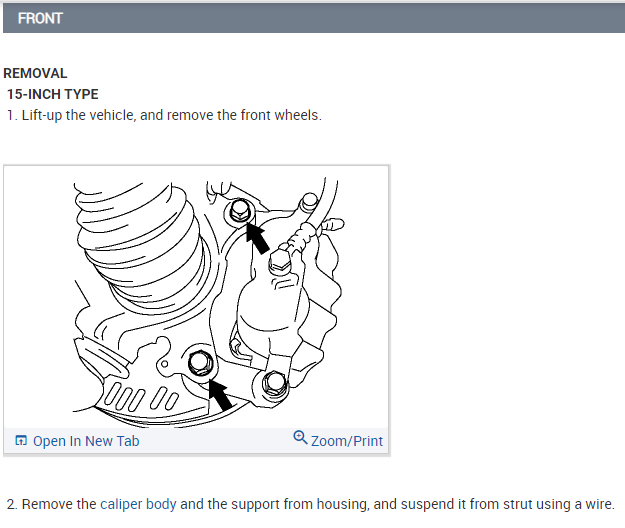

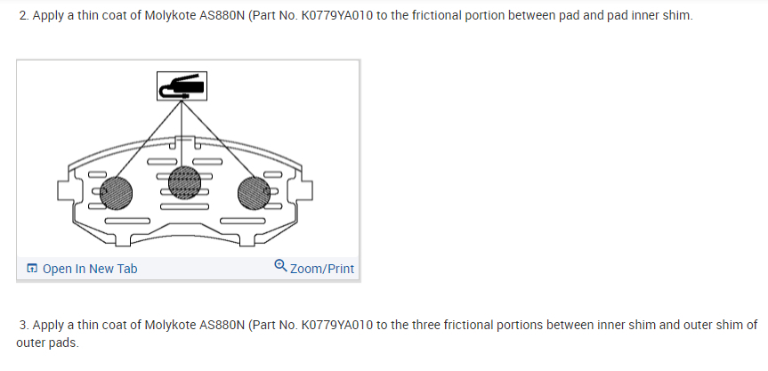

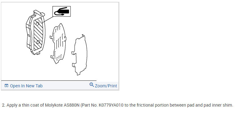

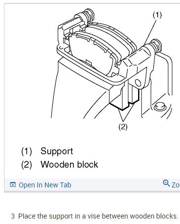

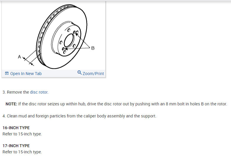

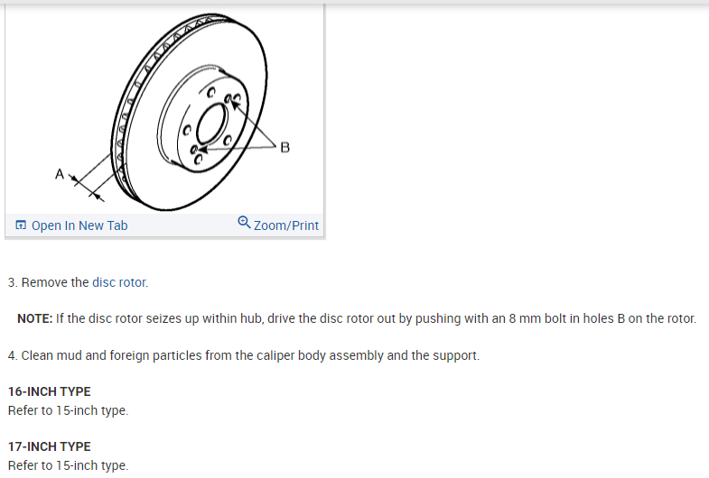

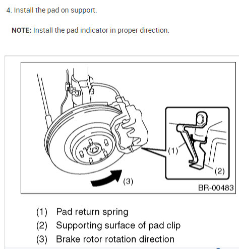

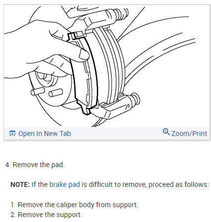

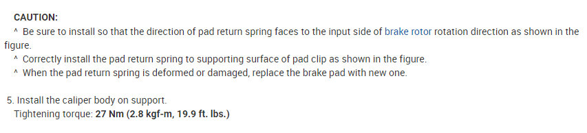

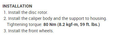

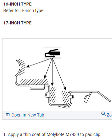

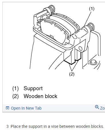

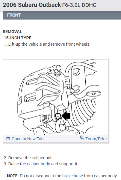

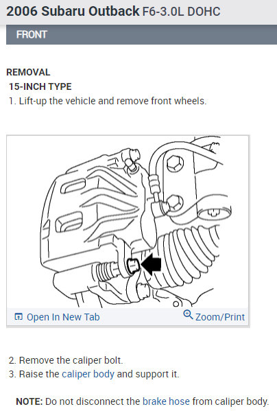

Hello, I was wanting to save some money by doing my own brakes can you help me?
Sunday, March 27th, 2016 AT 3:45 PM
DANNY L
MECHANIC
5,648 POSTS
Hello, I'm Danny.

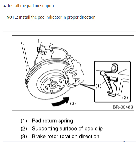

Here is the information you requested. This is a tutorial showing what is involved on how to change front brake pads and brake rotors:
I've attached picture steps below on how to change the front brake pads and rotors on your vehicle. Hope this helps and thanks for using 2CarPros.
