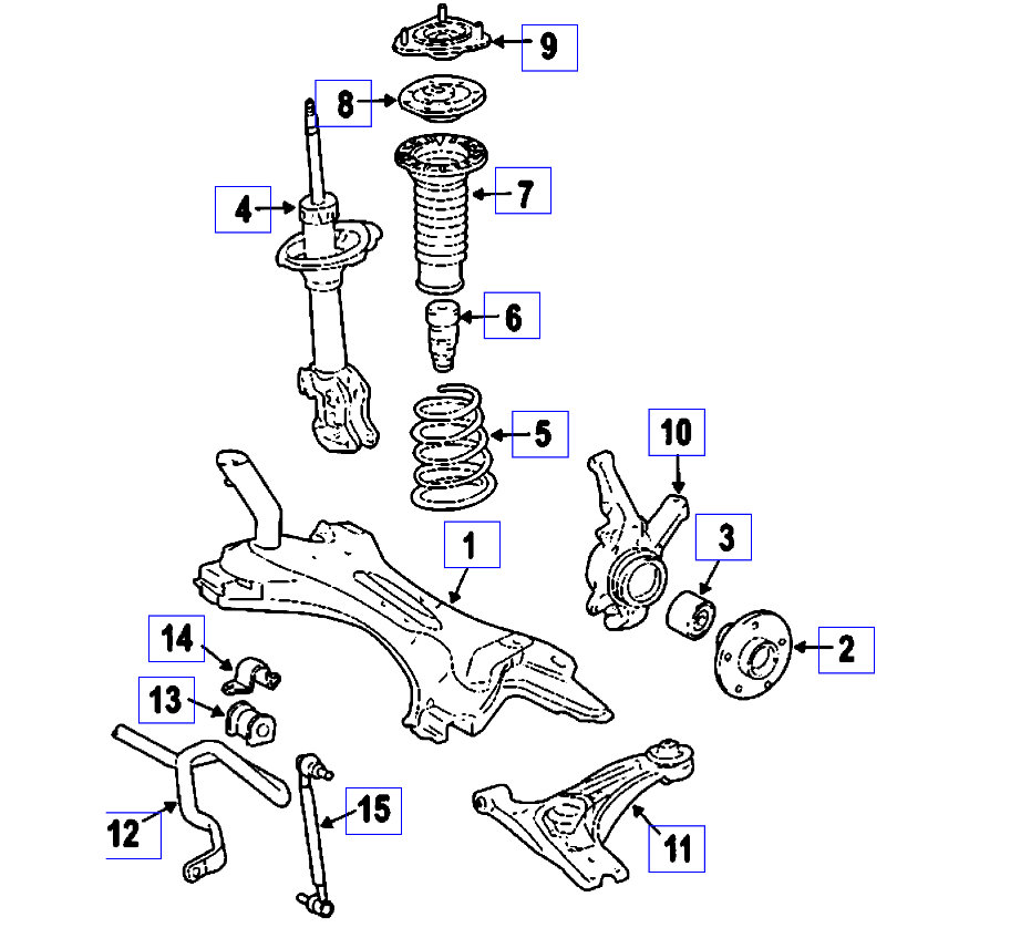

Most of the time after struts and sway bar links you have lower ball joint or sway bar to body mounts, also when you did the struts did you do the strut mounts? (Entire strut) use a flashlight to inspect # 13, 11 and #9 lower control arm bushings in the diagrams below. Can you please shoot a quick video with your phone so I can hear the noise? That way I can tell for sure what's going on. You can upload it here with your response.

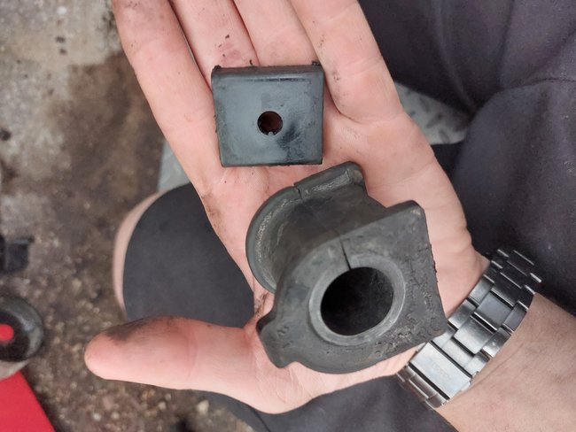

RTSTROCK30
  • 12 POSTS
I found this sitting on top of my frame basically by my sway bar mount. Any idea what it goes to?
Aug 31, 2022 at 3:57 PM

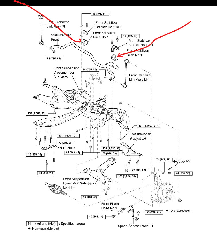

  • 54,128 POSTS
Thanks for the pics and videos. The part you found looks like the sway bar mount bushing which will definitely cause the noise. Here is how you can replace it in the images below. Check out the diagrams (below). Please let us know what you find.

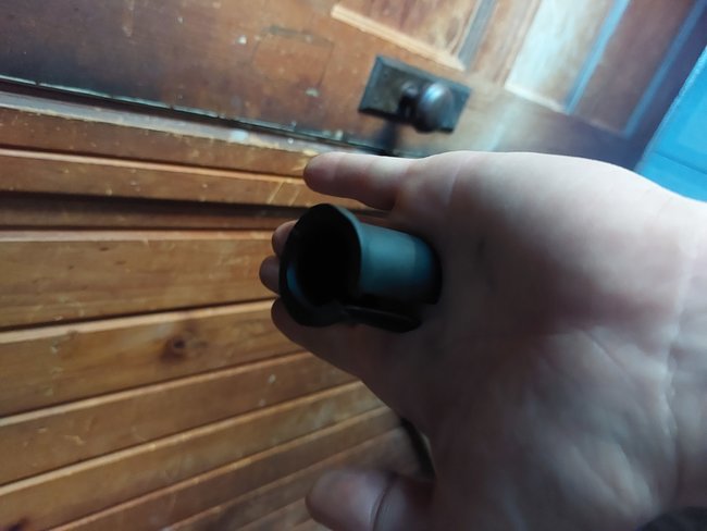

RTSTROCK30
  • 12 POSTS
It really doesn't look like there's anything wrong with either side unless that's not supposed to come off the bottom?
Sep 3, 2022 at 5:14 PM
  • 54,128 POSTS
Nope, those look okay. Does the other side look the same?

RTSTROCK30
  • 12 POSTS
Idk where that piece would have or even could have come from.
Sep 5, 2022 at 8:00 PM
  • 54,128 POSTS
Maybe it was on the road and the car just picked it up which is possible.

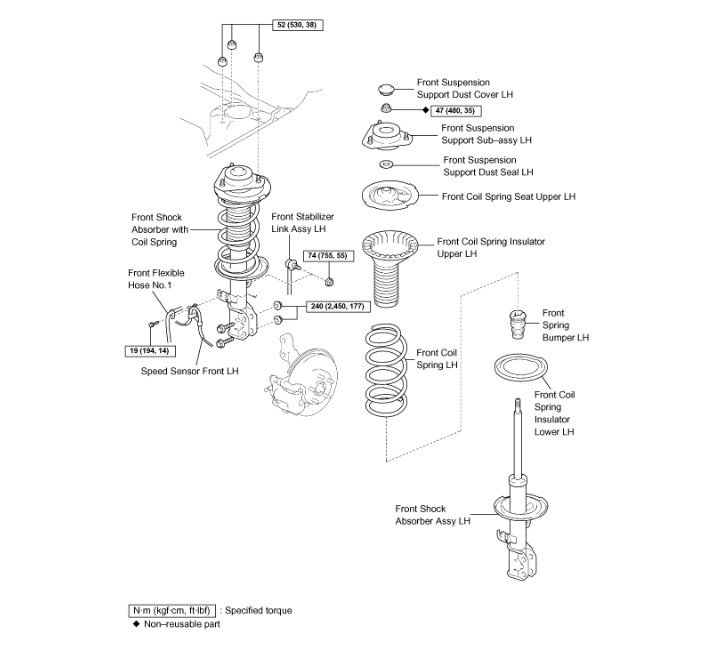

  • 54,128 POSTS
Yep, I was going to suggest that next, you can get complete struts now from Amazon or Rockauto.com check out the images below.
