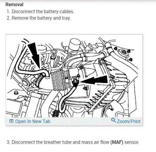

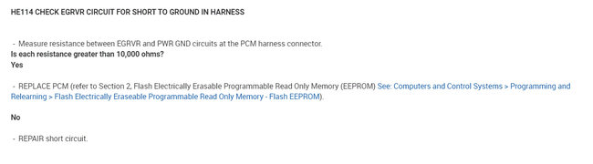

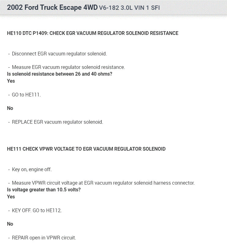

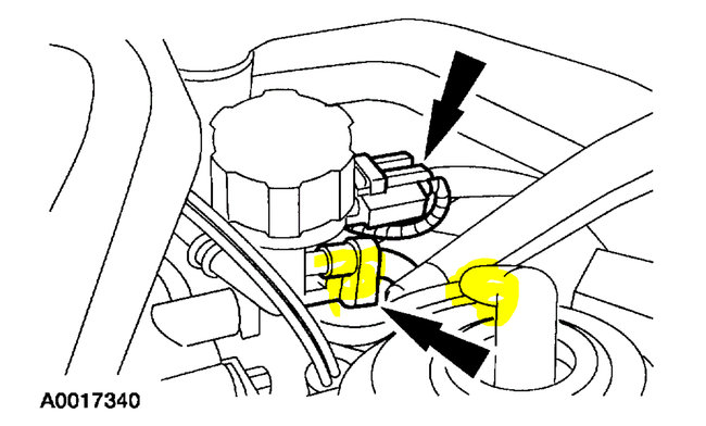

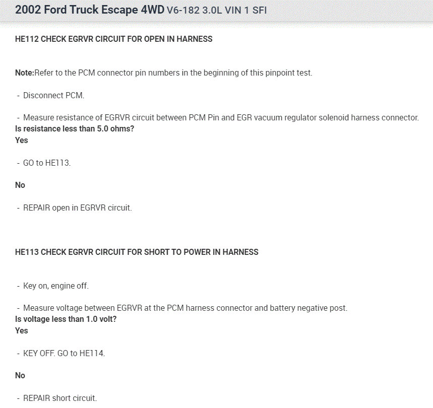

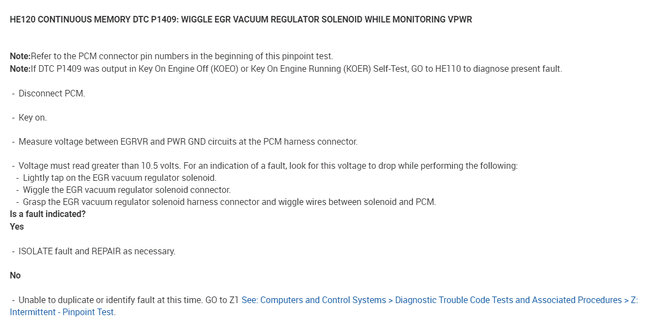

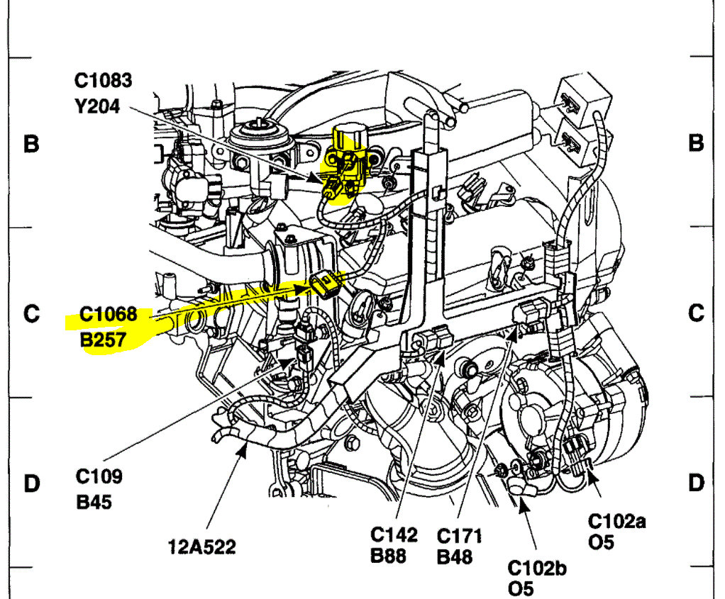

The codes are likely all related and are caused by the P1409. That code indicates an EGR vacuum regulator issue. If there is a leak, that will cause a lean mixture. Inspect the connections at the solenoid first (see the last pic) and if everything appears good, pics 1-4 are the diagnostics specific to the code.
In the vacuum regulator solenoid, there will be an electrical connection. Make sure it is tight, clean, and undamaged.

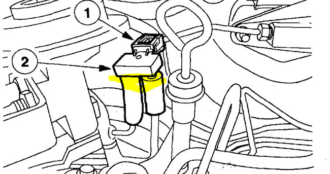

Now, there is one other suspect when you have both lean codes. The DPFE (differential pressure feedback electronic. The too is an integral part of the EGR system. If you look at pic 7, I highlighted the DPFE sensor. It is located on the rear of the engine and mounted to the EGR tube.
This sensor is attached with two rubber hoses to the tube that routes exhaust gas to the EGR valve. Because corrosion can develop inside the sensor, it can reduce its sensitivity to flow, causing a false signal to the PCM. As a result, the PCM keeps the EGR open too long causing the lean mixtures. (I hope that makes sense) LOL In my mind, I suspect the DPFE is the issue, but check it.
So, do the same at the DPFE. Check vacuum hoses for damage and the electrical connection and wiring as well.

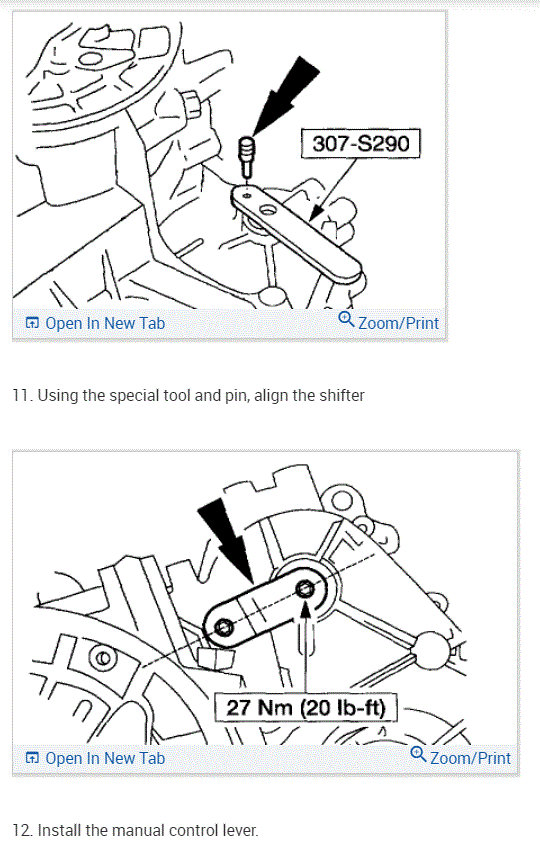

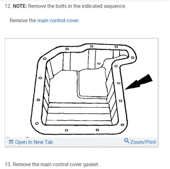

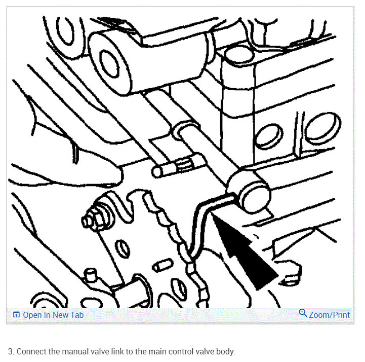

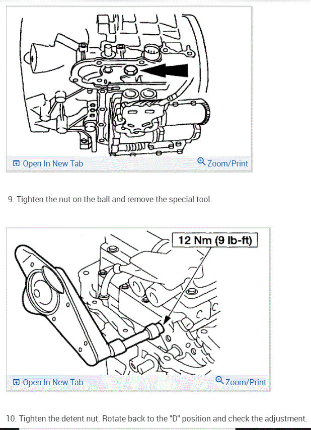

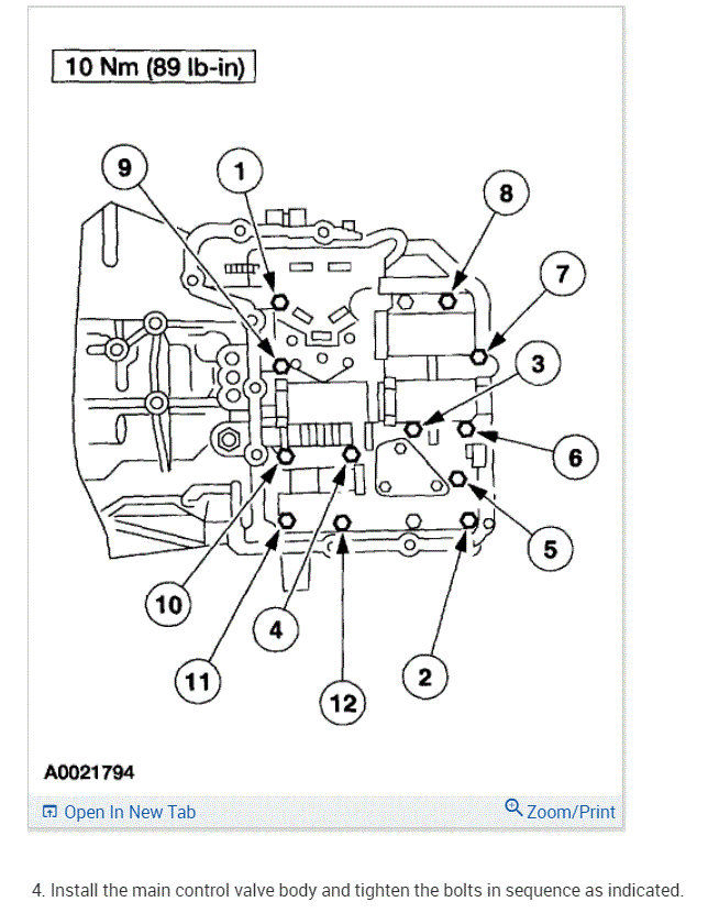

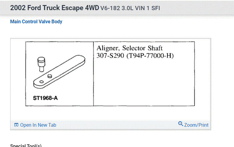

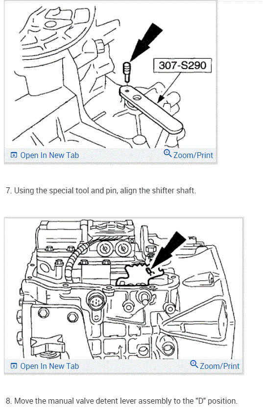

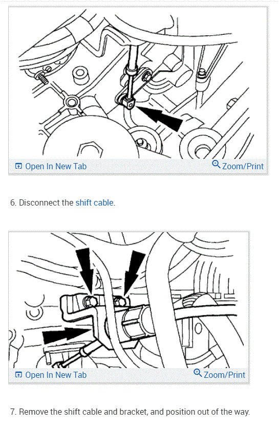

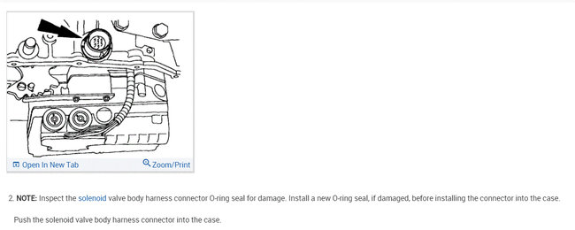

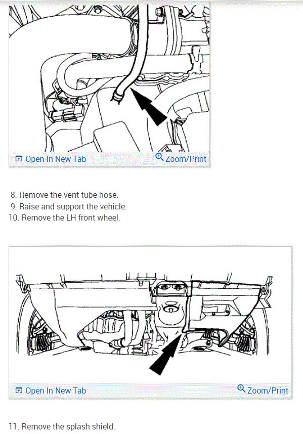

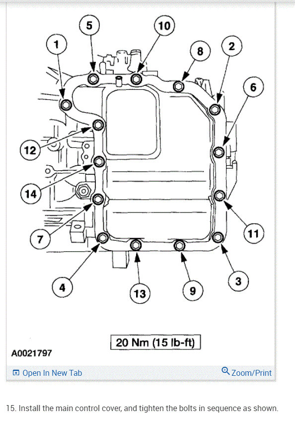

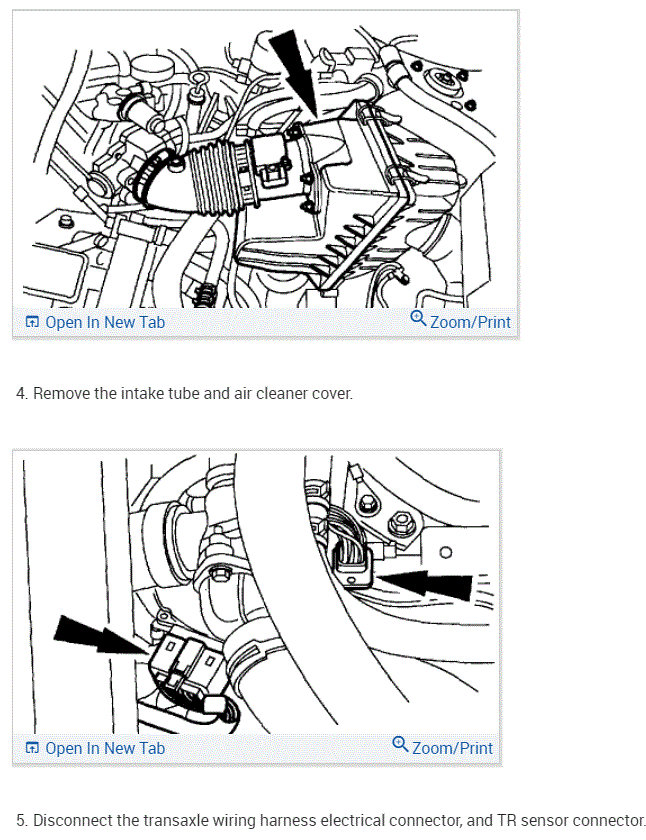

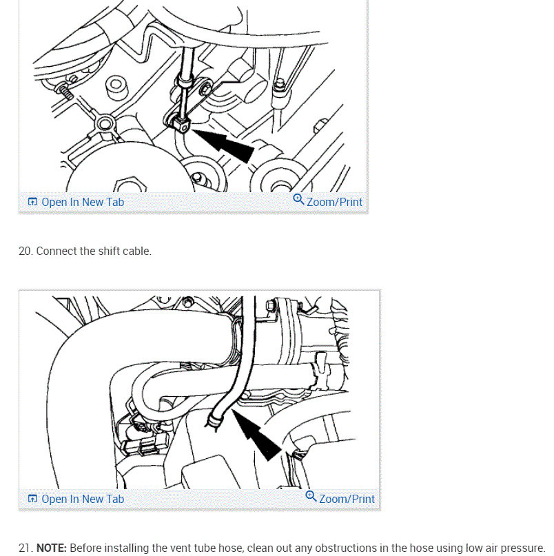

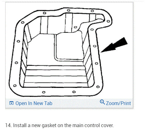

I was looking to tackle this soon so if there's any videos or diagrams for where and how this attempted fix will go, it would be terribly appreciated. Also, is there any way to know which solenoid is which, or which one is the bad one? Since it isn't throwing codes specific to it, I doubt I'll be able to get it to an AutoZone or something to have them be able to tell me unless there's other equipment that can check that better than my mini reader.
Nov 26, 2021 at 2:10 PM
  • CAR REPAIR CONTRIBUTOR
  • 110,190 POSTS

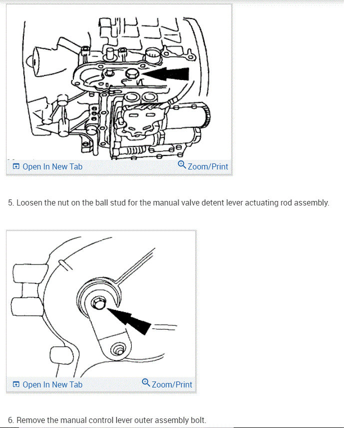

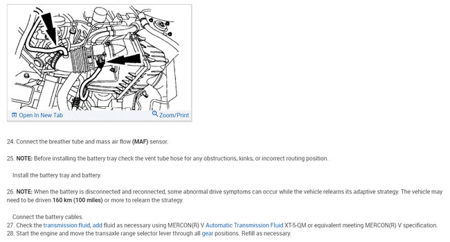

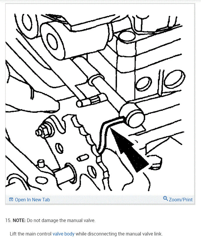

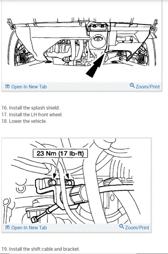

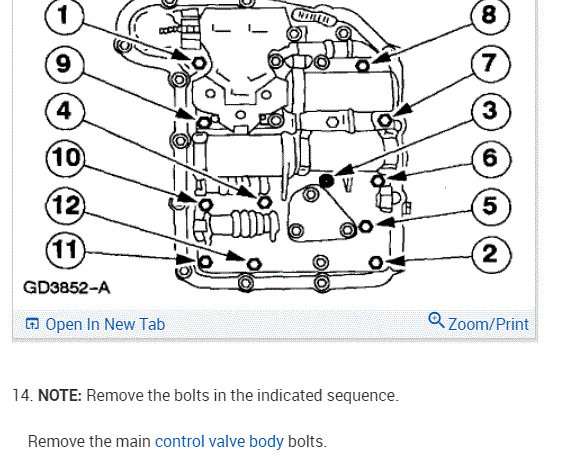

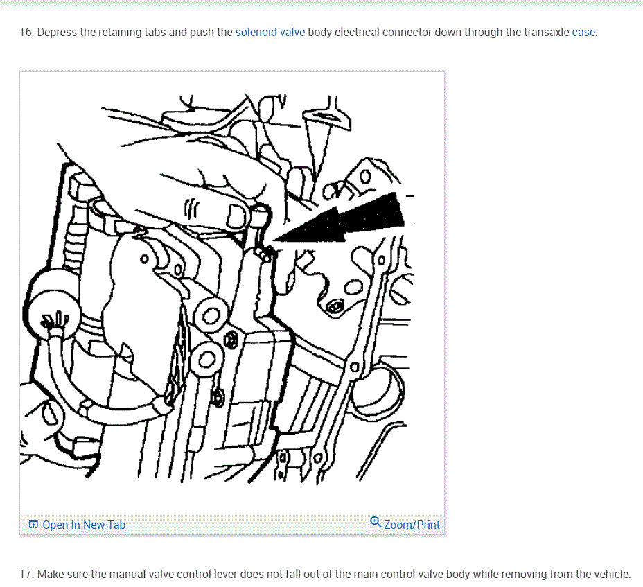

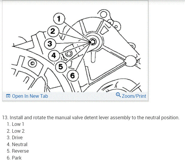

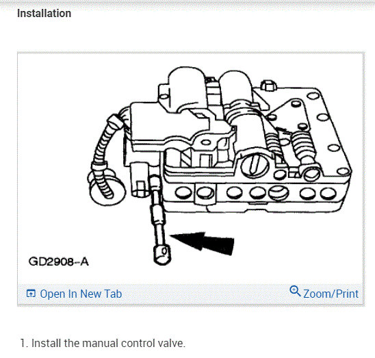

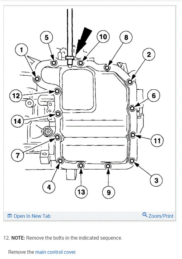

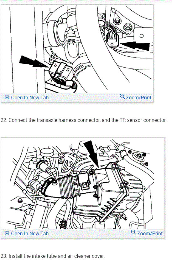

I attached the directions below. I included the procedure on how to remove the valve body and reinstall it. This will need to be done to access the shift solenoids.
Let me know if this helps.
