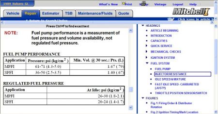

Timing on, fuel ok, spark ok, no loose connections. What could it be?

What was the fuel pressure when you checked it? Let me know
Sunday, January 10th, 2010 AT 12:39 AM
STICHN56
MEMBER
6 POSTS
Between 60-80 psi

No start continues verify engne compression and valve timing
