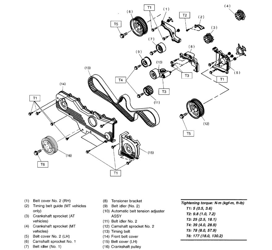

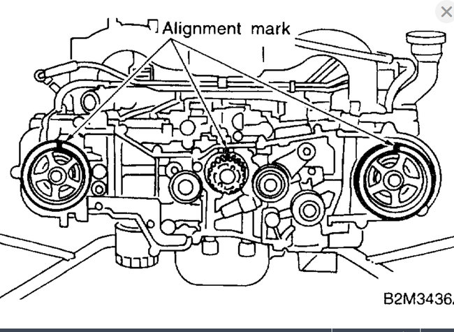

We have an extended warranty on this car and the timing chain tensioner went and wrecked the motor. It is not a mft warranty and the policy shows the timing chain and timing gears are covered. Is a timing tensioner considered a timing gear? This might sound like a crazy questions I am just not too sure..can you show me how to replace the tension and chain thank you for your input.
Apr 5, 2009 at 1:32 PM
SQM
  • CAR REPAIR CONTRIBUTOR
  • 6,383 POSTS

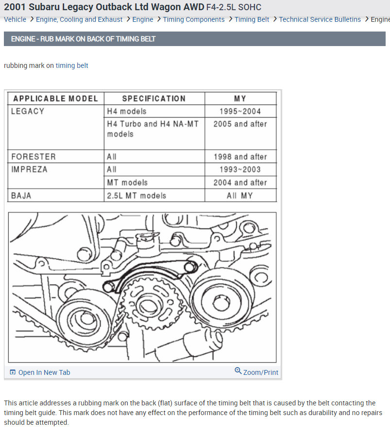

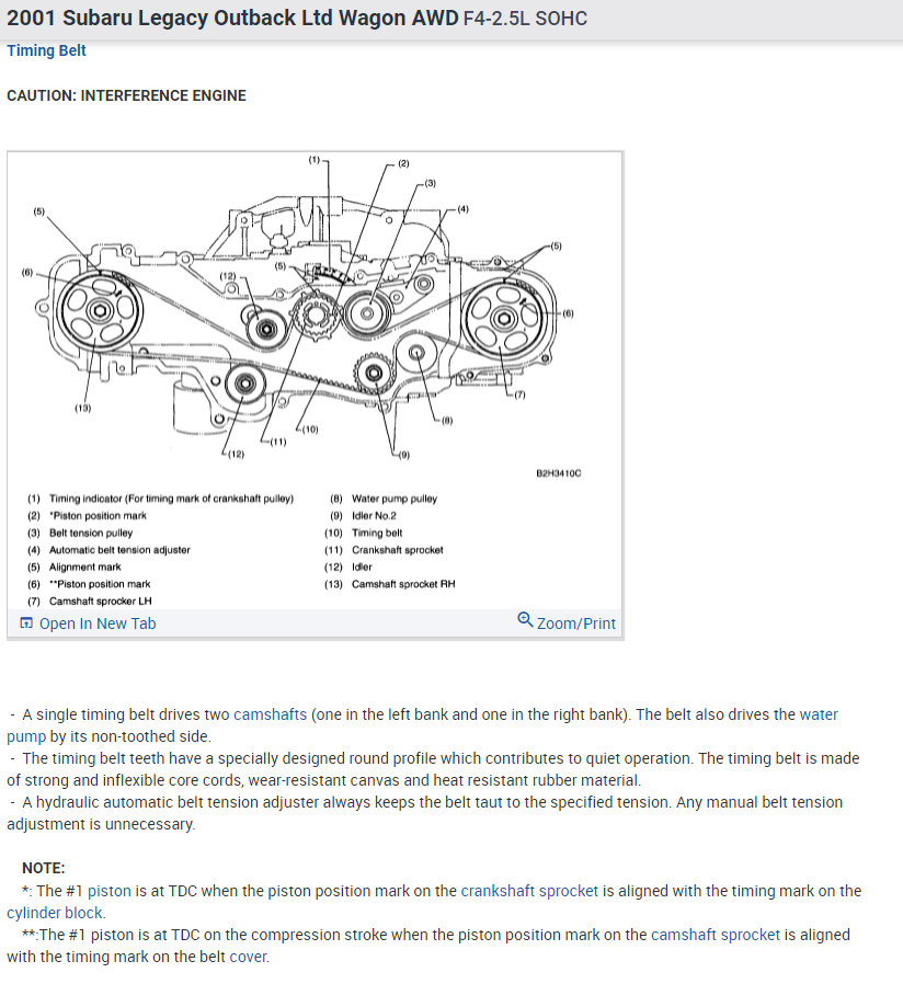

This Outback is equipped with a timing belt and not a chain.
Typically when a timing belt is changed the tensioner gets changed as well as part of the service. So if the warranty states it will cover timing component then you should be good.
So you cannot just change the tensioner.
You might find this article helpful:
https://www.2carpros.com/articles/how-a-timing-belt-works
https://youtu.be/6iGdGMNc6Vk

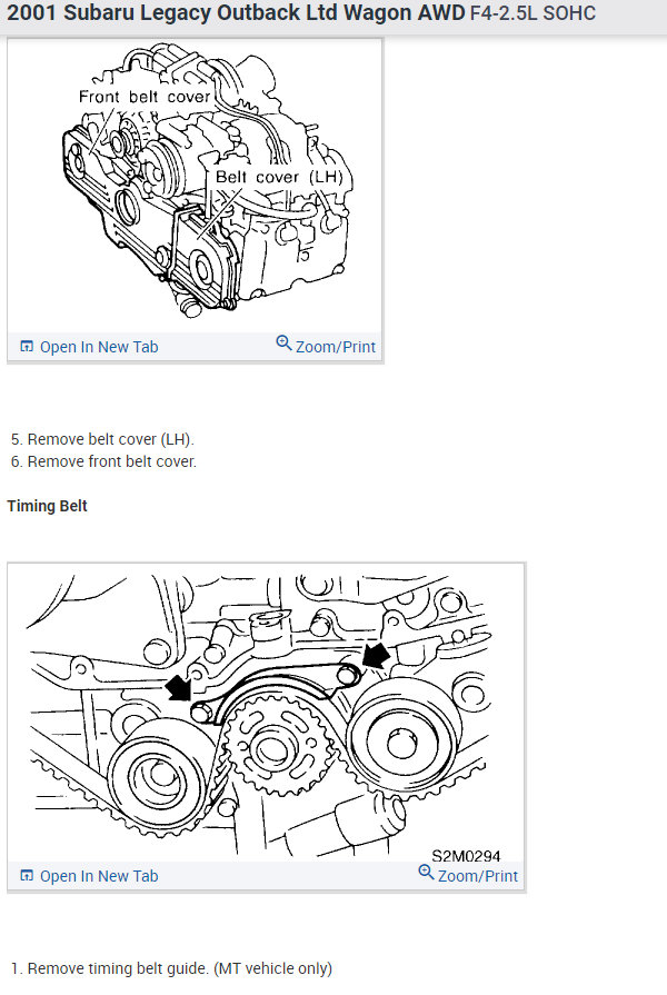

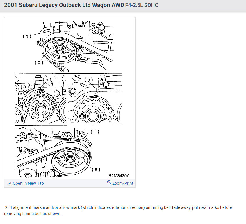

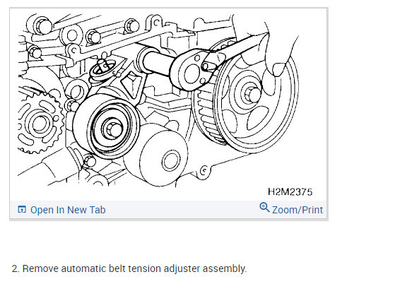

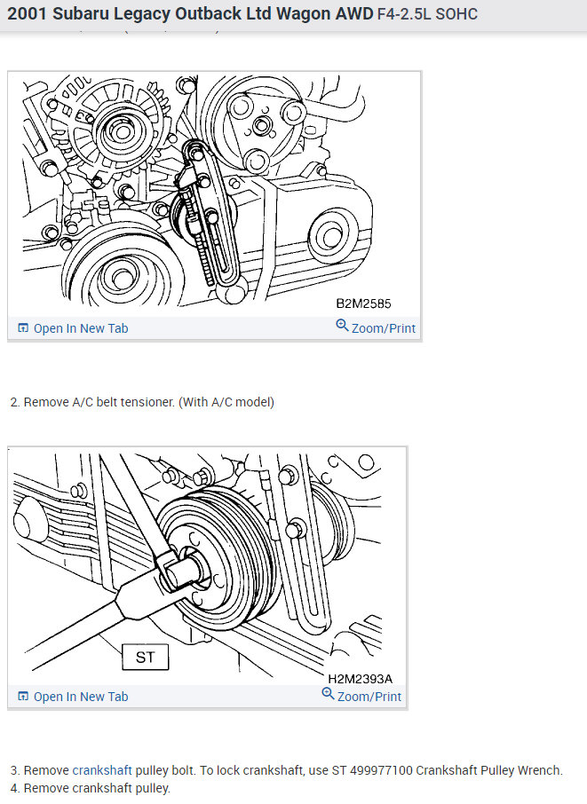

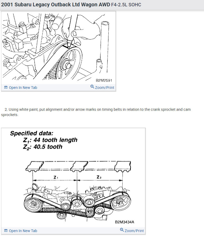

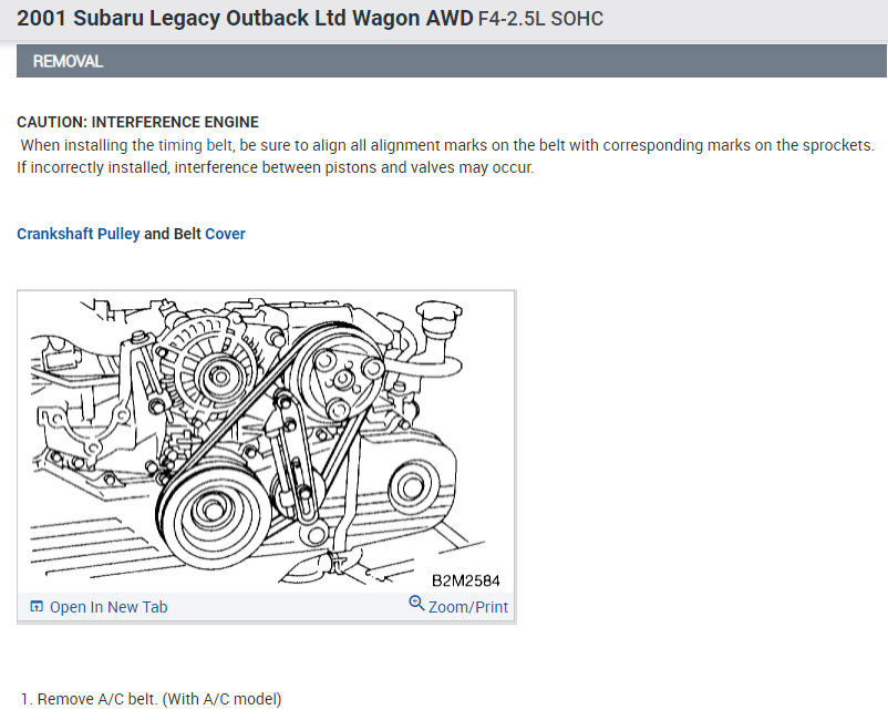

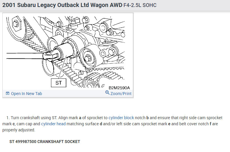

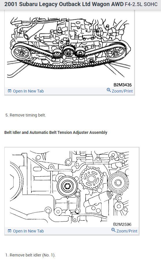

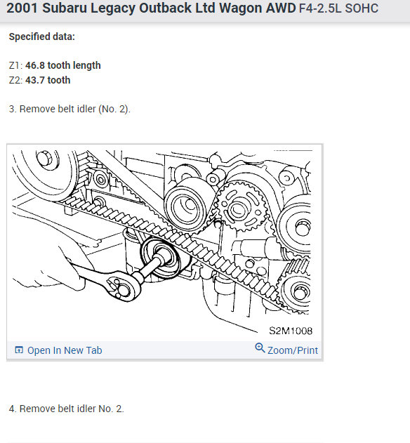

I have attached complete timing belt replacement procedure for your reference.
