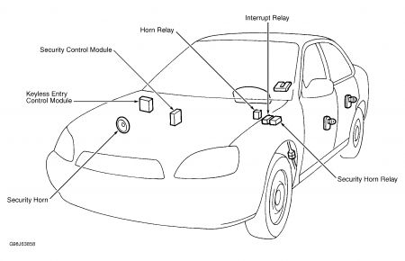

Ok it should be the one in the middle and you will need to remove it and check continuity between terminals 1 and 2 if it has continuity then check the same between term 2 and 6 if it has continuity then you will make a jumper wire and put battery power to term 4 and ground term 1 and then check continuity between 2 and 6 it should not have continuity. This done with the relay itself and removed. if any of the readings are different then discribed above then the relay is bad and needs to be replaced. Here is a pic of the relay for the term numbers. Get back to me with what you find.

ok well the relays that i found underneath the fuse box all have 4 contacts, and there is 4 of them. there is nothing to the left of the fuse box. where else can i find this relay?? i checked the repair manual for my vehicle and it shows me that the interrupt relay is to the right of my main fuse box under the hood, but the only thing to the right of it is my tire, unless it is somehow hidden in the body, i tryed looking under the main fuse box and nothing there just the wires that go to the inside fuse box. the last place i will check is inside the car to the left side of the pedals i see wires going into there, i will try to open it up and see maybe it is there, but i havnt seen anything yet.

It tells me that the interrupt relay it behind the left side (drivers side) of dash inside the car. There is two relays side by side one is the security horn relay the other is the interrupt relay, then there is the horn relay on the other side so it is the one in the middle. I will include a pic in hopes that it helps.

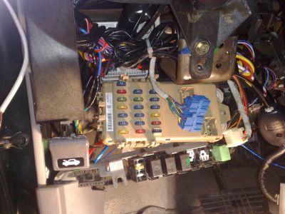

this is the same diagram that I have and i cannot find it. ive looked everywhere, even behind the air vents, i have not found any relays that big. I have attached a picture of what i see when I open the drivers side.
https://images.2carpros.com/forum/automotive_pictures/314778_02112009044_1.jpg
the black thick cables at the top are from my compustar alarm system which is working fine. and the row of relays at the bottom is what i was telling you about, all of which have 4 contact points not 6. If you can please help me, ive been to many mechanics and specialist and no one can help and they all say go to subaru, who also have no idea but will charge an arm and a leg to do the same trouble shooting i have done.

Ok if you look at the three relay's and then there is a green one to the right that is the bank of relay's that they are refuring to. The black one in the middle of the three together is the one we want to test.

this relay only has 4 terminals not 6 as you described above with the diagram. i have checked this relay to see if it works, but only by simply passing a current through it.

Ok does it have power to it? It maybe that we have the wrong relay as this is difficult without the vehicle infront of you you know. Is there any other relay's up behind that bundle of wires that you can see? Why are the blue and white connectors unpluged from the fuse panel? Get back to me and we go from there.

on another note the blue and white cables were disconected so i can look behind the fuse panel, there are no other fuses that i can see behind or around the panel.
