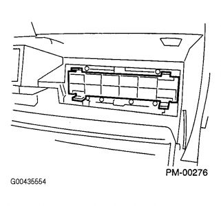

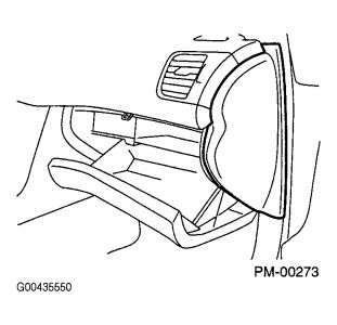

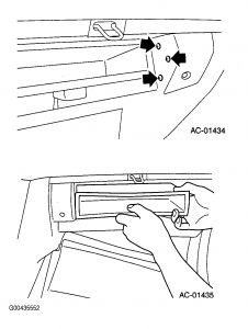

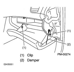

How do I get the glove box apart to replace the cabin air filter in a 08 Subaru Legacy?
Saturday, July 10th, 2010 AT 2:27 PM
DOCFIXIT
MECHANIC
18,828 POSTS
Remove side cover
Remove glove box clip
Remover upper tray screws
Remove filter
