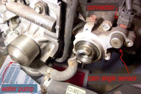

I had the diagnostic procedure done on the blinking tranmission light and it read that it was a faulty solinoid. And my check engine light was on also and it read that it was a cam shaft sensor. My question is can you tell me where these items are found on my car so I can chage them out myself. I know the trans solinoid maybe would have to be on the transmission somewhere but can you pin the exact location where and maybe send a picture of the solinoid and cam shaft sensor so I can recognize the items. Thanks for your help.

There are over a half dozen solenoids inside the trans.I would honestly leave the trans part of this to a shop that does thatsort of thing, it may require going in deep and there are alot of parts in an automatic trans. The cam sensor is on the drivers side front of the engine, my software doesnt give a good pic of its location but it looks like this.
https://www.2carpros.com/forum/automotive_pictures/1639_camanglesensor1_1.jpg
Friday, June 11th, 2010 AT 8:12 AM

Thank you for the picture of the cam shaft sensor to show where it is located.

I will take it to my local transshop tomorrow to have it looked at.
Can you tell me if a crank position sensor and a cam sensor the same thing. I was looking for a cam sensor on ebay to buy for the subaru but I did not see a cam sensor ebay had crank position sensors for sell and they looked like the one in my car and on the picture you sent me. I was wondering if they are the same so I can buy it. Thanks for all your valuable information it has saved me alot of money over the time I have been using your site. Thanks
Saturday, June 12th, 2010 AT 10:27 AM
2CARPRO JACK
  • 11,533 POSTS
I would not think they were the same sensor.
Monday, June 14th, 2010 AT 8:12 AM
