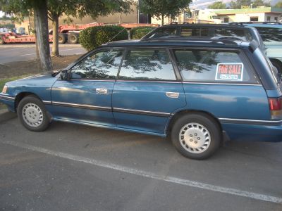

Everything turned out very well. I was worried because the marks are not as easy to line up as my other cars were, but they were
pretty accurate. One mark on the cam wheel looked like it was off by the length of an 1/8 in after I got the pulleys on, but the marks that were built in to the belt itself all lined up. I counted the teeth on the belt as the books said also. The two small holes in the crank pulley hub I talked about are not used.
It runs very well. I can see some of your picture on the website, but it is a little dark. It looks like you have a family. I Hope you are
https://www.2carpros.com/forum/automotive_pictures/212472_CIMG0346_1.jpg
well. John.
