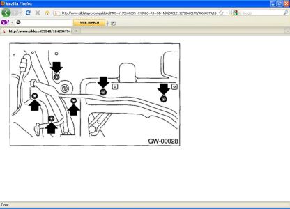

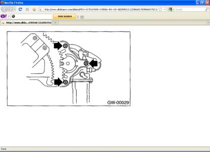

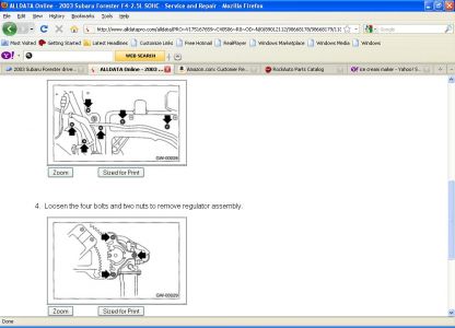

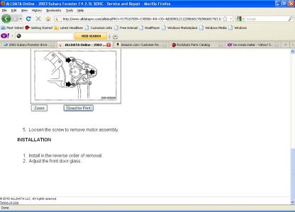

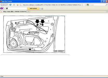

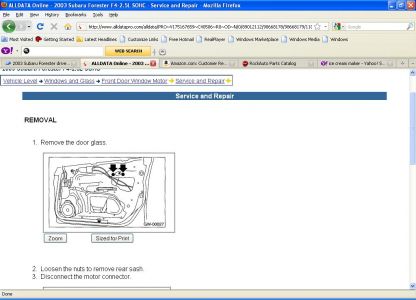

How do i remove from door, I have everything off, I can slide the motor back and forth. Cannot figure out how to remove to replace it.

First of all thank you so much for your donation.I posted the window motor replacement for you.
