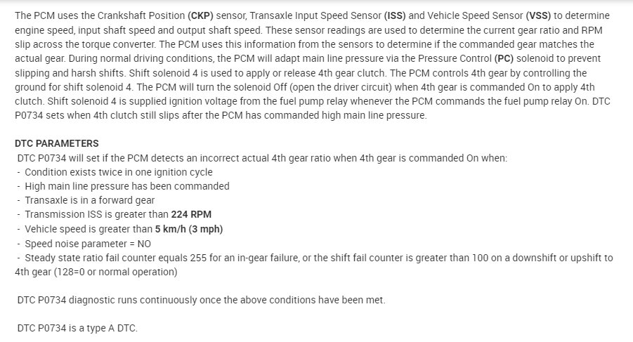

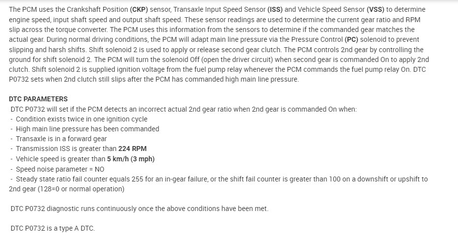

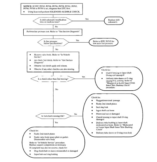

Transmission slams going into second gear and high RPMs trying to go into fourth gear if it even does. Reverse not so good but read I have to open up tranny and tighten nut to fix that problem but haven’t done that yet. I'm wondering if I replace speed sensors will it fix my gear ratio problem no codes for sensors.
Jan 27, 2023 at 11:57 AM
  • 110,193 POSTS

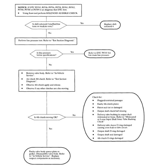

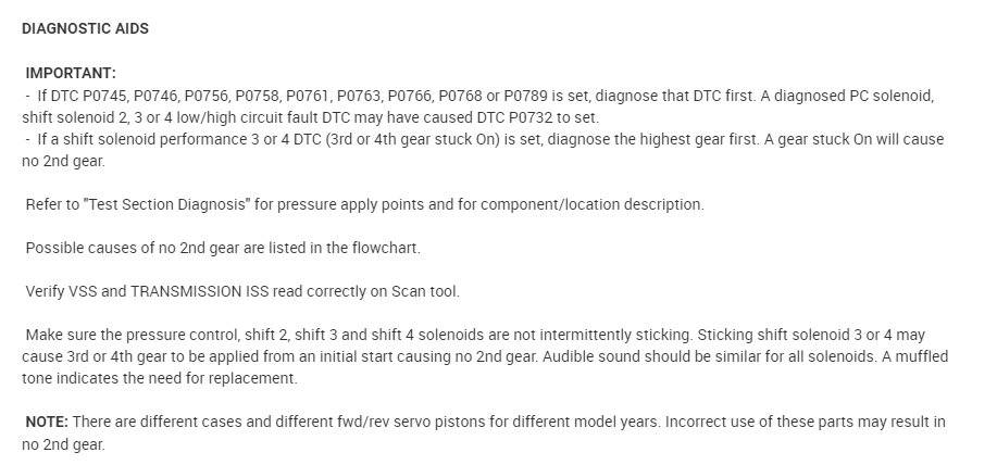

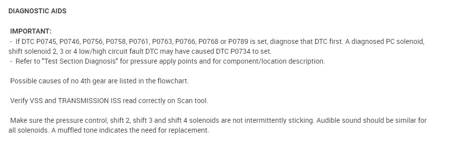

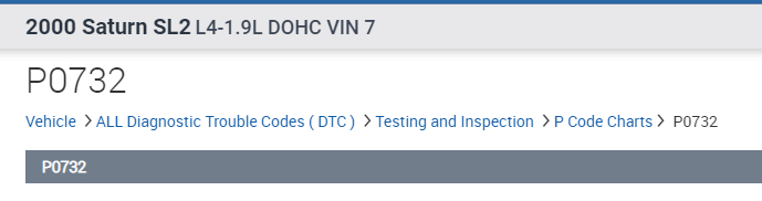

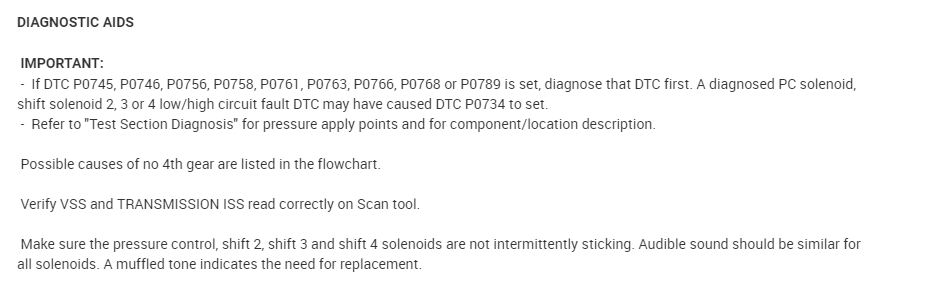

The codes indicate it could be a solenoid-related issue or even a line pressure-related issue. Did this problem happen all at once?
I attached diagnostics below for both of the codes. You will notice they are similar to an extent. Take a look through them and let me know if this is something you are comfortable doing.
