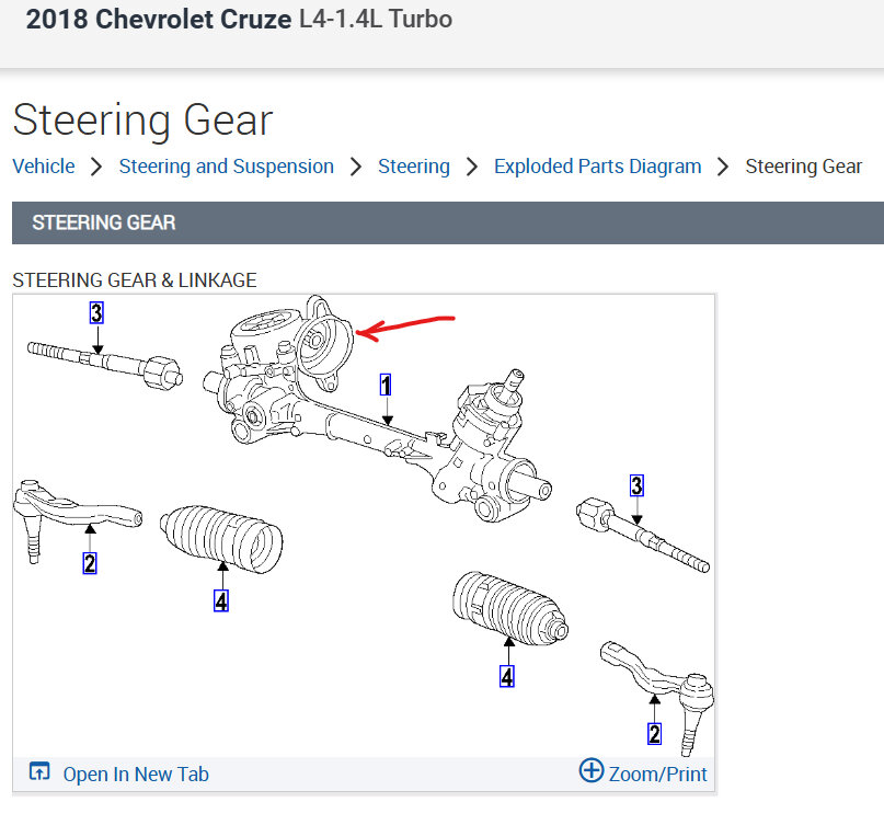

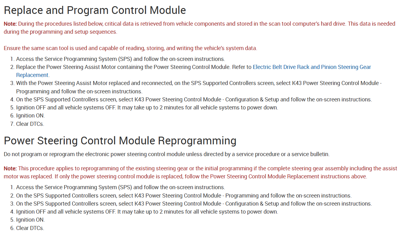

When this happens the steering rack control module needs to be replaced which is part of the steering rack. Here is what the part looks like that needs to be replaced. I would also use a CAN scanner to run the codes to help confirm the issue. Please go over this video to help. I don't think the tire store has a CAN scanner just a regular drivetrain scanner.

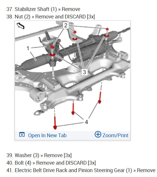

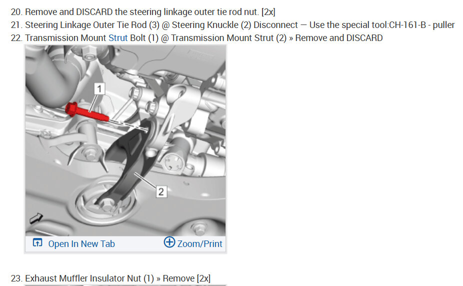

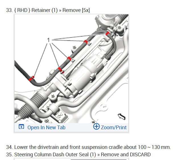

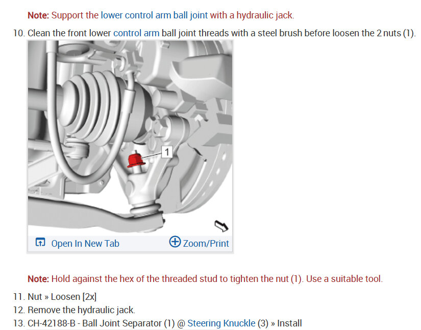

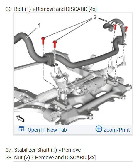

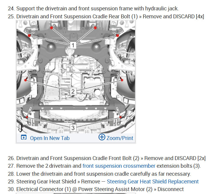

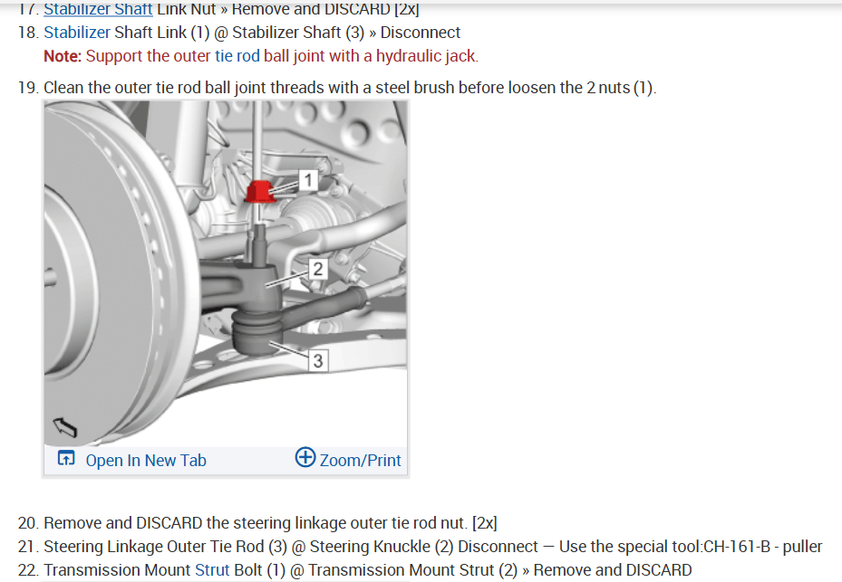

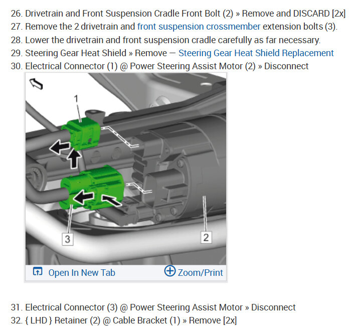

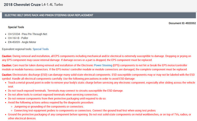

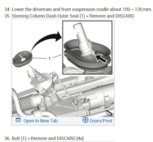

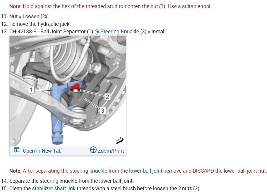

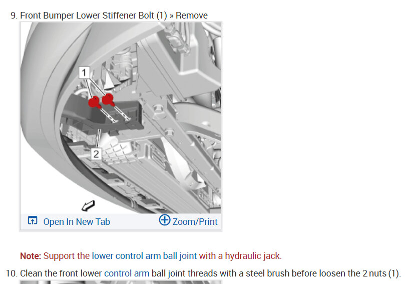

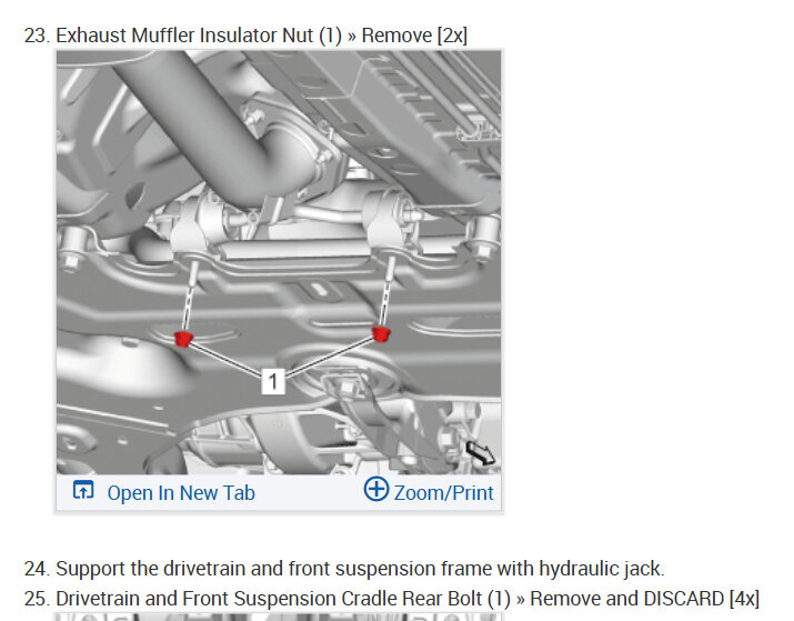

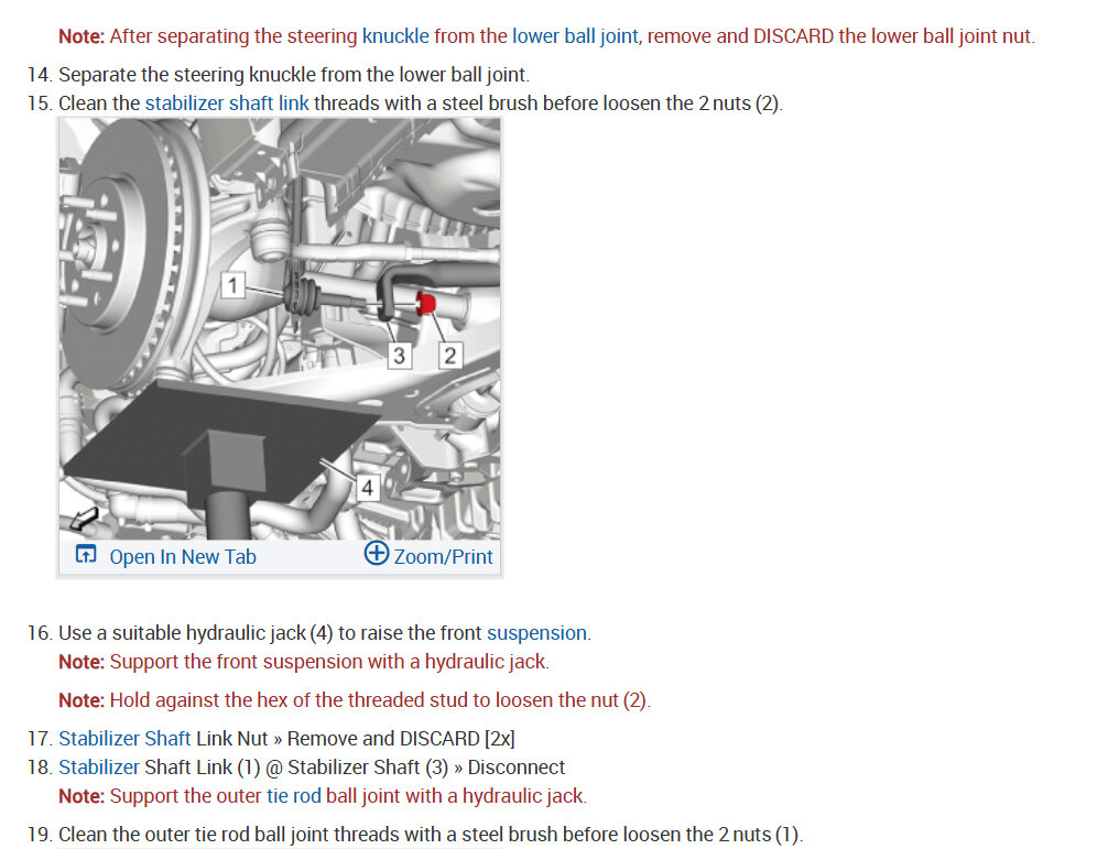

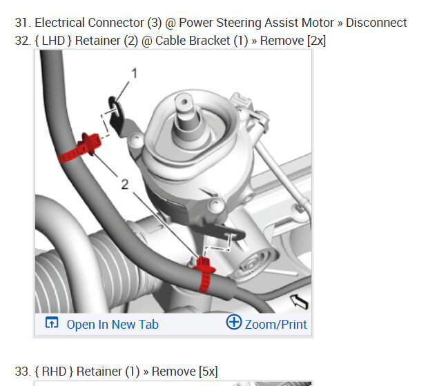

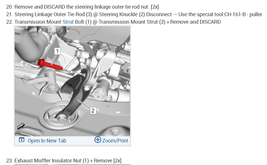

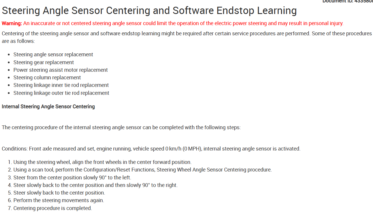

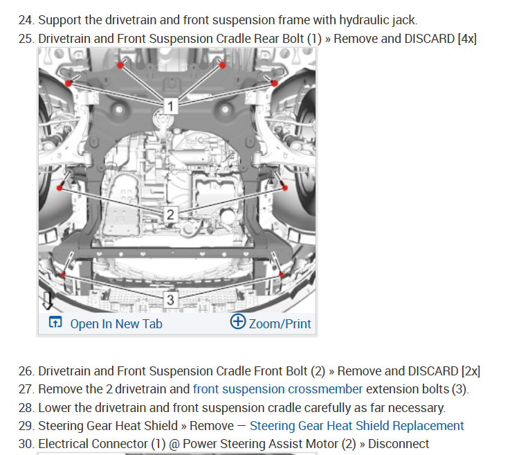

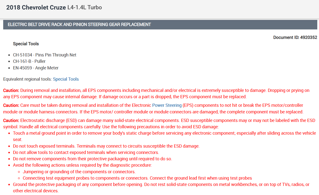

It looks like it will need to be programed but I have heard of people installing a used unit and it worked just fine. Here are the instructions on how to replace the electric steering rack. Check out the images (below). Please let us know what happens.

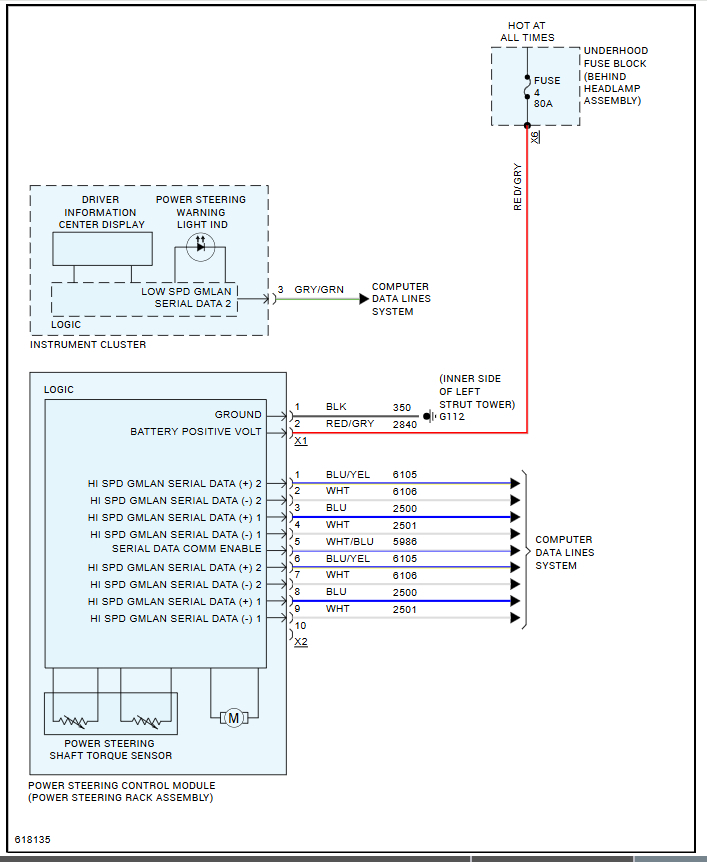

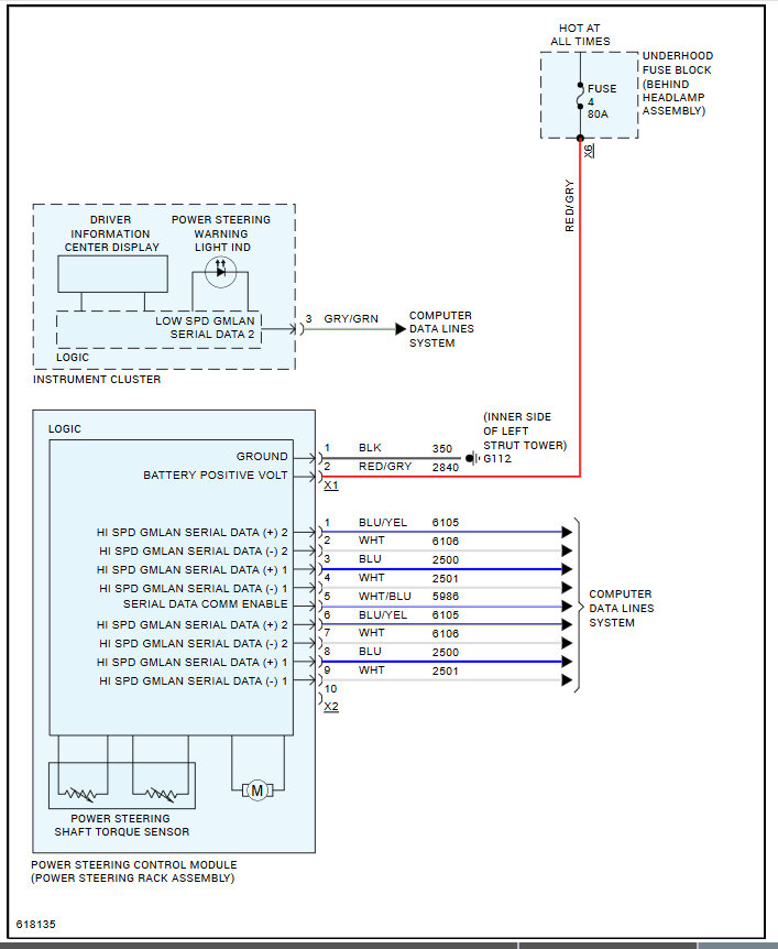

I don't see a "steering wheel lock sensor"? Here is the wiring diagram for the steering. Do you have an image of it? Please look at the wiring diagrams below.
