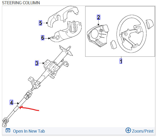

So last night it was nasty and rainy out all day and the temperatures were in low 70s. On the way home I had blasted the A/C in the car resulting in condensation on the inner windshield and the car being super cool inside. Would this lead to a little squeak in the steering wheel this morning? I noticed a bunch of condensation on my car, and it was much cooler out than usual I would say low 70s but I live in Florida so usually it's 80s or 90s but after last night's rainstorm it was a lot cooler out. Could that make a squeaky steering wheel?

Chances are the squeak is caused by the steering shaft where it goes through the firewall. I would use some WD/40 to help stop the noise. I marked with a red arrow where you should apply the oil. Check out the images (below). Please upload pictures or videos.

Yes, is does happen, if you upload as short video of the noise I can be sure. Please upload the video in your response.

I don't have a video, but I can describe it. It's an intermittent rubber squeak noise like there's tension and it's mainly when I turn the wheel left or right.

Yep, I would use WD40 at the shaft point above.
