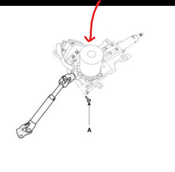

Thanks for the video, it helps. To me I would look at the front rotors which if they are warped it will make this sound/action. If they are okay, it sounds like the power steering motor is going out, which is common. Here is the location of the motor and a guide to help as well so you can check it out.
https://www.2carpros.com/articles/steering-wheel-shakes-when-accelerating-or-braking
You might be able to do a CAN scan which if the system has a code, it will help confirm the issue. You can get a CAN scanner (Controller Area Network) which will work on most cars from Amazon.
https://youtu.be/u-4syLc-ifQ
