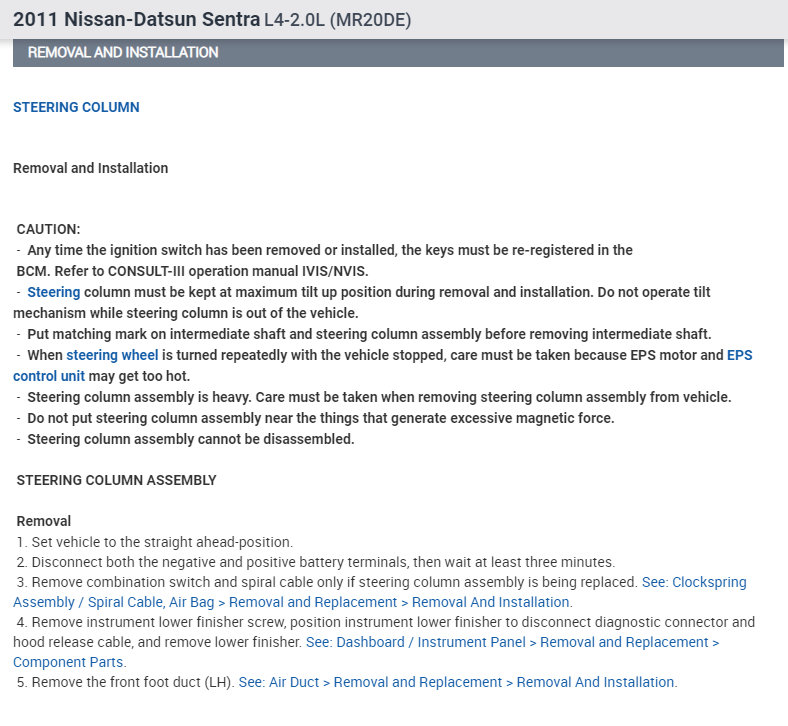

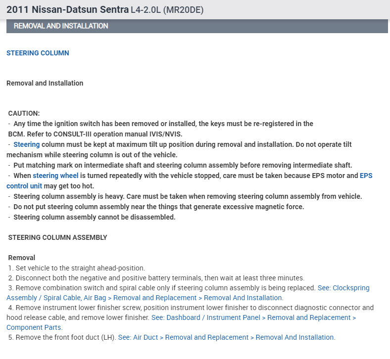

How do you replace a steering wheel shaft on the car listed above SL model?
Feb 2, 2022 at 7:17 PM
SQM
  • 6,383 POSTS

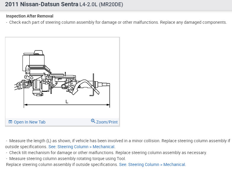

In order to remove the steering column, first the steering wheel needs to be removed.
Keep in mind to take extra care when handling airbag module.
Take a look at this helpful guide:
https://www.2carpros.com/articles/steering-wheel-removal
I have attached the replacement steps below for your reference.
If you need any other information, please let me know.

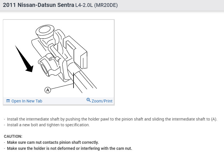

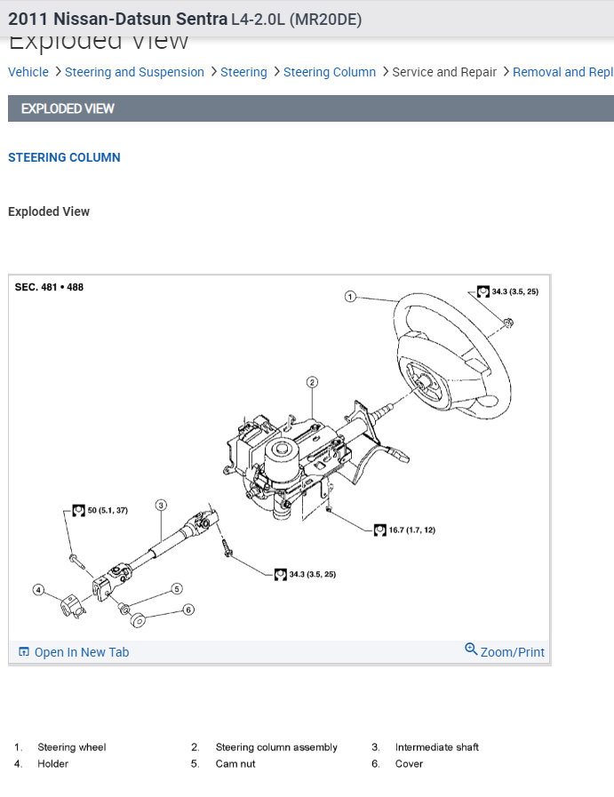

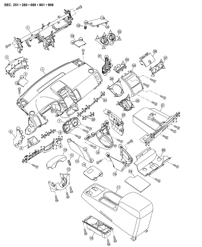

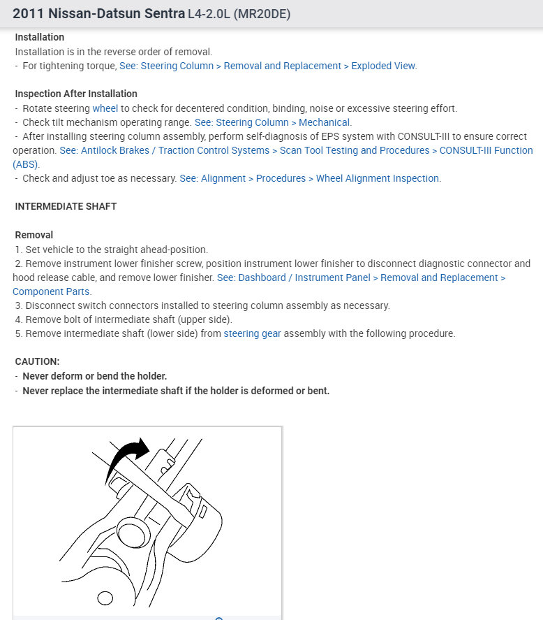

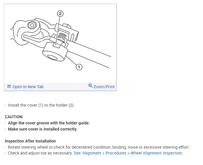

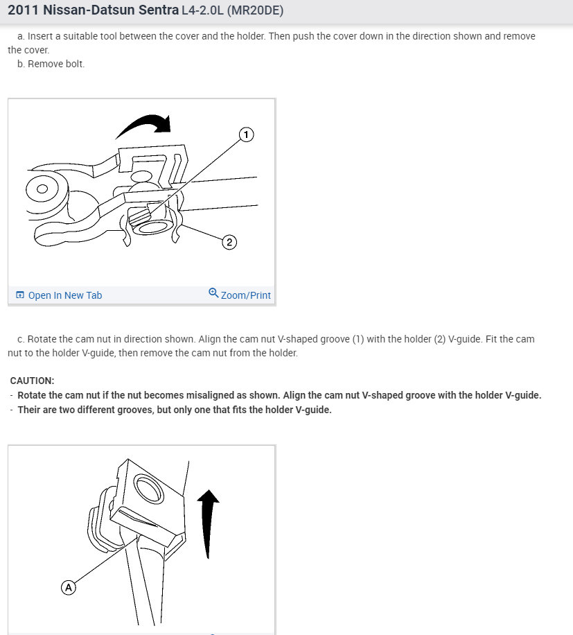

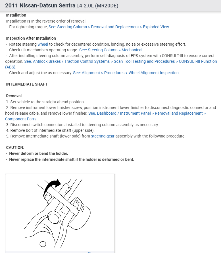

I just need to remove the intermediate steering colon linkage that goes at the bottom.
Feb 2, 2022 at 8:03 PM
IFYUSER
  • 54 POSTS
Number 3 in the picture.
SQM
  • 6,383 POSTS

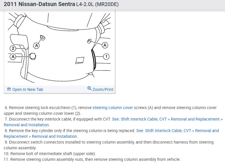

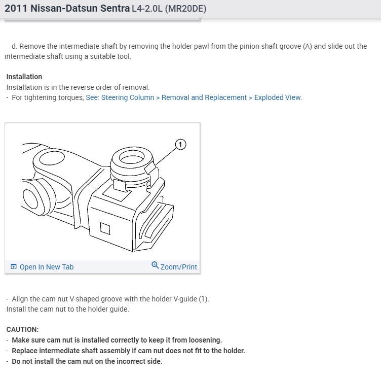

Got it. If you look at diagrams, the intermediate shaft procedure starts from the number 4 diagram/attachment.
You will have to remove part of the instrument panel to have clear access.
