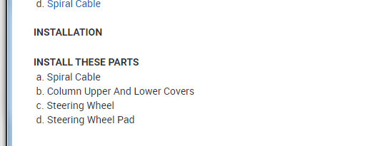

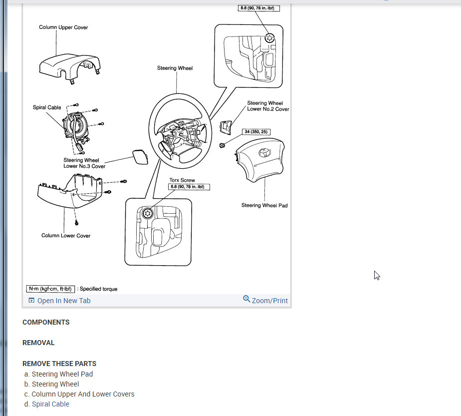

Can you get a recording of this? Sounds like what you are saying is when turning to the left you are not reaching the steering stop?
If this is the case, more then likely the clock spring is broken. However, this could be some other issues so we need to get a video just to clarify the issue so we are going after the right thing.
https://www.2carpros.com/articles/steering-wheel-clock-spring-removal
Let me know and we can go from there but here is the info on the clock spring.
