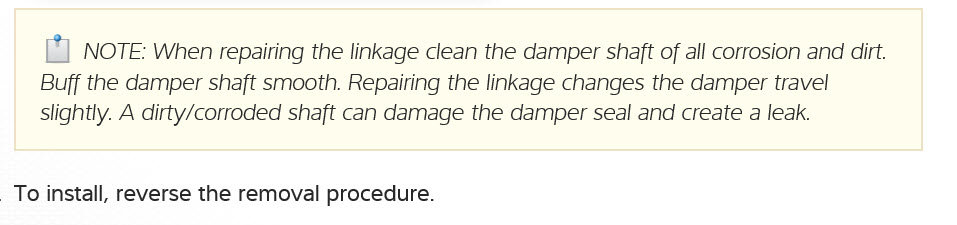

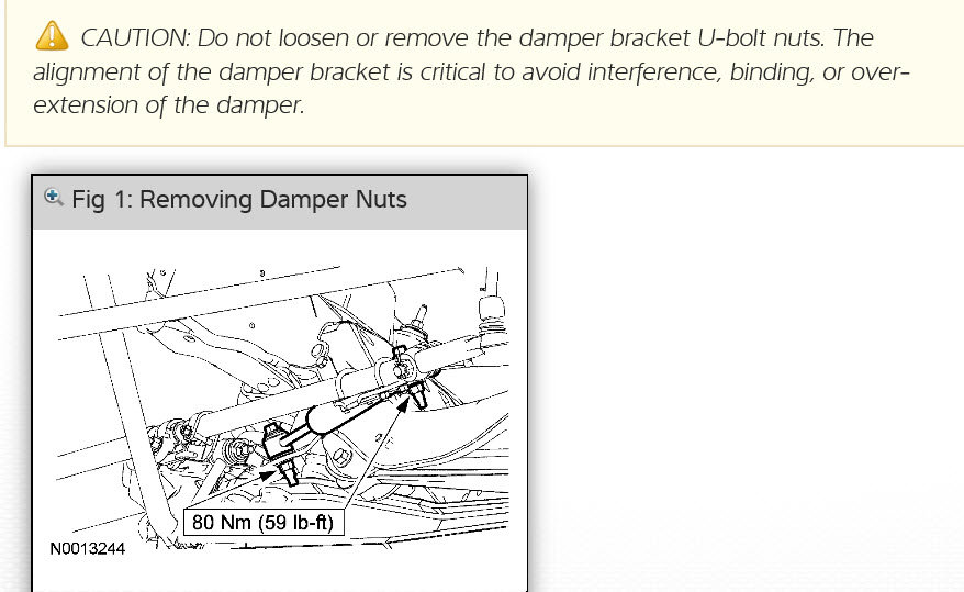

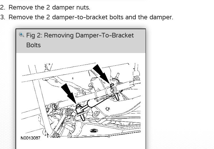

How do you reinstall the shock dampe4?
Friday, August 5th, 2016 AT 5:58 PM
HMAC300
MECHANIC
48,601 POSTS
See pictures this is for a 2wd and a 5.4 engine.
