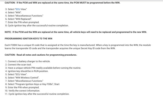

Bought a vehicle with only one key. Did not know that the car had an alarm until I set it off. On Monday found out how to turn the alarm off but now I'm having problems starting the vehicle. I believe that I need to disengage the fob. How do you do this?
Thursday, March 26th, 2020 AT 12:42 AM
SCGRANTURISMO
  • 4,897 POSTS

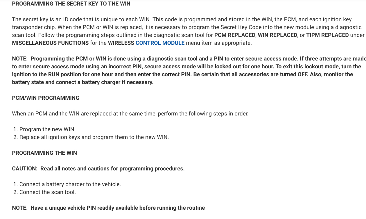

Is the security indicator illuminated? In the diagrams down below I have included the reprogramming instructions for your vehicle's ignition immobilizer, but it requires a Dodge scan tool. Please get back to us with whether the security indicator is on or not and we can go from there.
Thanks,
Alex
