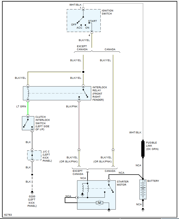

Starting the engine turn the key, and I can hear the relays click and nothing?
1995 NISSAN HARDBODY
12,600 MILES • 1.2L • 4 CYL • 2WD • MANUAL
VICTOR REY MORALES
I turn the key, and I can hear the relays click and nothing. bought a new battery and fired up one time is all. Now i changed the safety switch in the clutch down under the dashboard by the fire wall. Fired right up the first one time and that was that no more starting with key now I just push start it. point me in the right direction I feel like just throwing it away and get another one.

Yep, it sounds like the starter is no good or the interlock relay has gone bad, I would use a test light to test the trigger wire of the starter to see if it is getting power when in the key is in the crank position.
Here is a guide to help and the starter wiring diagrams so you can see how the system works:
Please go over this video as well:
https://www.youtube.com/watch?v=6YRW8fyNudY
The starter motor location is on the right side of the engine down low near the rear. Check out the images (below). Please upload pictures or videos in your response of any problems so we can see what to help you with.
