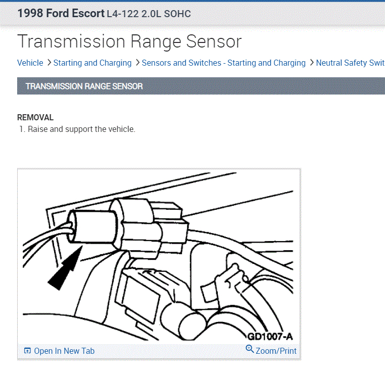

When you say it's not starting, do you mean the starter won't engage to turn the engine, or is it cranking but not running?

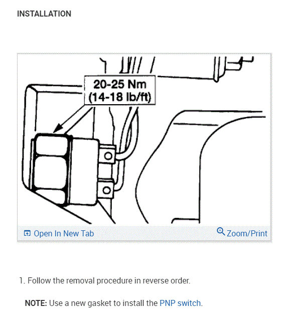

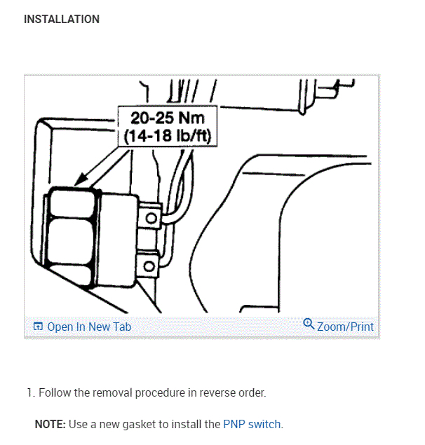

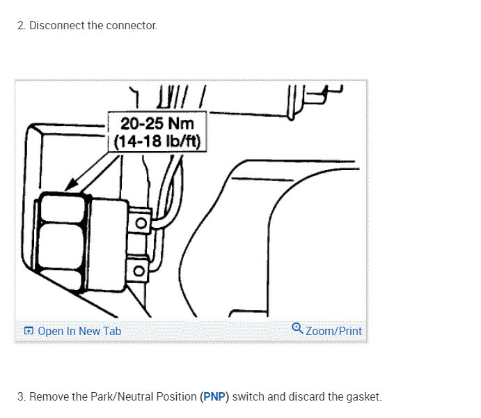

As far as the switch is concerned, it just bolts onto the transmission. I attached the directions below for replacing it. As far as the switch is concerned, usually, it will start in neutral when it starts to fail, but anything is possible.
Let me know exactly what happens when you turn the key, and it fails to start. For example, do the dash lights turn on? Do they go out when you try? Let me know anything you can think of that may help me diagnose the problem.
Also, keep in mind, if the starter doesn't engage, it could be a relay or something simple such as a loose or corroded battery terminal. I just need a little more info.

No problem whatsoever. Since the starter always engages, the neutral safety switch isn't causing the no-start condition. The neutral safety switch would prevent the starter from engaging if it were bad.
When the engine cranks and doesn't start, usually it is the result of an ignition spark issue or there is no fuel making its way to the engine.
Do me a favor. Read through this link and let me know if it seems to mirror what you experience. If it does, then I can explain how to check the crankshaft position sensor.

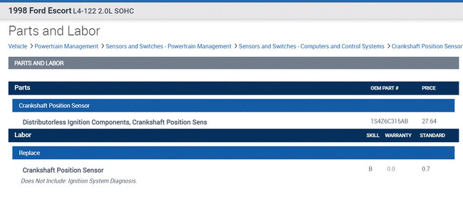

I replied to your message above but dummy me didn't send it. There is no tachometer in my car and if the problem is because of the crankshaft sensor being bad that would clear up why it's always started from home but then when I start to go back home it might start and it might not. I never know because it's not every single time. Yesterday when I went to the bank started like it usually does and when I tried to start it again it was fine, and I went to Ingles and then when I came out to go back home it didn't start so I tried it in neutral again but this time it didn't start in neutral either, so I put it back into park and it started. When I got back home and pulled up to back in because my parking is almost too narrow when everyone is home, I can't pull up to back in because I'm not good at judging how close I am, and I didn't back up far enough and didn't notice until I got out. I quit trying to back in for a while but later when I went back outside to start my car to back up more it started fine so it's starting fine when the engine is cool but after it's warm from driving it, it doesn't want to start again. Crankshaft sensors aren't cheap and there'll also be labor included again. Idk what to do right now with my landlord selling this property last week and not letting any of us know what he was planning to do was wrong and the new owners are raising the rent almost $200.00 telling us they had to raise our rent to meet the market value. I understand all that but good lord almost $200.00 with no warning is not right in my opinion. Oh well shouldn't be surprised since everything else is getting higher also. It's a crazy world we live in today.
Wednesday, June 1st, 2022 AT 4:08 PM
  • 110,194 POSTS

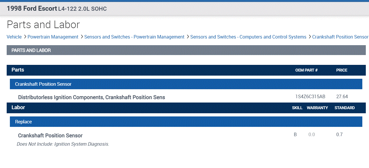

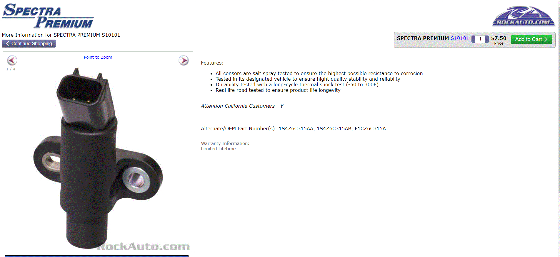

If you supply the part, labor calls for 0.7 hours, so about 45 minutes. Don't let them overcharge you.

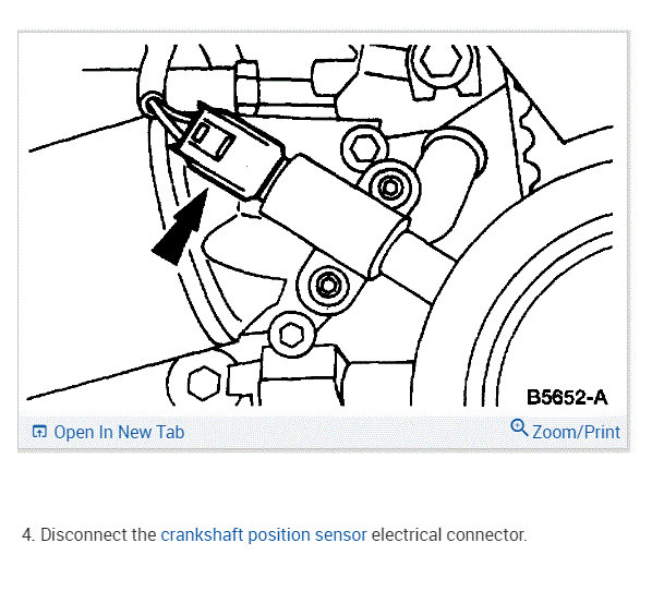

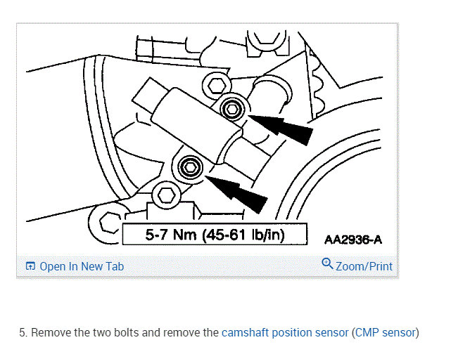

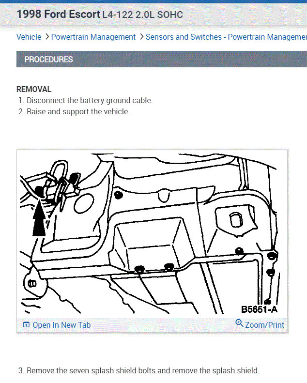

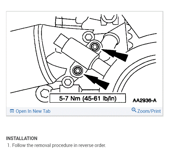

On the other hand, it really isn't hard to replace. It is located right next to the crankshaft pulley. There are two bolts that hold it in. The worst part is removing the splash shield under the vehicle if it is still attached. LOL
Here is a link that explains in general how it's done.

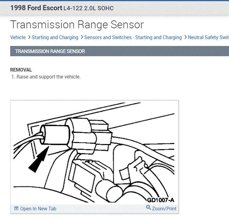

If you look at the attached pics, they provide the directions specific to your vehicle. Please note that for whatever reason, they start by referring to it as a crankshaft position sensor. Then, they call it a camshaft position sensor. That was an error. The directions are all related to the crankshaft sensor.
Let me know. If you want to do it yourself, I can help you through the procedure.
See pics below. Note: Pic 5 shows the flat rate/ labor allotted for the repair. They shouldn't charge you for any longer. Also, the OEM part number is listed and the price. If you purchase one online, they usually provide the OEM part number in addition to their own. Just make sure you are getting the correct one. I looked it up on rockauto for you and crossed referenced it. The cost is 7.50 plus shipping. See the last pic.
Also, here is a code for an additional 5% off the part. Copy and paste it in the section that asks how you learned about them.
203171354183710334
Please understand that neither 2carpros nor I have anything to do with Rockauto. I'm just trying to make it a little easier. I don't want you to think in any way that we get a kickback.
