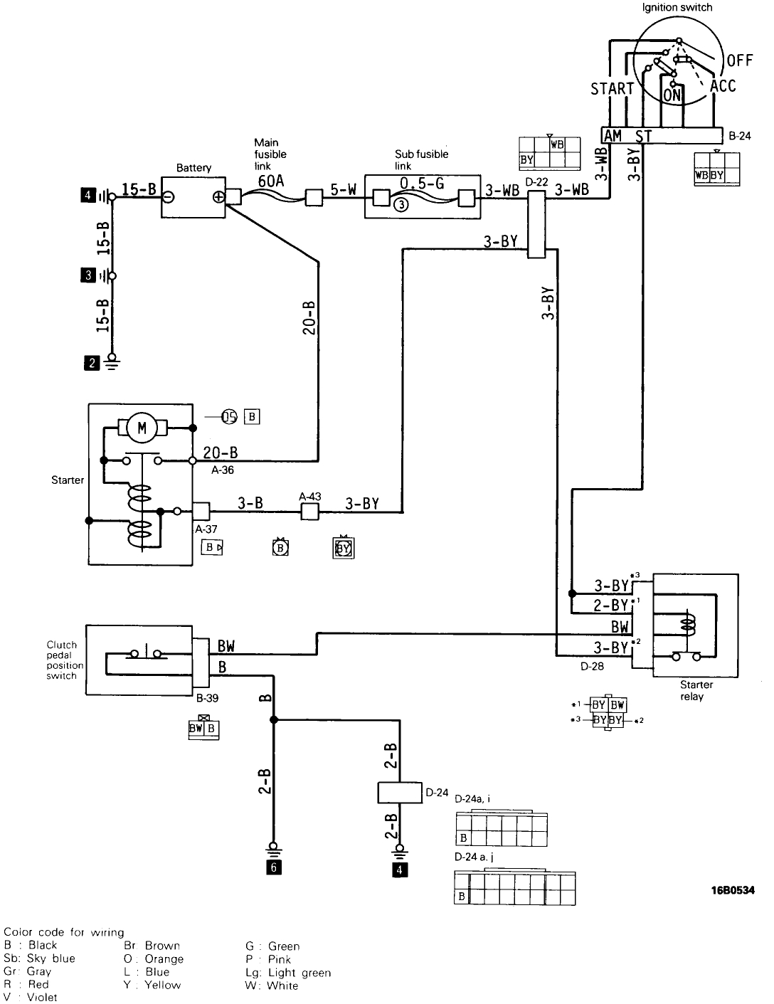

Steve you would not happen to have a wiring diagram on the clutch neutral switch for the 1995 Mitsubishi mighty Max so that I can direct wire it past the switch so I know which wires to connect?

The clutch switch is on the attached diagram. Looks like nothing but a path to ground. Black wire with a white stripe on one side of the switch that connects to a black wire that goes to ground.
I wouldn't bypass that switch though, forget just once that it's bypassed and it could cause real damage.
The biggest thing will be to make sure that whatever smoked didn't hurt something else. I've seen more than one vehicle that had a "minor" short which put it in the salvage yard because it melted the harness.

Well it happened real quick and was over with. On the smoke. As far as the clutch switch which I can't find one and it's having a problem also so I'm going to hardwire it. I'm the only one that drives it, so I know that if the clutch is not depressed it's still going to start. I've driven a standard all my life for 55 years and I'm 67 now. If I ever sell it I will try to find a switch in the meantime. It's normally open switch until you push the clutch and then it closes to start. I told my wife just to be aware of it. If the burnt wire is in the harness outside of the firewall I can take it apart and I have connectors that I can splice in new wire and then rewrap it. Thanks for your help
