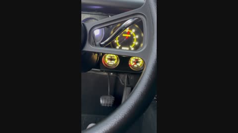

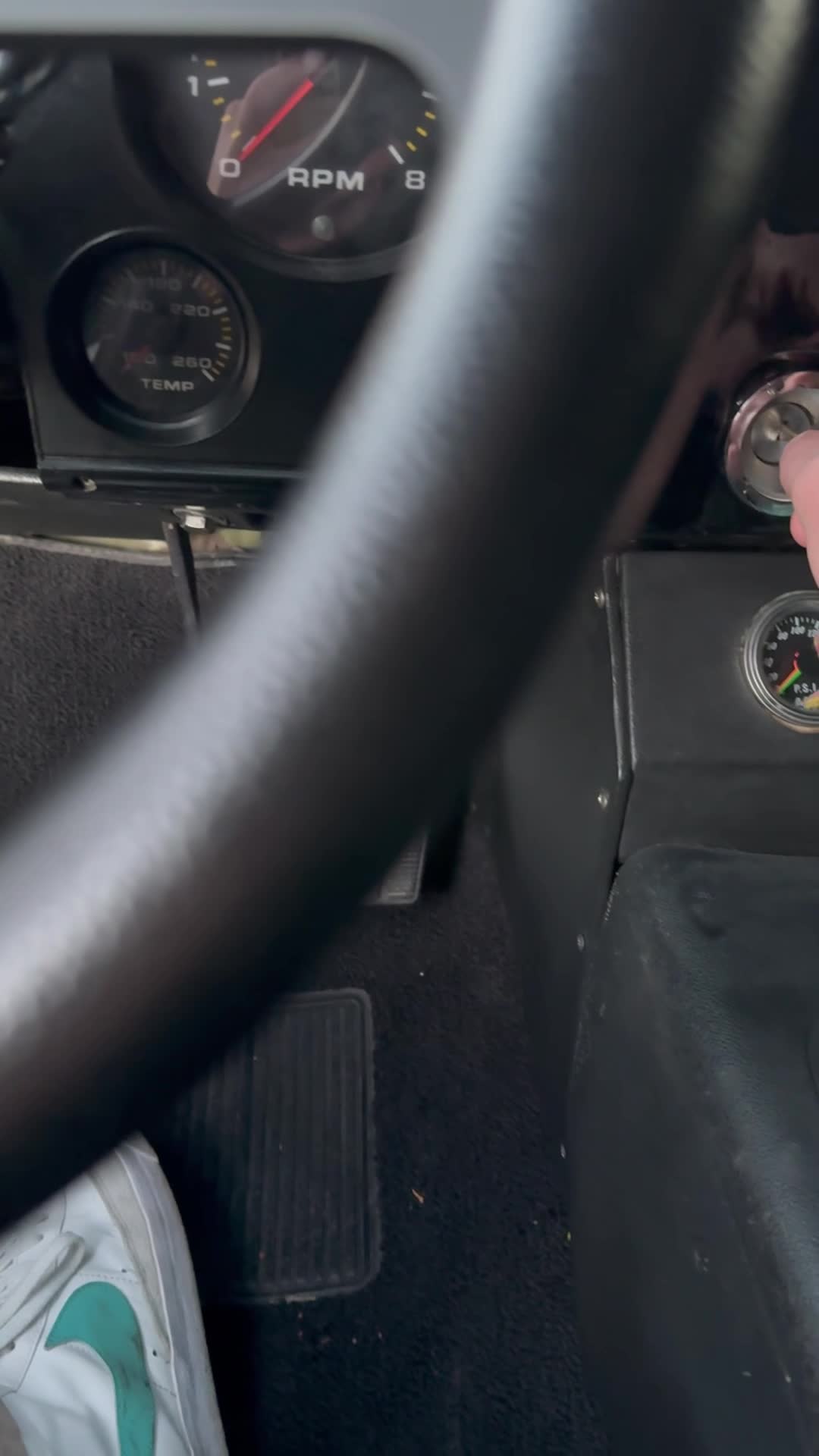

This is the video of the clicking noise when trying to start the engine.
Dec 30, 2024 at 3:03 PM
  • 54,506 POSTS
This sounds like the flex plate is broken and the starter is just spinning it without cranking the engine, or the starter is bad. I would remove the starter and then use a large prybar to see if you can move the flex plate without the engine turning. Thanks for the video, it helps. Please let me know what you find. Happy new year!
