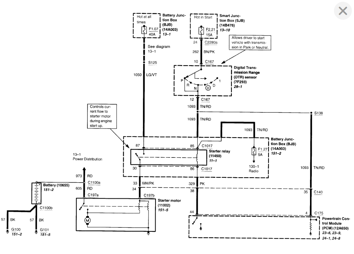

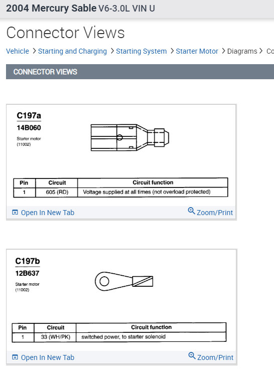

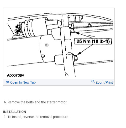

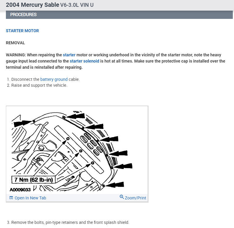

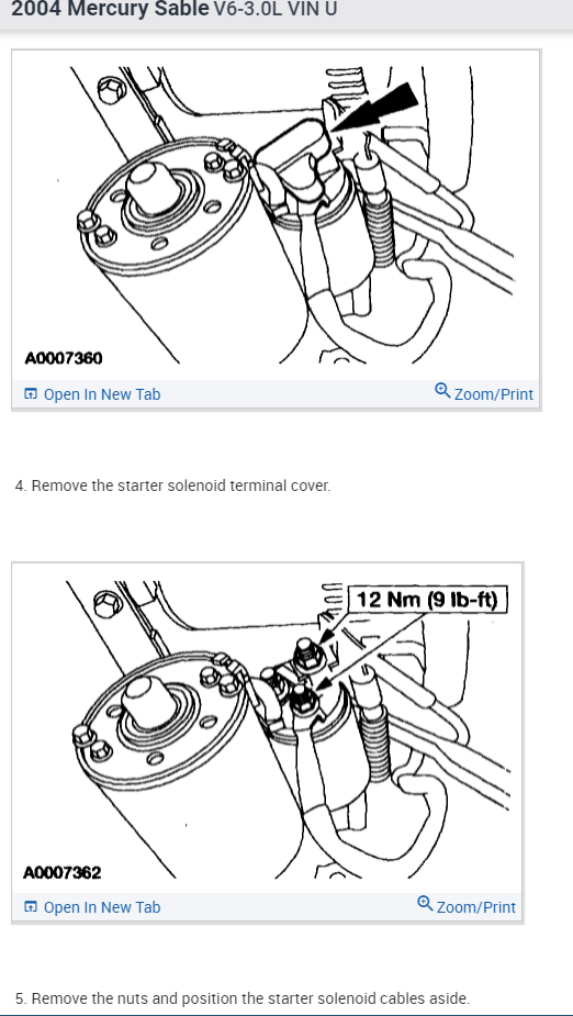

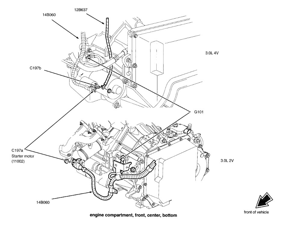

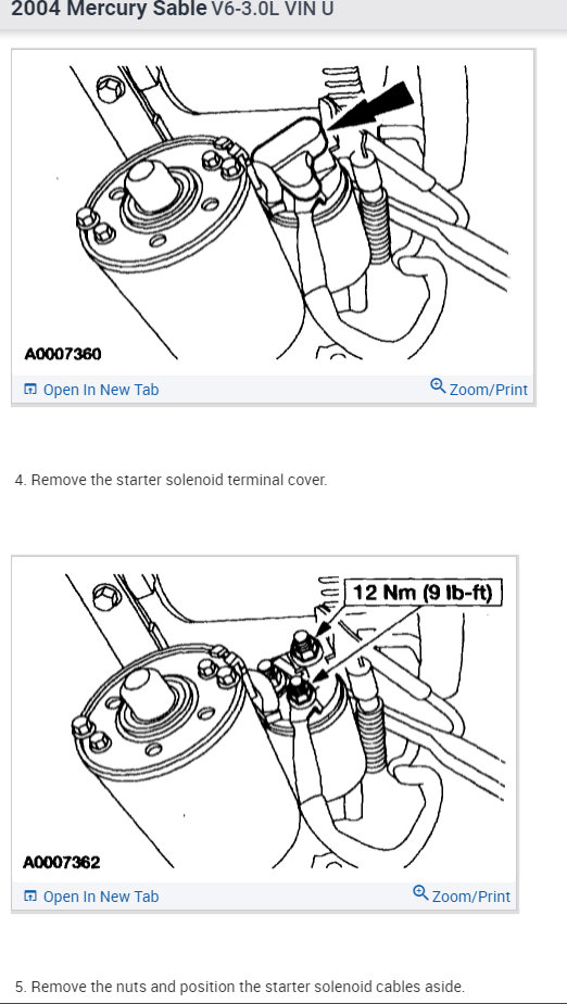

I replaced the starter on my car and didn't pay attention to how the wires get hooked back up. Need help ASAP.
Monday, December 13th, 2021 AT 11:01 AM
SQM
MECHANIC
6,383 POSTS
I have attached the starter replacement diagram below.
Also included the wiring schematics.
Let me know if you have any questions.
