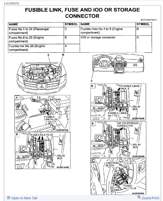

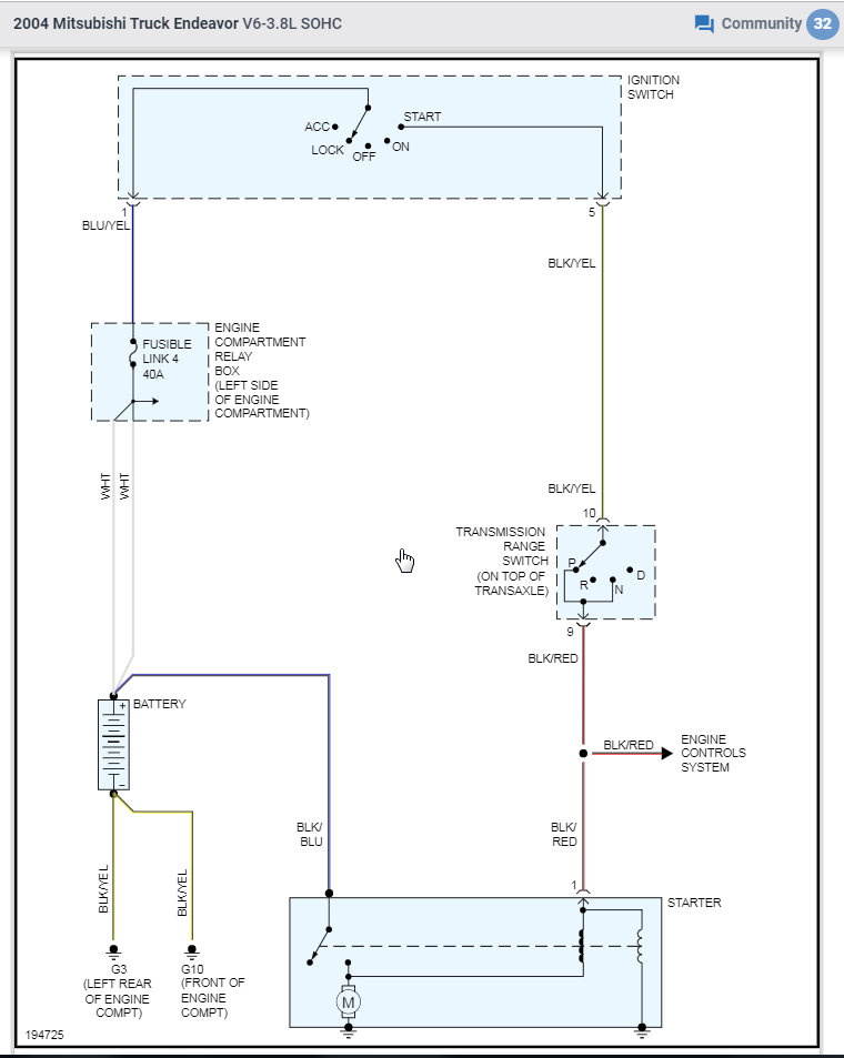

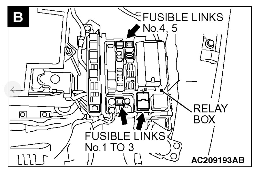

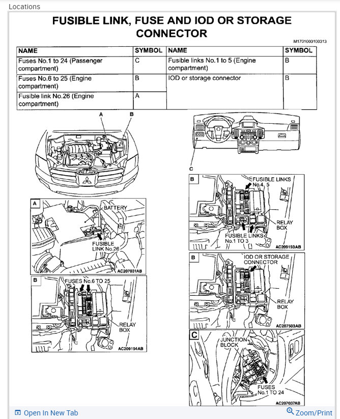

Battery is fine where is starter relay fuse?
Monday, January 13th, 2020 AT 10:14 AM
MECHANIC
18,907 POSTS
You don't have an actual relay. You have what is called a fusible link. It is a little different. Here are the diagrams and location. Let me know if you need more info. Thanks. Check out the diagrams (Below). Please let us know what happens.
