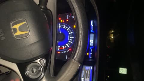

CHARLOTTE COUCH
  • 7 POSTS
I don't hear a clicking sound, but the screeching sound does feel as though the car is trying to turn over. I added a video here so you can hear the sound.
As far as I'm aware, the wires are fine, but how would I check this? Or would I need a mechanic to check? Thanks in advance!

MIKE H R
  • 3,094 POSTS
I listened to the video a couple of times. What it sounds like is that the starter is not engaging all the way. Were you able to see the starter they took out the first time? If so, how do the teeth on the starter look like they were worn down? Your post said that after they replaced the starter it worked all right for a couple of months or so. Try this, turn the car on and try to start it just for a second and see if you can hear the starter engage. Just for a second on and off with the key. Let me know what you hear.

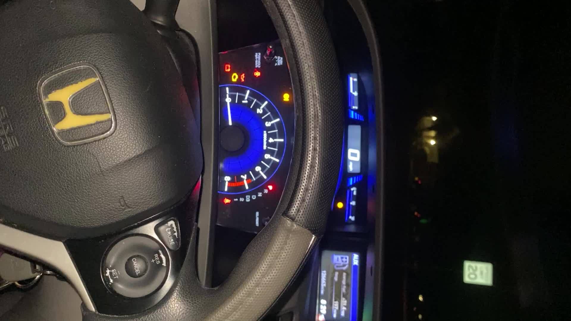

CHARLOTTE COUCH
  • 7 POSTS

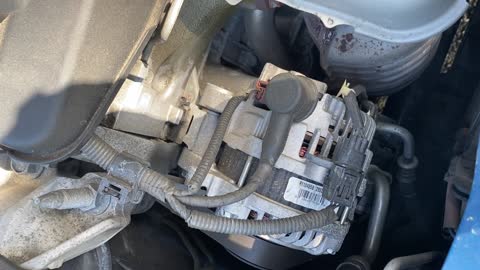

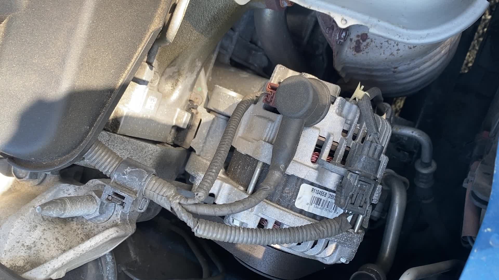

I just tried turning the car on as it was cold through the night. I let it charge in the on position like usual for about 8-10 seconds, and for the first time, it turned on no problem, yet there was a slight clapping noise right in the beginning. I got this on video, attached below. The second time, it made the screeching noise but I didn't get this on video by accident. Then tried it 3 times after that, no screeching - turned over - but still heard the same clapping noise in the beginning.
Also I didn't see the two older starter's, so not sure if it was the teeth being worn down.
It is something to note, that the car turns-over perfectly sometimes, and other's not, as if the teeth aren't catching every time. I noticed a trend with the screeching happening more when I would drive around time doing multiple short trips. Longer trips like on the highway and then stopping for gas didn't have an issue.

MIKE H R
  • 3,094 POSTS
Just for my information could you have the battery checked? With short trips sometimes a weak battery will not recharge completely. You said that on long trips it works okay.
