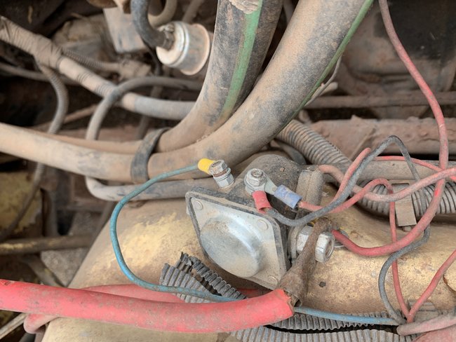

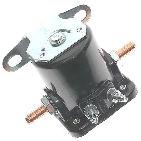

How about a pic of your solenoid so I can see the wires on it (see my pic 1).

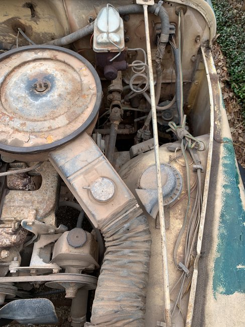

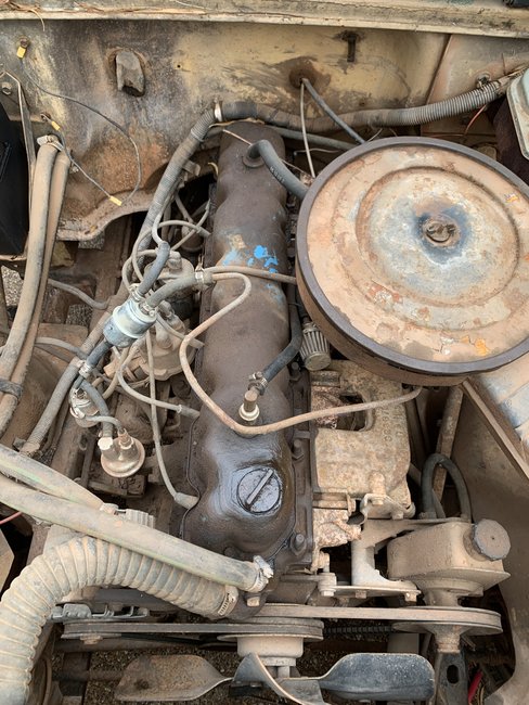

Okay, so here is a bunch of pictures of what I am dealing with.
Tuesday, January 14th, 2020 AT 8:11 AM
CJ MEDEVAC
  • 11,004 POSTS
Try them pics again! They did not show. The medic

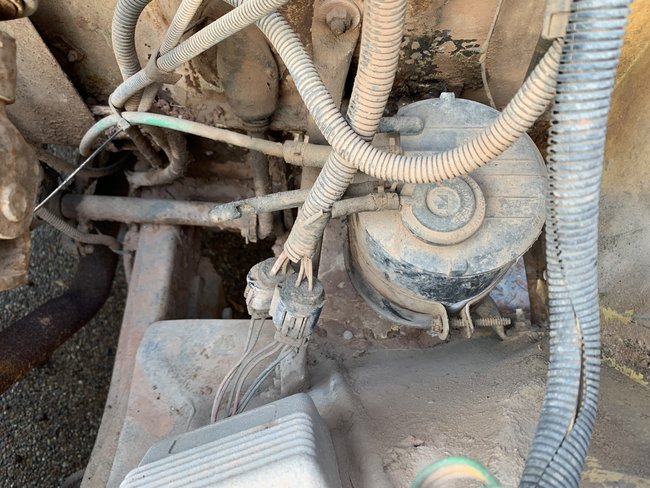

I want a few more pics!
Things are not real bad under the hood, there are a few things that need a little attention or replacement, nothing extreme so far.
Pics I want:
Drivers side around the canister (around/ below the master cylinder).
Take the breather off, shoot some pics around the carburetor.
Area below the battery.
When I get them all, I will point to and label the pics with the problems I see. Like I said, I see nothing really awful, however, fixing the stuff will make it run better.
Does your Jeep have a winch? (Seeing the big battery cables at the solenoid area)
What has happened with the fuel introduced down the carburetor throat?
The Medic

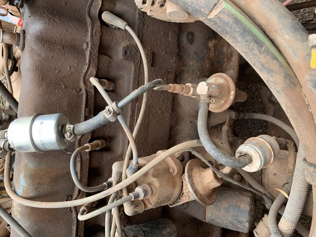

Okay, so it took a few times adding fuel and trying to start and on about the third time we got it to really start up, but it wouldn't stay running. Then the battery died! So hooked up my jumper cables and got it to start again (with adding gas directly) and then it just runs out of gas. Took off the fuel line and started it with more gas down the carburetor and no fuel shoots out the line. So seems like it's not getting any gas. An odd occurrence noted as well was every time it fired up a ton of dirty watery gunk blew out the back exhaust. Didn't know if that meant anything. It doesn't have any leak spots on the concrete under it so don't think there is any leaks. I also noticed the hose for the heater has been cut and closed so Brrr. And yes it has a winch on the front.

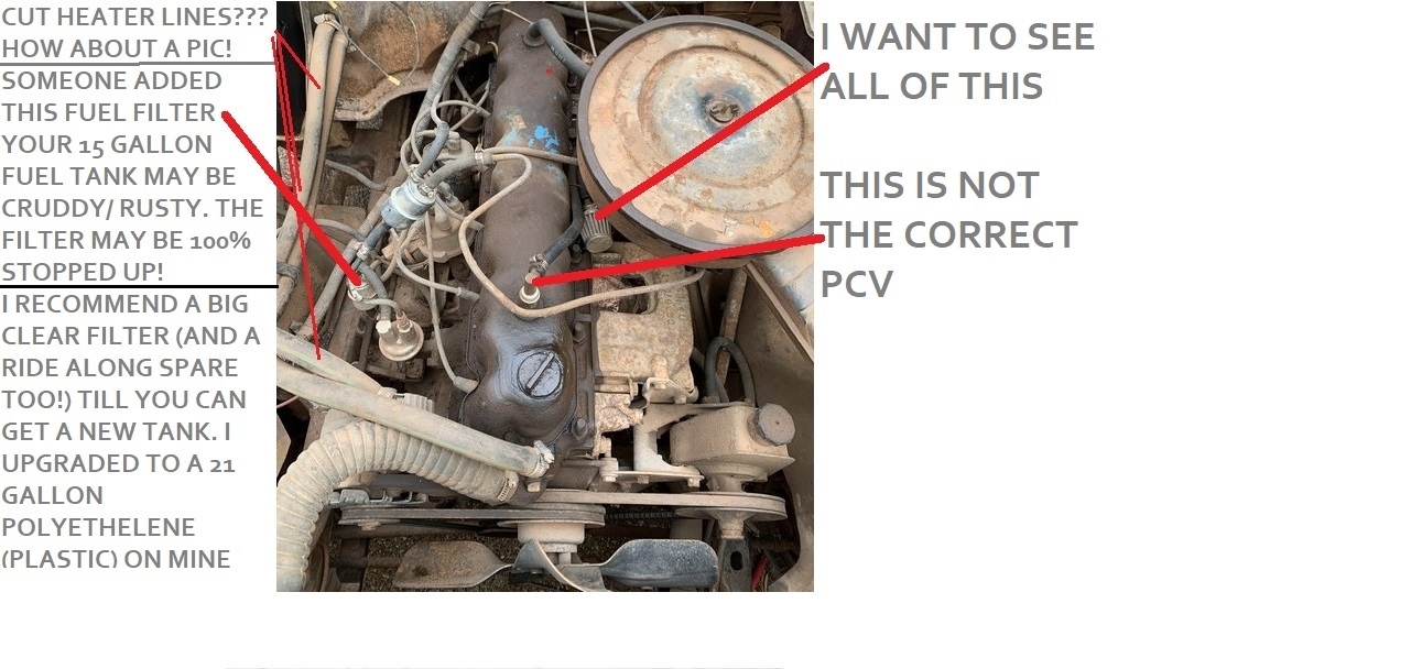

Got you a 1st pic to start on.
The filter before the fuel pump has been added on.
You may need to keep it, if the tank is bad off. Get the largest one you can and make it a "clear" one so you can see when it's full of crap.
Keeping a spare one or two on board may keep you from walking!
Pic 3) Check out that long range 21 gallon tank. (Plastic tanks are available in 15 gallon too)
The Medic

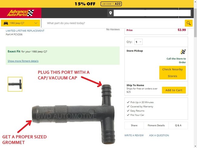

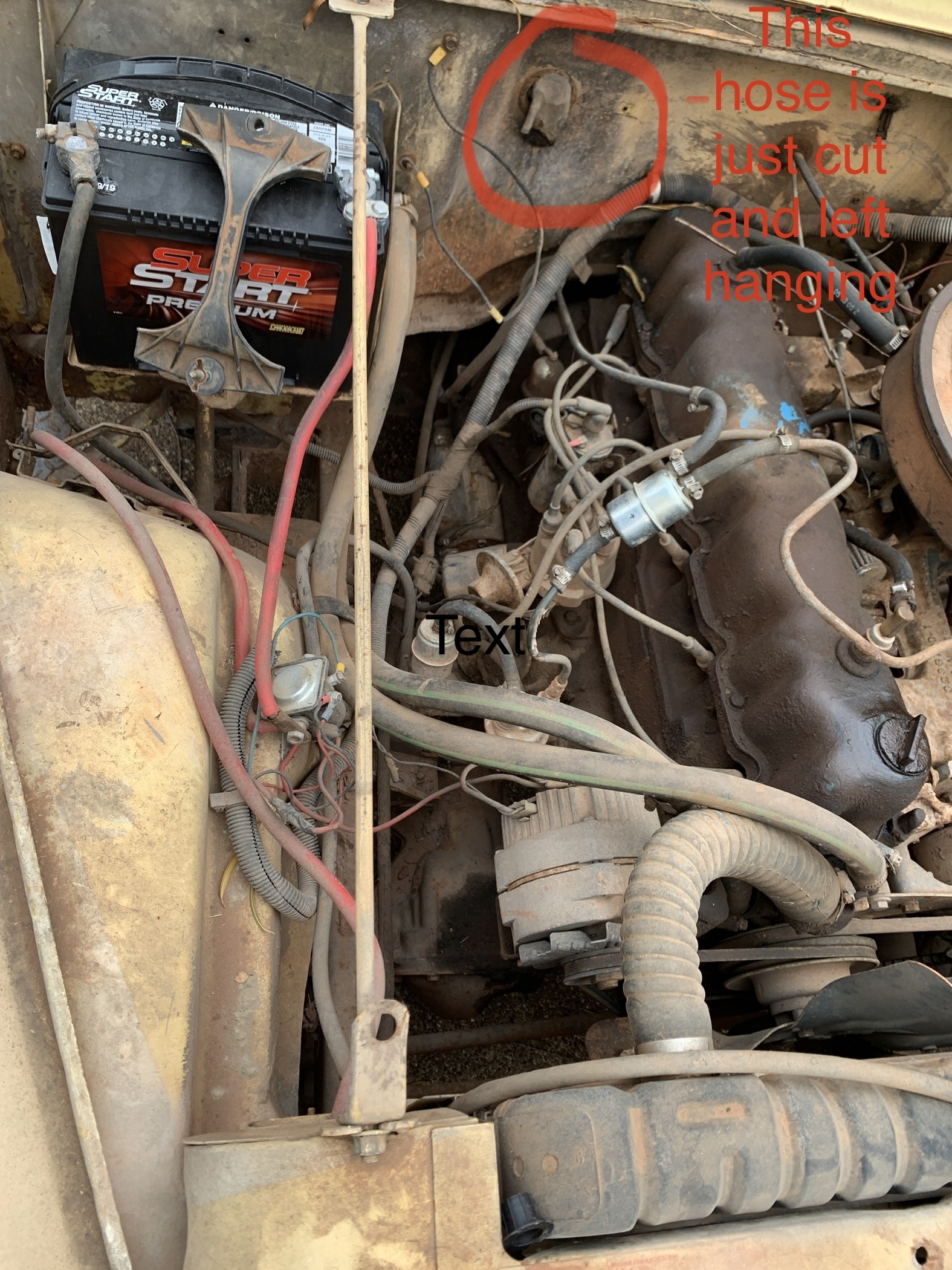

I'll see if I can check the fuel filter tomorrow and get more pictures of things you requested. This picture shows where there is just a hose that was cut and left hanging. I thought it was maybe what brought heat in since we were told there was no heat.
Tuesday, January 14th, 2020 AT 8:56 PM
CJ MEDEVAC
  • 11,004 POSTS

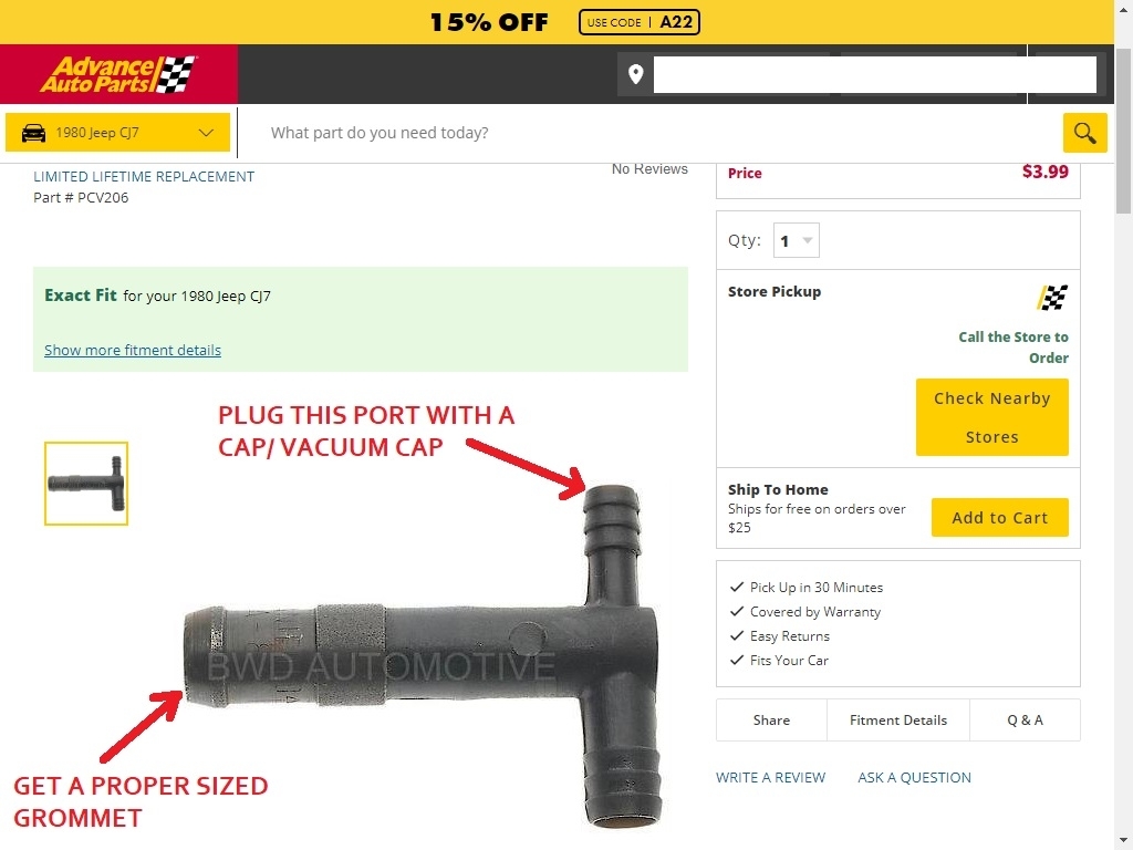

That would be the drain hose for the "air box" (cowl vent drain).
I found a place that has the hose and the "Duckbill" that goes on the bottom of it. (See pic)

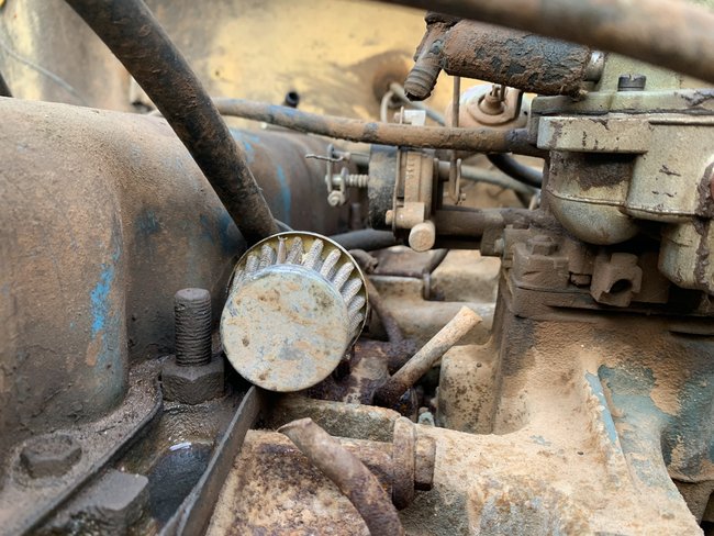

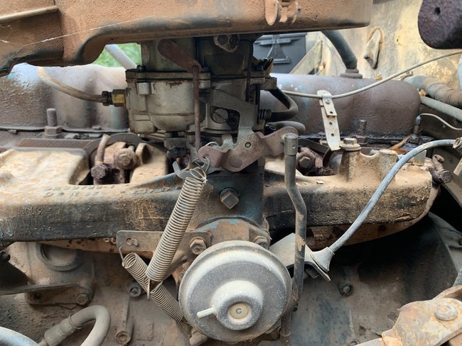

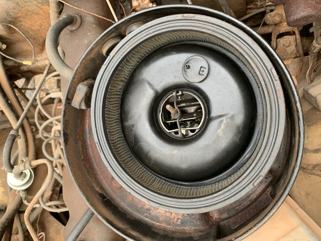

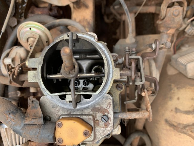

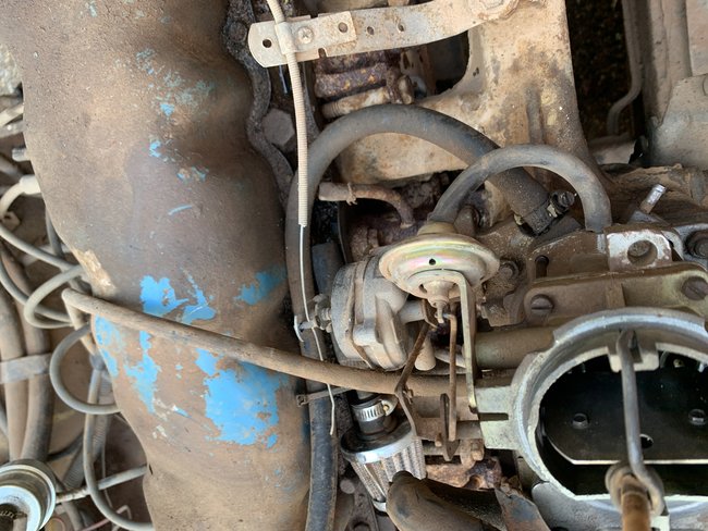

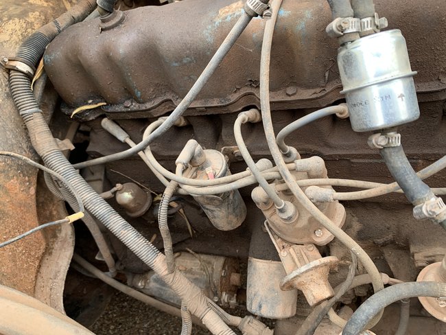

Here’s the breather off pic and some others around the carburetor and under the battery. Haven’t had a chance to look for a new filter that’s up next.
Wednesday, January 15th, 2020 AT 5:13 PM
CJ MEDEVAC
  • 11,004 POSTS

So I broke down and took it to a reputable mechanic. The fuel pump was the issue they said. They also said though that the choke is not working properly and that it was not the right set up with the carburetor. He said we need to get a new carburetor if we want to be able to start it without getting under the hood every time. I questioned him if we couldn't just replace the choke and he said it didn't work that way. Does that sound right?

Your carburetor (the Carter BBD) is a great system!
However,
The carburetor is 40 years old, it has 40 years of wear on many of the parts.
Even buying a re-manufactured carburetor may still leave you with worn parts reused with in it.
There are some tedious adjustments that need to be made, sometimes the re-builder does not make these "tweaks" to the re-manufactured.
The average Joe with limited knowledge will build it wrong or damage a part without knowing it.
I'm almost embarrassed to make this suggestion, I have suggested this many times and so far, have always gotten good results (with local Jeeps)(With 2carpros forum fixes).
Seems that the Jeep Carter BBD carburetor is not made domestically anymore, re-manufactured's are about all that are available. And you still have an "old" carburetor!
Over the pond, they are making new ones! They work great! They adjust as they should!
It's been a while since they hit the market, they have gone up in price a little. They are still way cheaper than a re-manufactured, but just a little more than a rebuild kit. It's ready to go!
If you go this route, I will be glad to aid with installing it and tuning the Jeep properly!

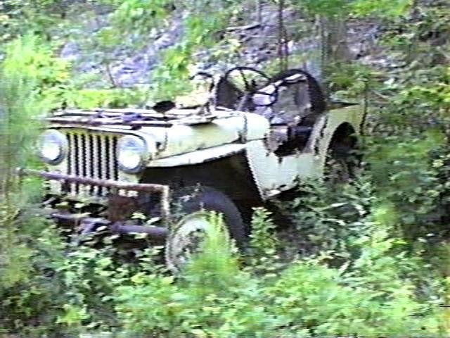

Pic 1) My '46 Willys ("Willy") in 1991, Neglected forever in a field, purchased for $100

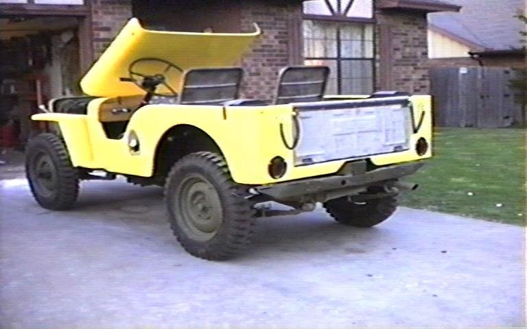

Pic 2-4) Lots of side jobs and 2 years later, roadworthy but not quite exactly what I want.
