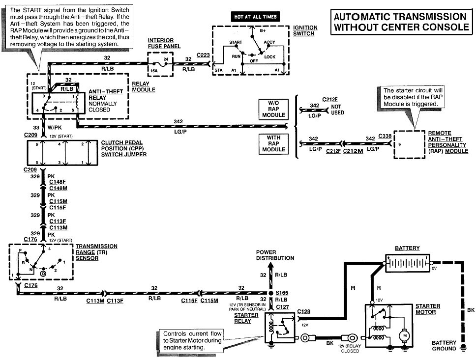

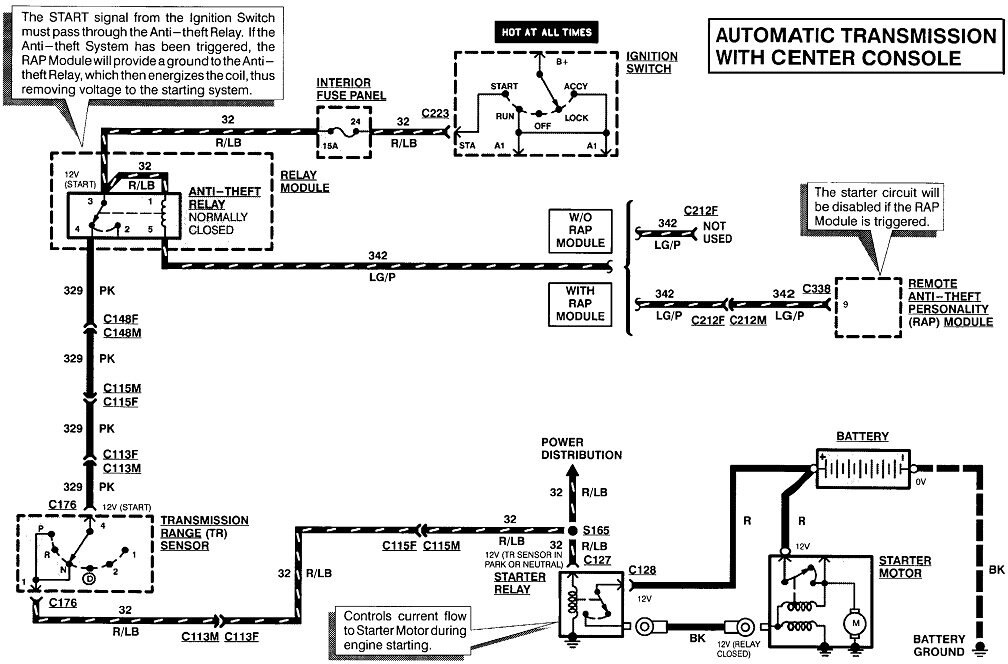

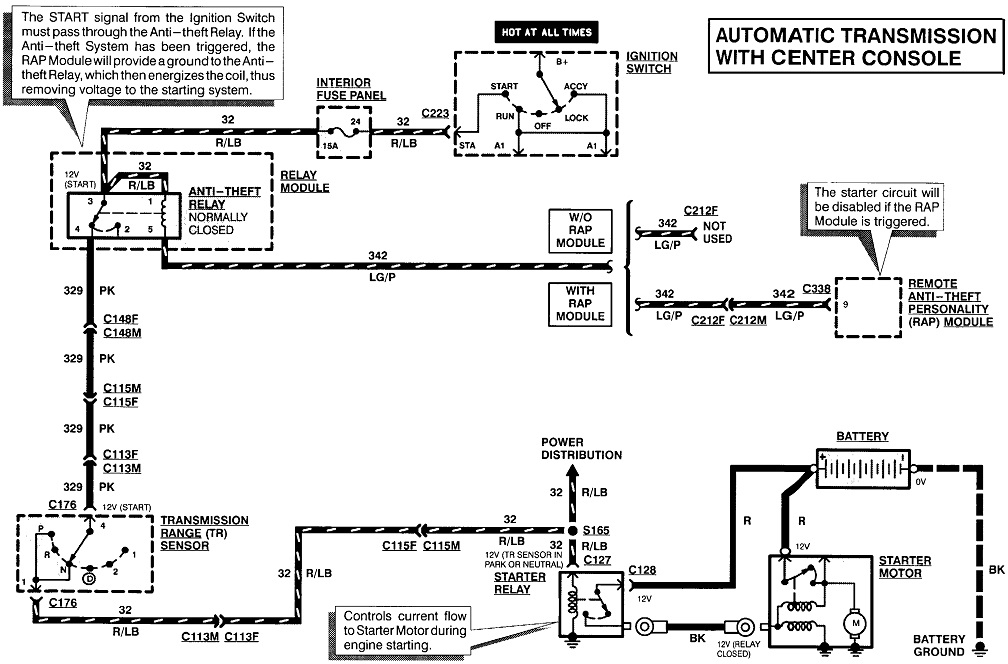

Not sure if relay is bad or just the starter?
Tuesday, November 26th, 2024 AT 6:12 PM
2 Replies
CARADIODOC
MECHANIC
34,489 POSTS
What's the question / problem / symptoms? What have you done so far? Any details or observations?

If you follow this guide and can tell you if the starter is bad or not. This will help you see if the starter trigger wire is getting power.
Please go over this guide and get back to us
