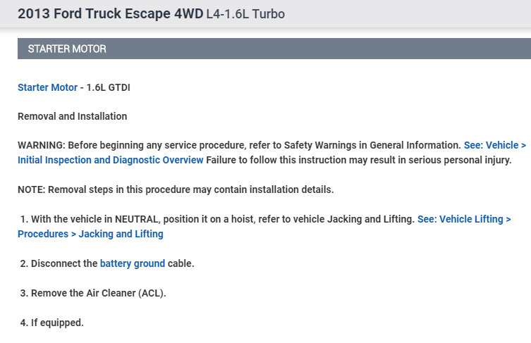

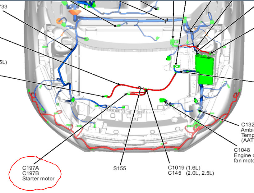

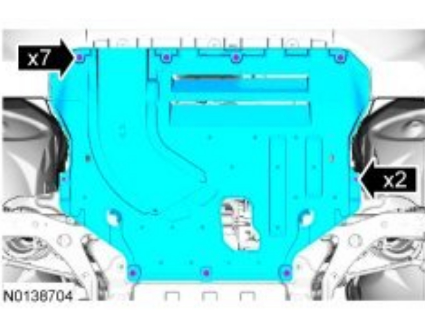

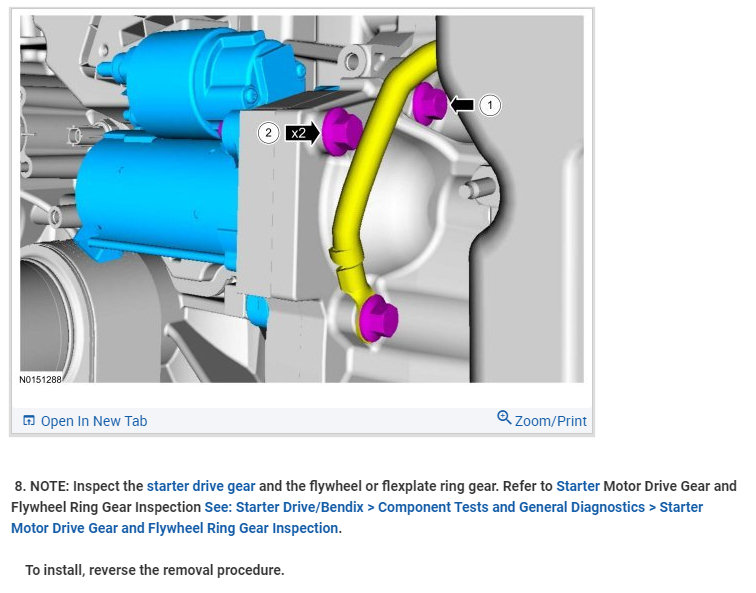

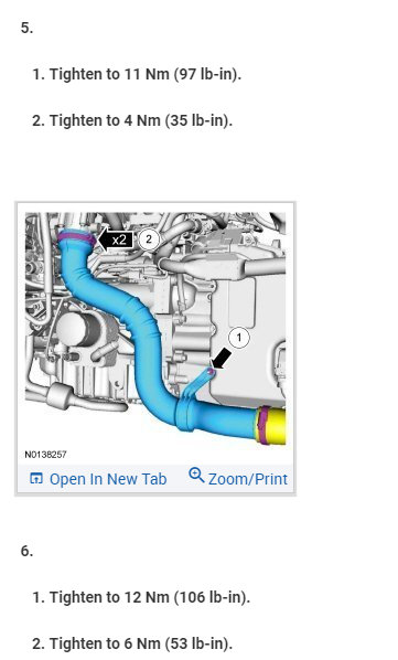

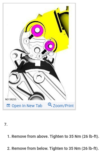

It is located at the lower middle front of the engine. Here is a tutorial showing what is involved to remove/replace a starter motor:
I've attached picture instructions below of its location and how to remove/replace.Hope this helps and thanks for using 2CarPros.
