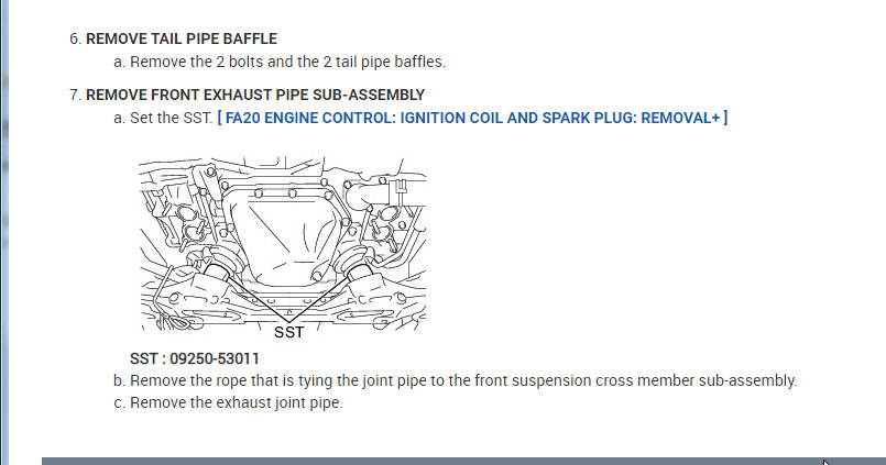

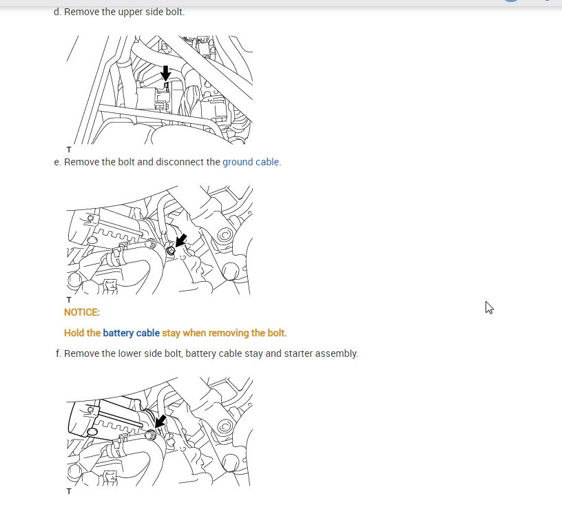

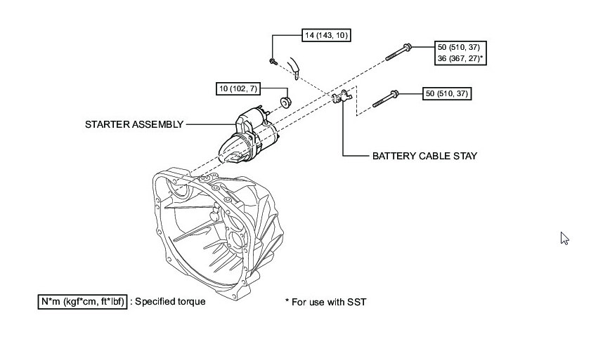

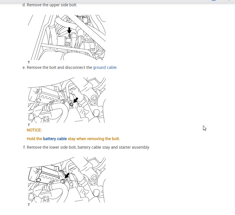

How do I change the starter?
Nov 14, 2020 at 3:56 PM
  • CAR REPAIR CONTRIBUTOR

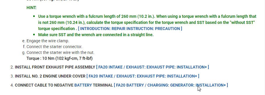

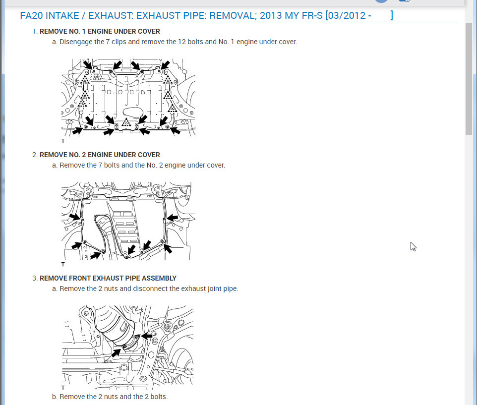

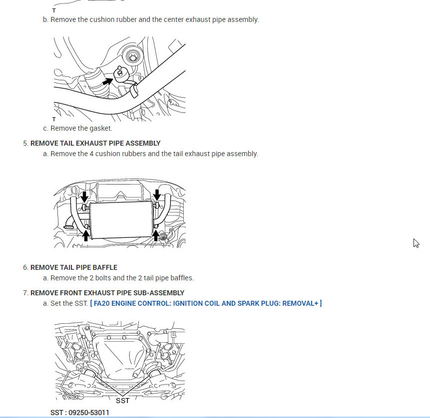

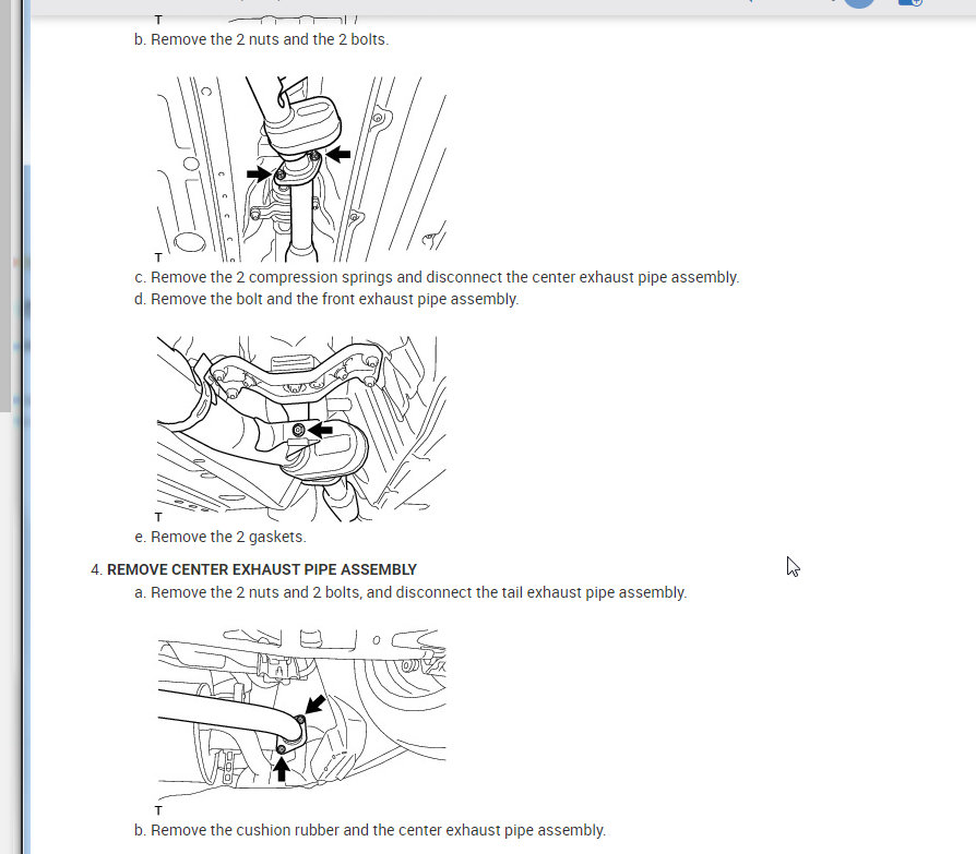

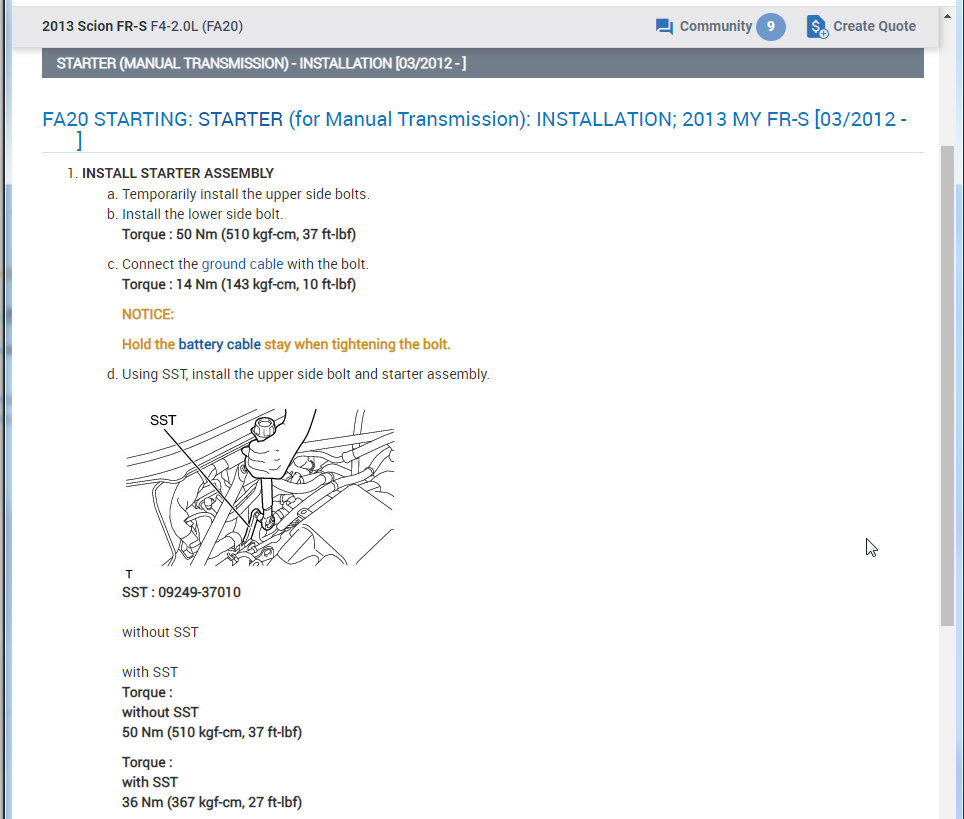

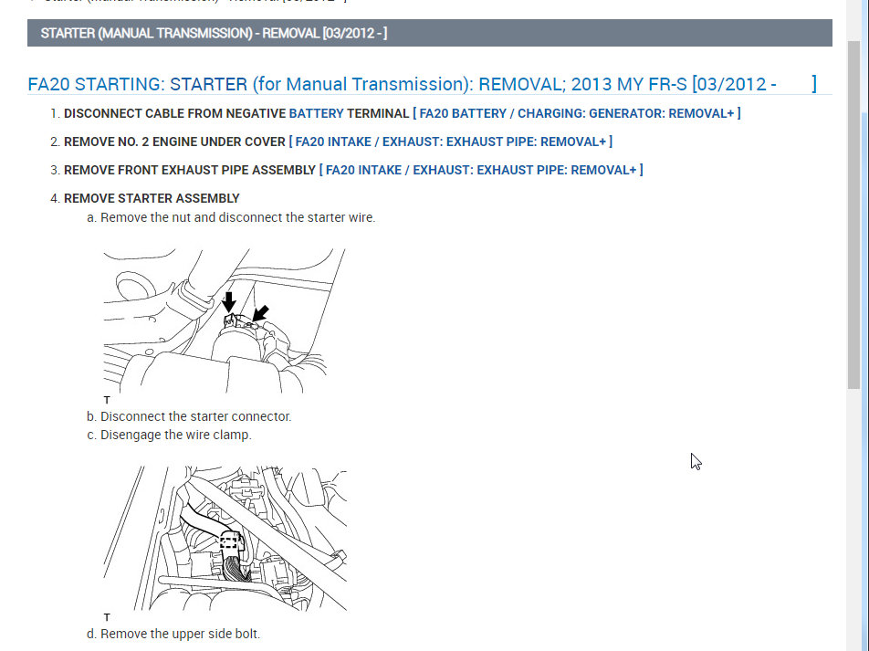

Here is the process from the manual for removing and installing it. Also, I attached the process for the exhaust pipe as that is needed to be removed as well.
Let us know if you have other questions and we can get you that info as well.
