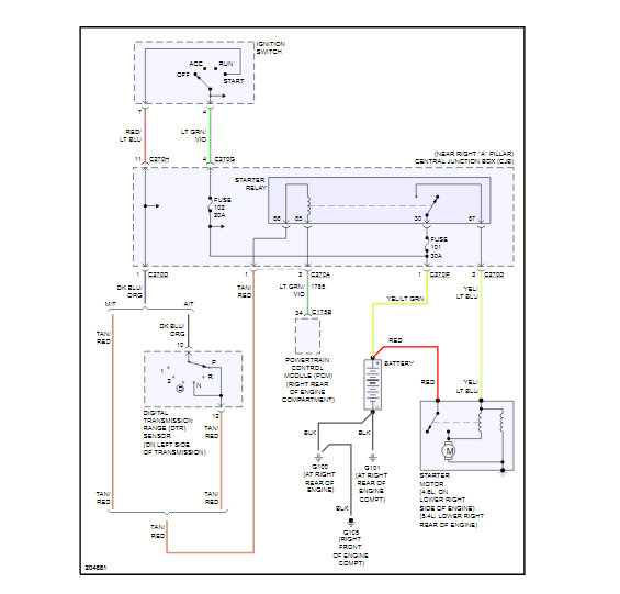

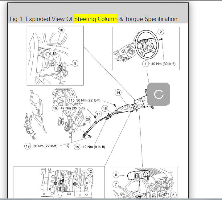

Last night I accidentally tried to start the truck with the wrong key and then it broke off when I tried to remove it. I got the broken piece out of the switch, but now the starter doesn’t turn when I try to start. The battery is good and I noticed that the gauge doesn’t drop when I have the key in the start position. What have I done and how do I fix it?
Aug 4, 2019 at 9:55 AM
SCGRANTURISMO
  • CAR REPAIR CONTRIBUTOR
  • 4,897 POSTS

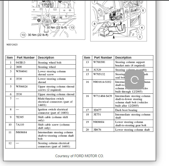

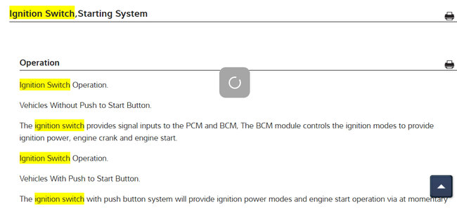

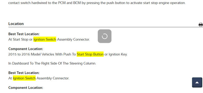

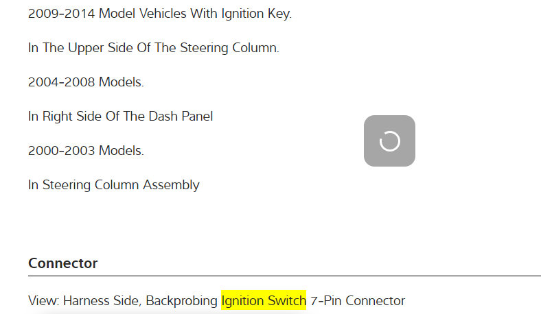

You have probably damaged the ignition switch lock cylinder which is not allowing the contacts to come into contact on the ignition switch. The problem is that if you replace the ignition switch lock cylinder with new keys the keys will have to be programmed to the Power-train Control Module. This can only be done at the dealership or a locksmith. There is another possibility, the ignition lock cylinder is attached to a plastic arm that gets pushed as the ignition key is turned and moves the ignition switch into position. This plastic arm could have been broken when you broke the key off in the lock cylinder or when getting it out. In the diagrams down below I have included an exploded diagram of the ignition system and factory testing of it. Please go through these guides and get back to us with what you are able to find out.

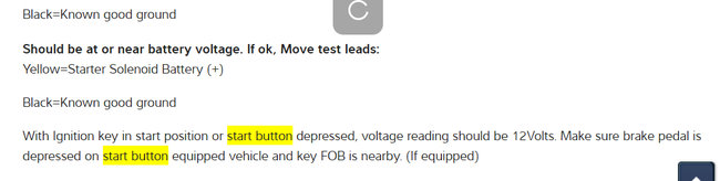

Now this. Resting without key in the ignition, my tester shows 9+ volts on hot cable at starter. Insert key and turn to RUN position and it shows 12+ volts. Continue into START position and voltage drops back to 9+. This has me baffled. I was a bodyman for 25 years and have dealt with plenty of collision related gremlins, but this has me beat. My instinct tells me it’s the lock cylinder/security system.

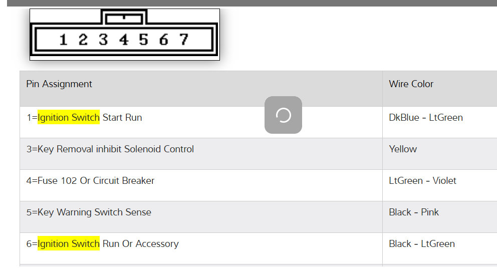

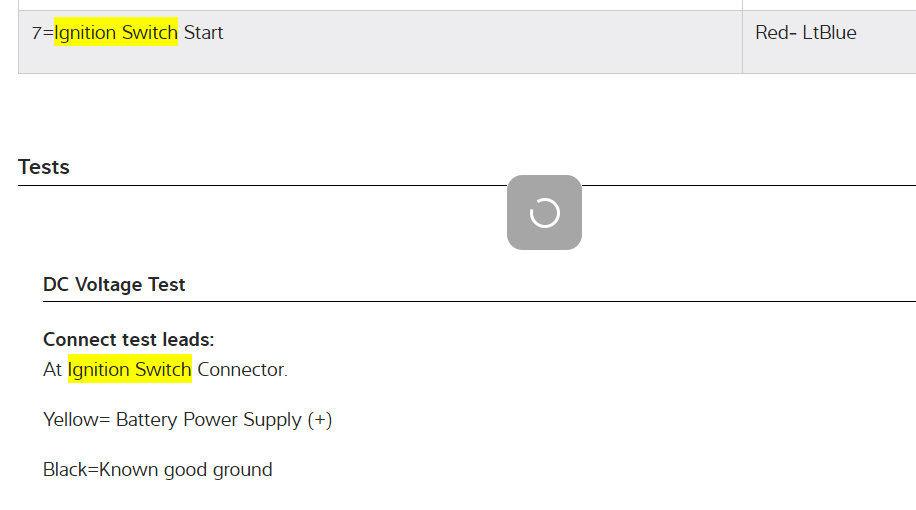

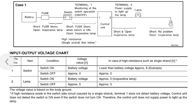

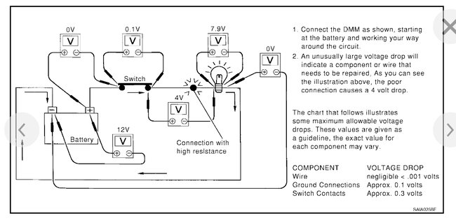

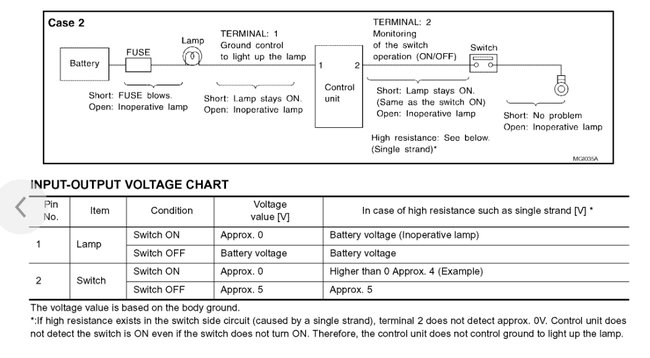

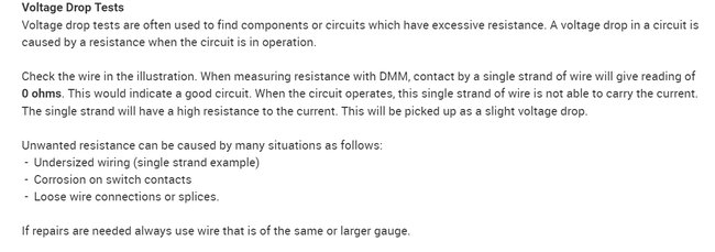

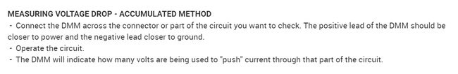

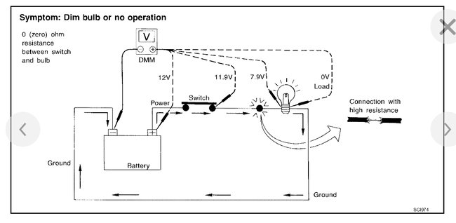

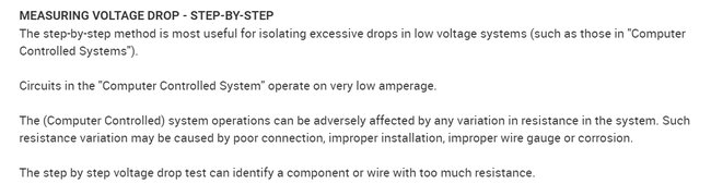

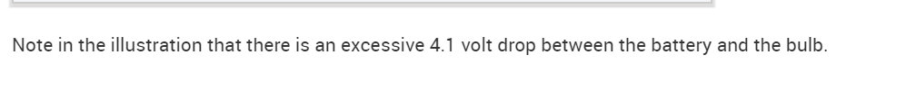

You have unwanted resistance in the starting circuit somewhere that is taking 3 Volts (Electrical Pressure-Much like P.S.I. in a hose) to overcome for the currant to reach the starter. My thoughts would be in the ignition lock cylinder, since it has 1/2 of a key broken off in it, but I could be wrong. In the diagrams down below I have included a wiring diagram of your vehicle's starting system and a guide that explains how to find unwanted resistance in a circuit using the voltage drop method, which is the preferred method to use. Please go through these guides and get back to us with what you are able to find out.

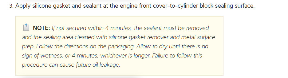

Sorry to here about that. If you want a guide on how to replace your vehicle's oil pump and pickup tube we have that for you. Have you check the engine oil level on the dipstick? Let us know if you want the directions or not. We are here to help.
Thanks,
Alex
2CarPros
Aug 6, 2019 at 3:42 PM
CHRIS CARBAUGH
  • 9 POSTS
I would certainly appreciate any ideas! As a retired body-man, I know enough to handle collision related mechanics, and I build my engines for my older cars trucks and bikes. This thing is simply over my head. So, the first start after replacing starter was normal but took quite a while for pressure to kick in. (As long as I’ve owned it, this has never happened, but there has always been chatter from the top end.) once it built pressure, it idled smoothly and sounded fine. Then a strange “grinding or crunching” cane up and then “ding”, then “check gauges” in the info center, followed by a total loss of pressure at the gauge, followed by audible loss of pressure. I tried a few more times, before giving up. The grinding sound comes in after about 10 seconds of smooth, quiet idle. After this sound stops it’s a matter 2-3 seconds before pressure loss. I’m stumped.

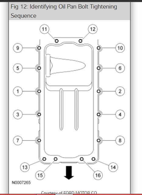

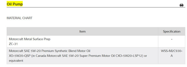

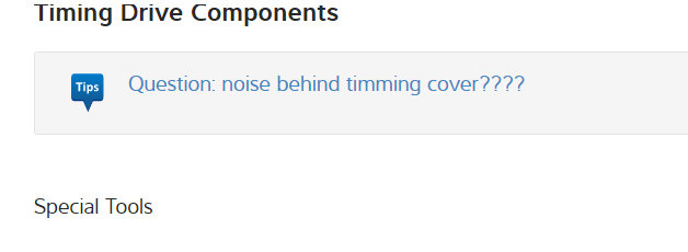

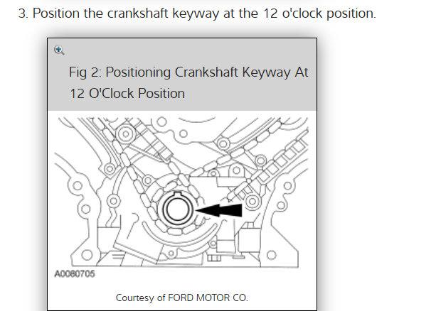

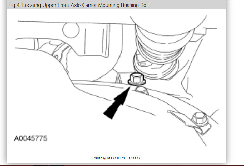

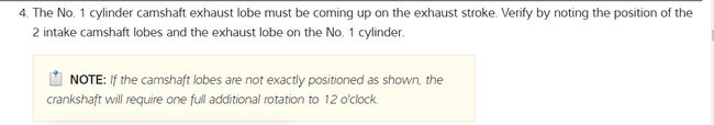

SCGRANTURISMO
  • 4,897 POSTS
Hello again,

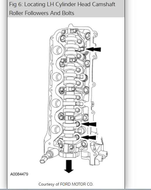

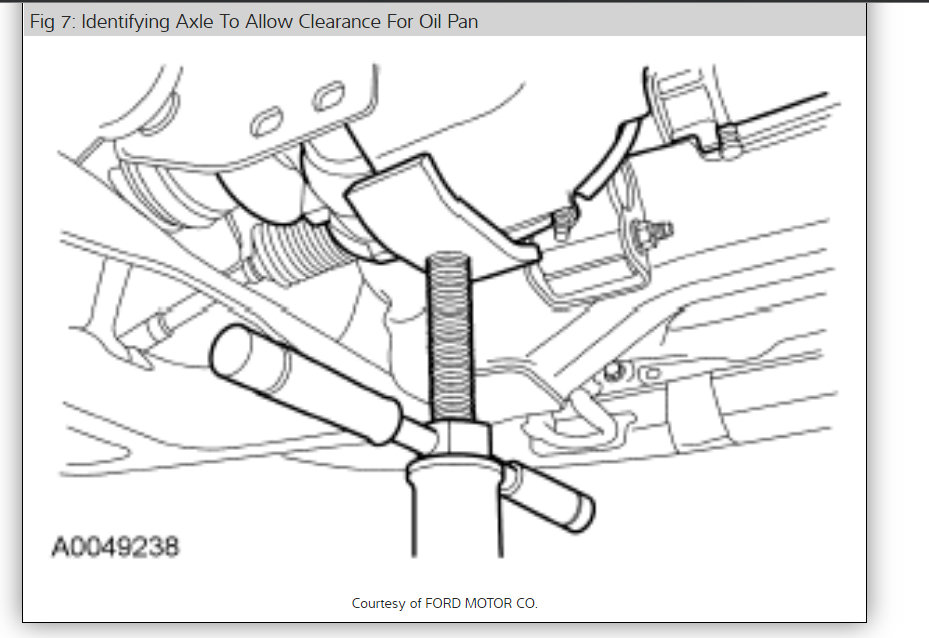

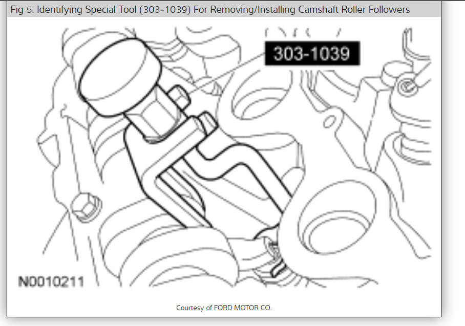

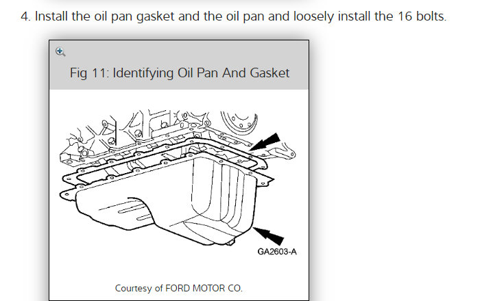

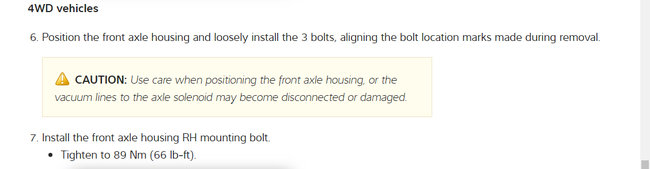

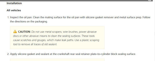

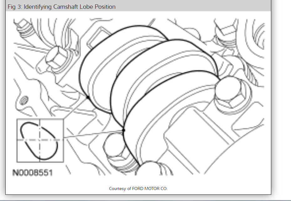

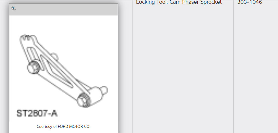

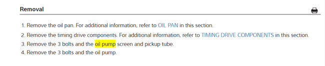

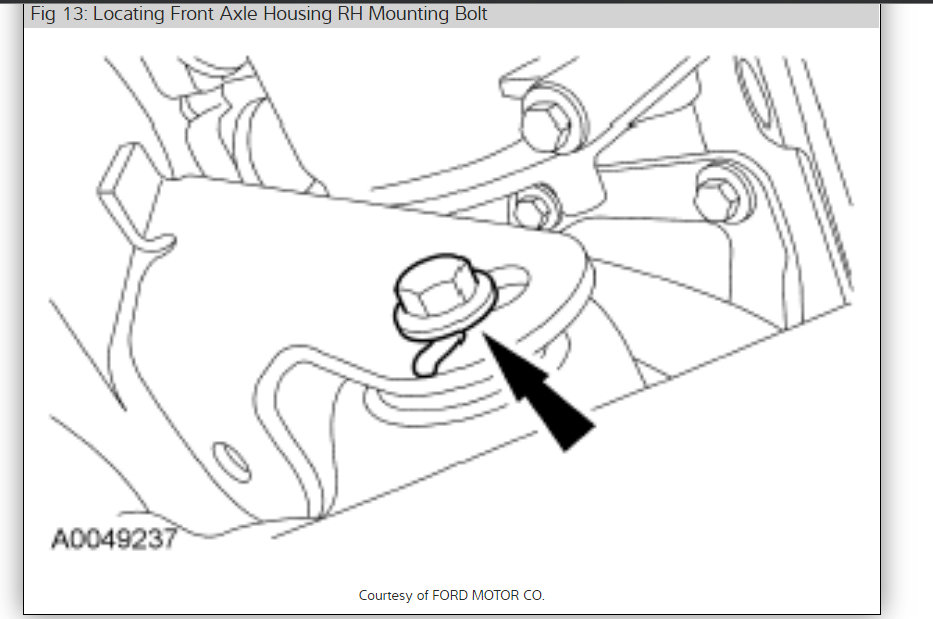

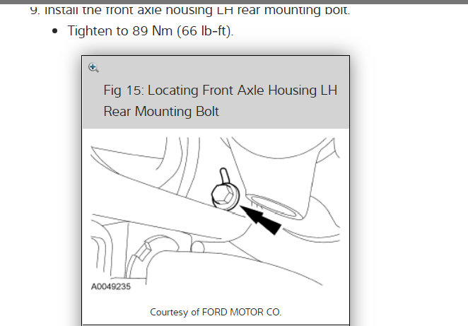

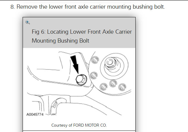

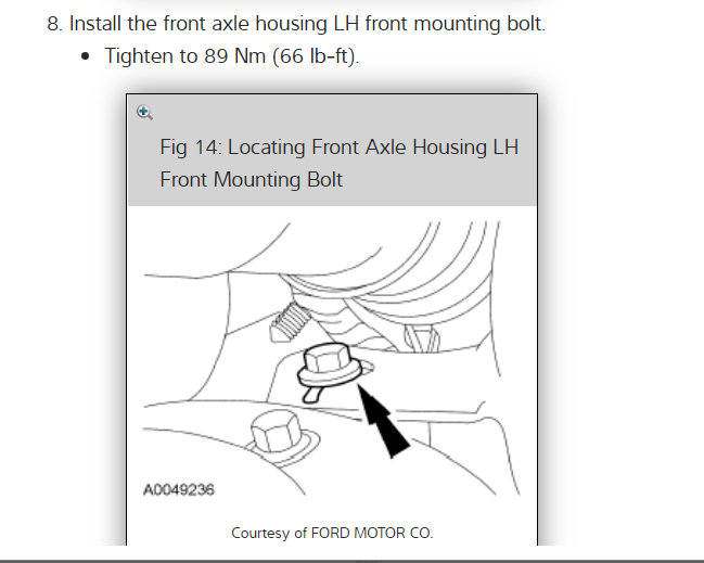

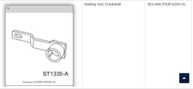

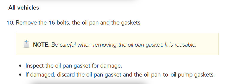

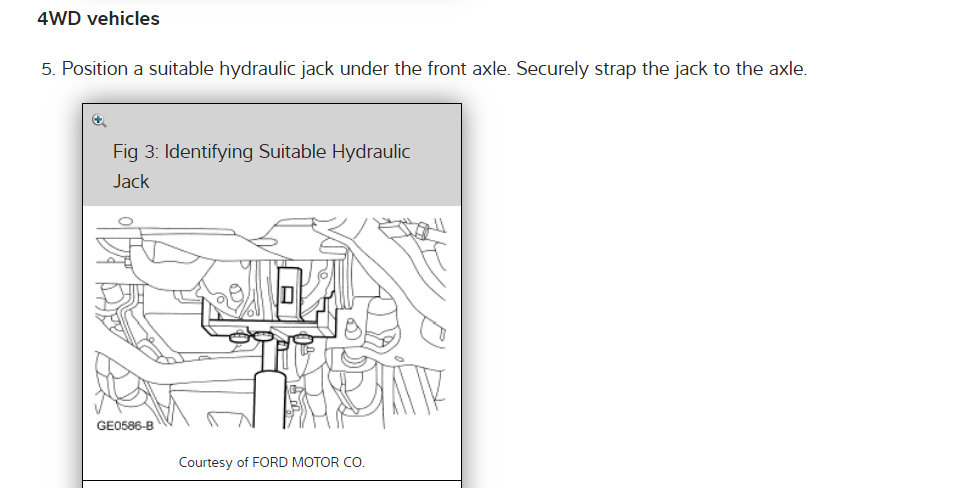

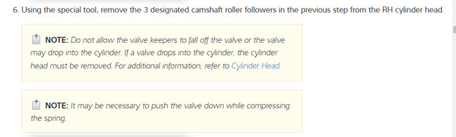

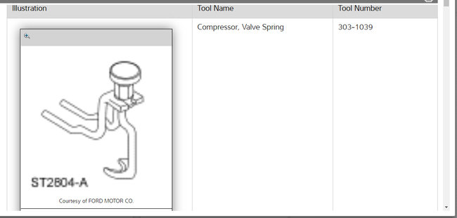

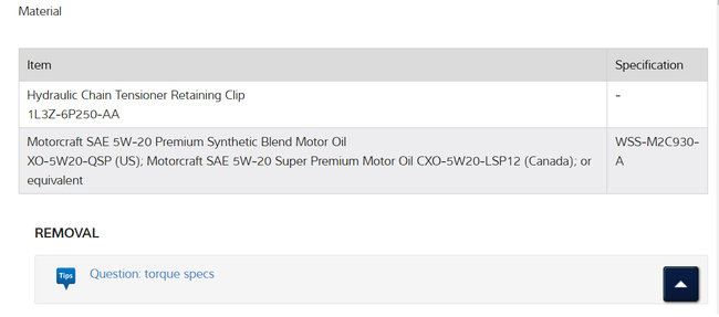

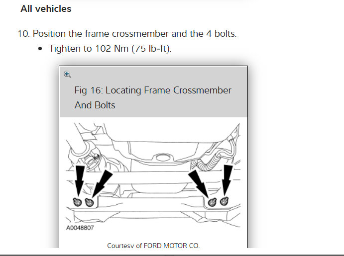

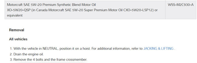

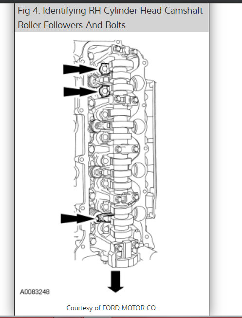

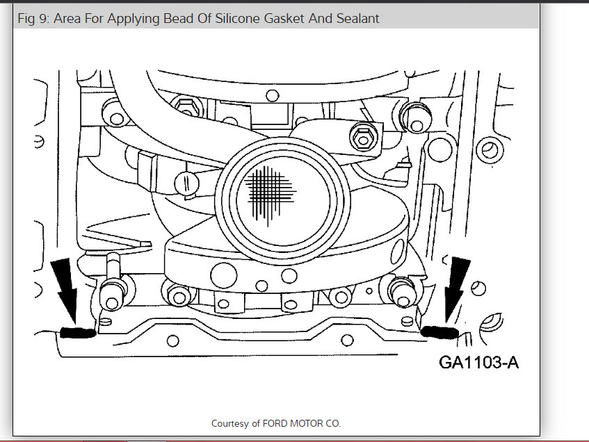

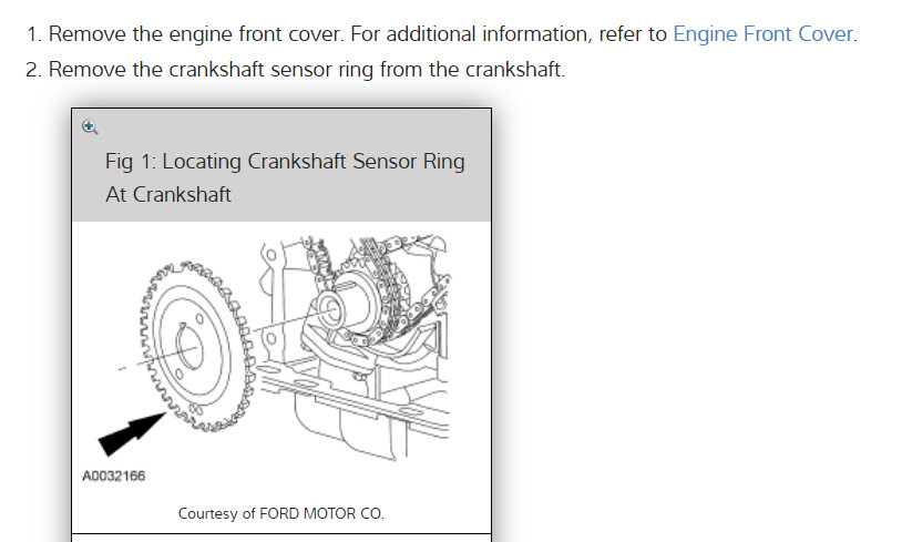

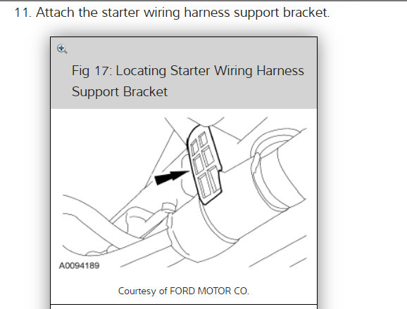

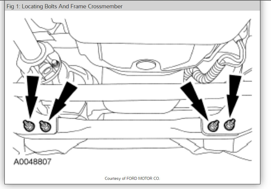

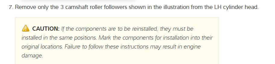

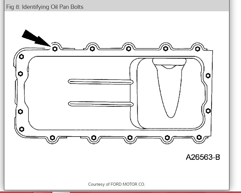

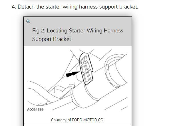

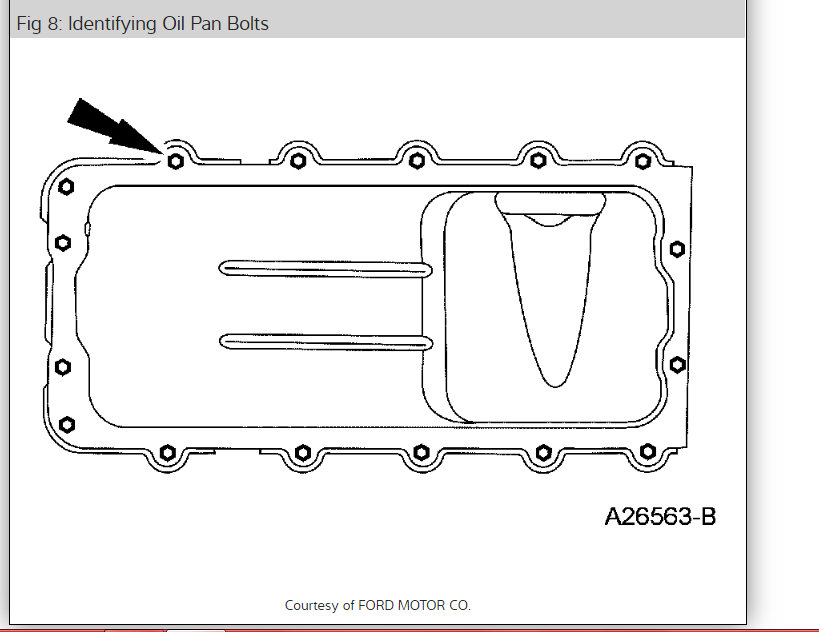

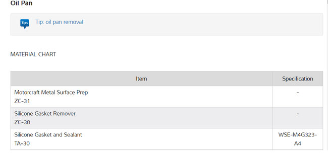

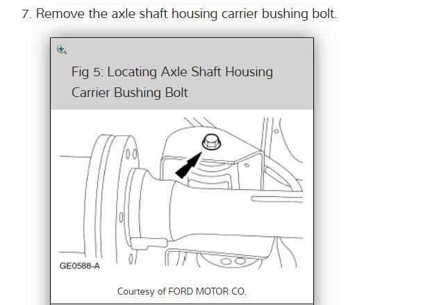

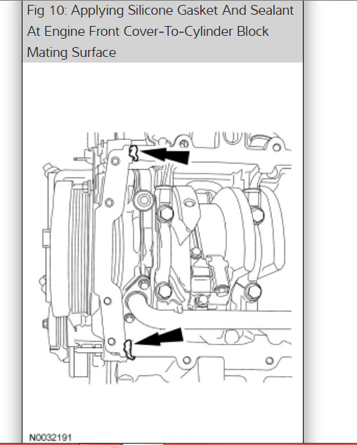

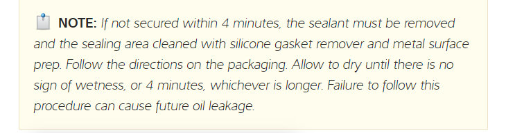

In the diagrams down below I have included the first set of diagrams for the removal and installation of your vehicle's oil pump and pick up tube. I will send the other set seperate in a little bit. There are a lot of steps.
Thanks,
Alex
2CarPros
