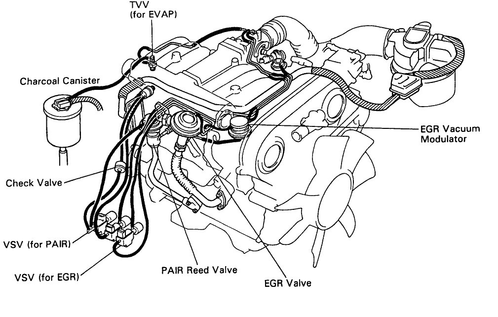

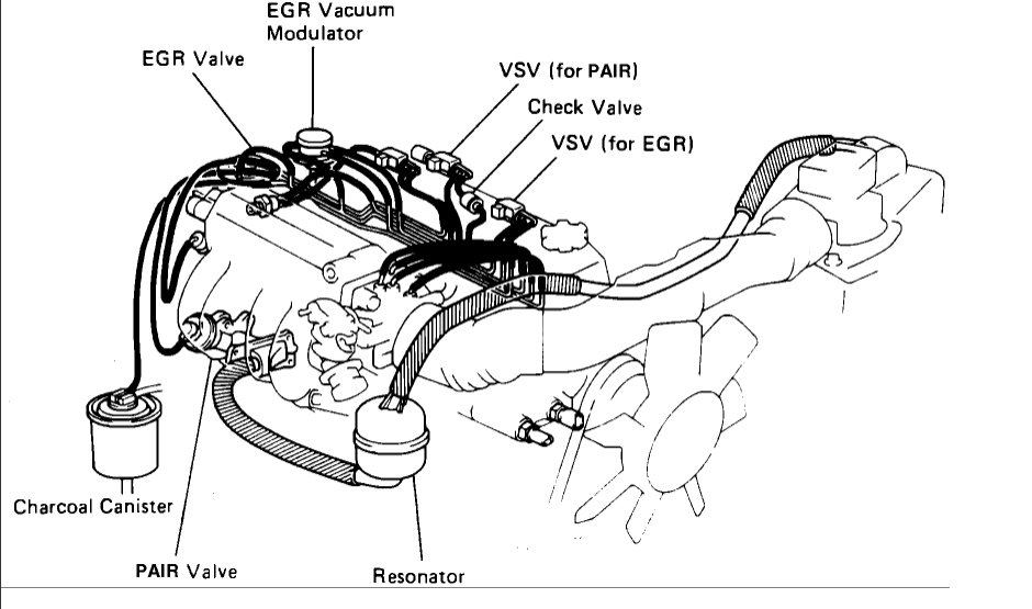

Does anyone know which vacuum hose exactly I need to run my toyota and a diagram
Tuesday, October 31st, 2017 AT 3:08 PM
KEN L
  • MASTER CERTIFIED MECHANIC
  • 55,488 POSTS
Here is both vacuum diagrams so you can see which hose goes where is this is what you needed? (Below)
Wednesday, November 1st, 2017 AT 6:16 PM
