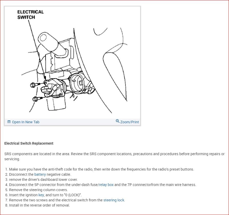

Today, car stalled, I pulled over. Turned key off and car started up. This stalling when on for about eight miles until I got home. After thirty minutes I started car and put in the garage.

There are a number of things that can cause the engine to stall. Namely, a fuel pump issue or spark issue. However, there is another issue that is very common on Honda vehicles and that is the ignition switch itself fails and the car will stall just driving down the road.
Here is a guide that goes through a lot of common items:
https://www.2carpros.com/articles/engine-stalls
Here is the video that will show you about the ignition switch issue:
https://youtu.be/WX9EF0eOrVs
Please let me know if you have more questions or what you find and I will be glad to assist further.
