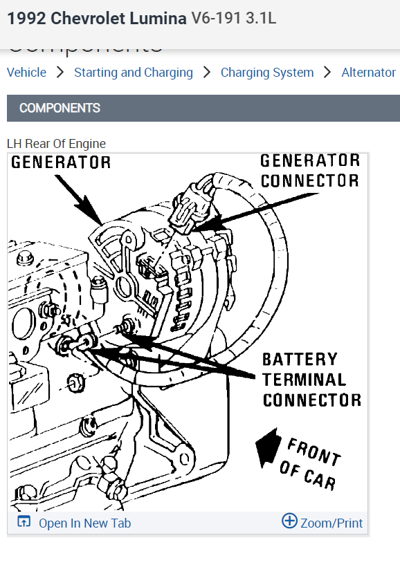

If the battery is weak and not being recharged, that can be the cause of all the problems. Do me a favor. We need to start at square one, so I need to know if the alternator is working. Here is a link that explains how to test it.
The procedure is very simple and only requires a voltmeter or multimeter. Try this and let me know the results.
Let me know what you find.

I checked the alternator. It’s working fine and charging. Positive on alternator was loose. I cleaned the EGR and at first it would stay running at idle. Still stalling when driving and pressing the gas.

If the alternator is not charging or throwing AC voltage it will cause this problem.
Here is a guide to help you test the alternator and instructions on how to change it out:
You can try unplugging the alternator as well to see if the problem goes away. Check out the images (below). Please upload pictures or videos in your response to the problem so we can see what's going on.

Alternator and battery are okay.

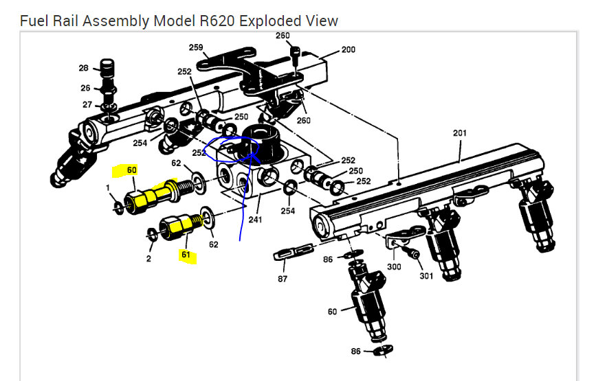

If cylinders 1 and 4 ignition spark is resolved, there is one that stood out to me. You indicated holding the throttle open to make it start. That procedure is to clear a flooded engine.
Have you checked the fuel pressure? If you pull the vacuum hose off the regulator, is there any evidence of fuel in the hose? Also, is there any chance you may have mixed up the inlet and outlet lines at the regulator? See pic below. Number 60 is the inlet and 61 is the outlet.
I have a blue arrow pointing to where the vacuum hose connects. Check that for evidence of fuel. If everything checks good, I suggest checking the fuel pressure.
Let me know your thoughts.
See pic below.

I’ll check for any fuel in that hose. As for mixing the lines up, I made sure to paint mark one of the connections to make sure that didn’t happen. I will check the fuel pressure. I will let you know what I find.
